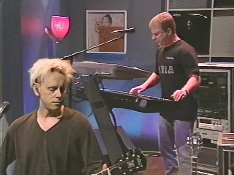

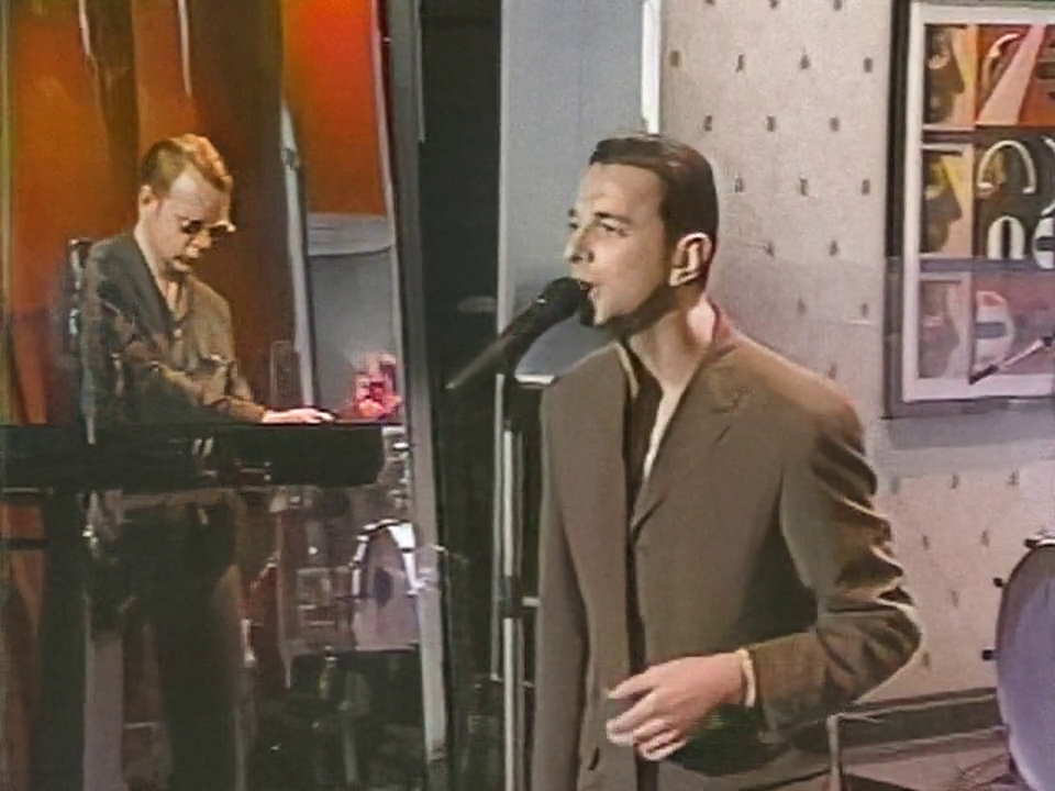

  1. From a video of 2004 of 320x230 at 10,000 fps, I achieved in my opinion a decent quality of visualization (although I may be wrong) but its fps speed prevents that at least you can see well, in these cases what can I do to make the fps speed look better and less stuck to improve its visualization?
    Captures of video "improved if you can say"
    [Attachment 75251 - Click to enlarge]
    [Attachment 75252 - Click to enlarge]
    The only thing I would like is that the frame rate is better so that it looks at least good, but I don't know what to do in these cases.
    I leave an excerpt of the video to get an idea and the video speciations. I can provide the source file if needed

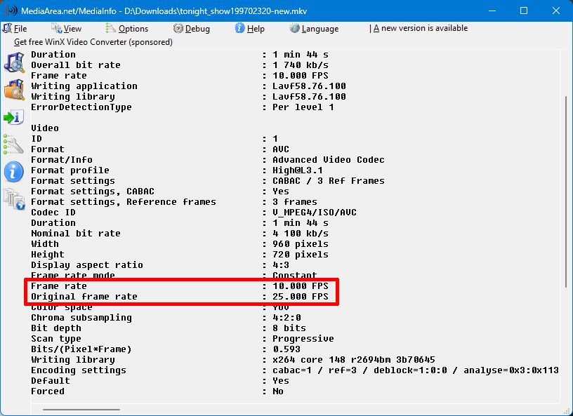

  2. Thats ten frames per second, not 10,000 !
    Interpolation might help.
    Brian.
  3. The original 320x230 video has 25 fps.
    You should correct your upsize workflow and work with the original frame rate.
