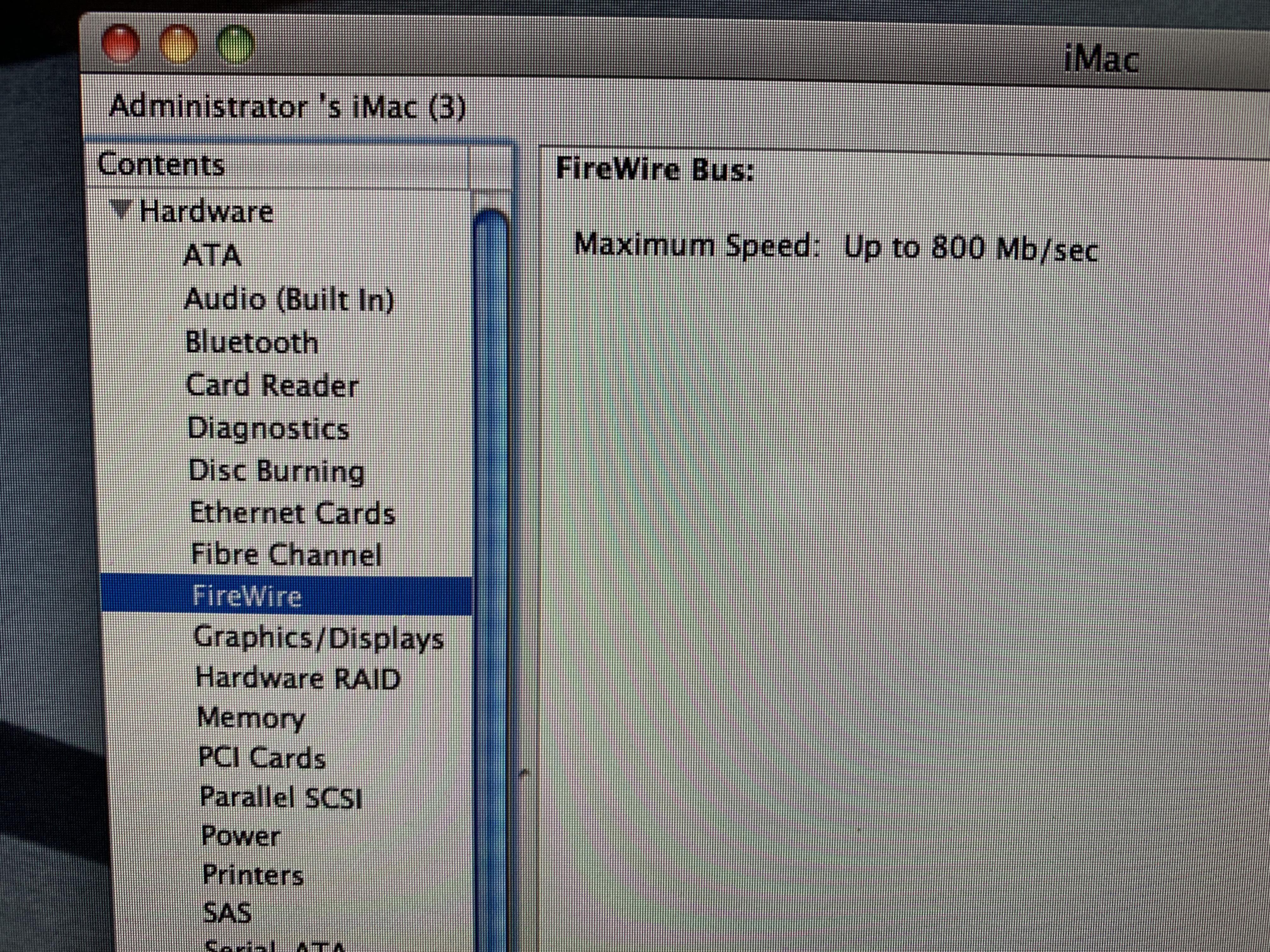

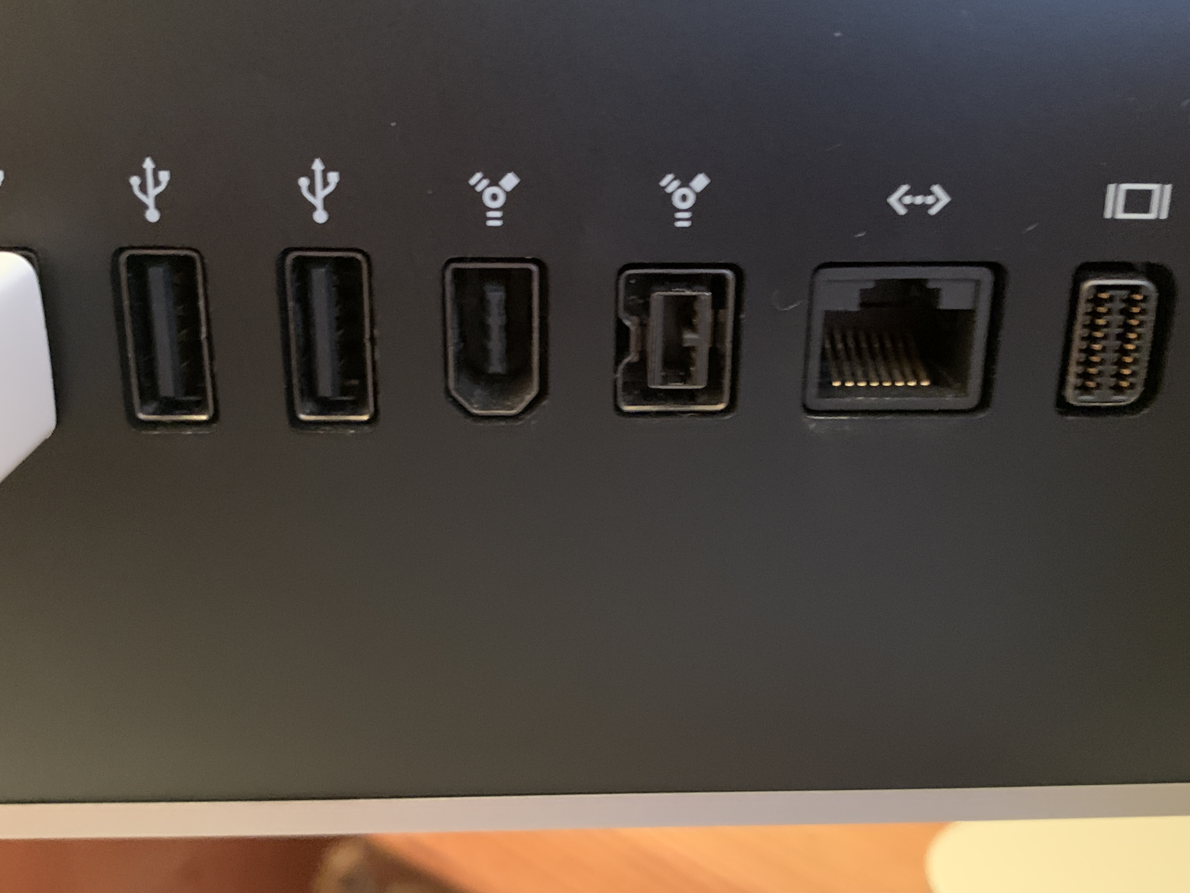

    I am having loads of trouble getting a PCI-e Firewire Card to work, when I decided to take a look at th back of my wife's old 2008 iMac.
    Low and behold it has a Firewire 400 and what I believe is a Firewire 800 port on the back (images attached).

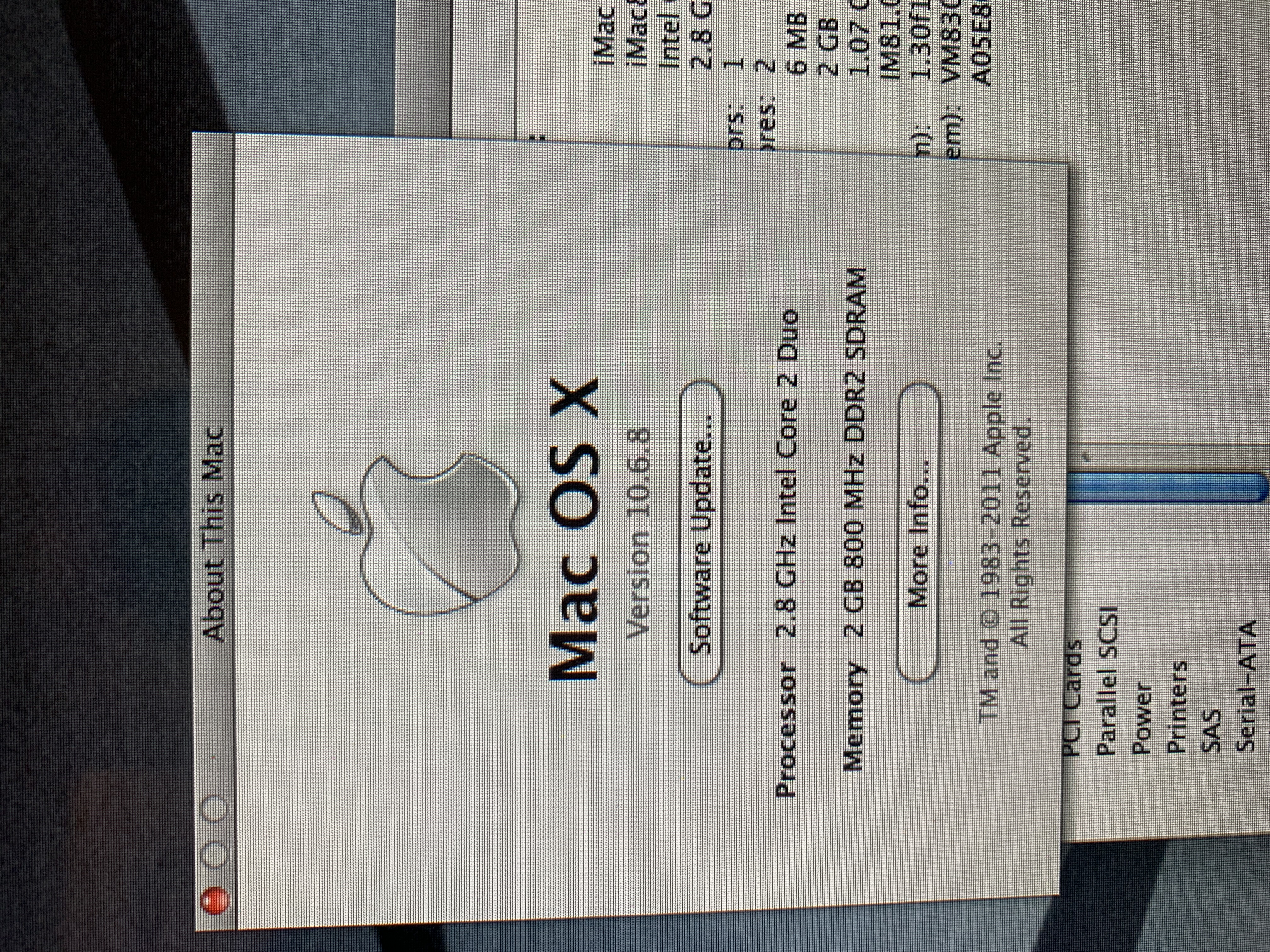

    This is a 2008 model iMac and is not the fastest beast around, but if it was my only option for capturing and coverting video from my Mini DV tapes what are my options.

    1. What cable / connector on the Mac should I use?

    4. What OS version will work? This one is still running 10.6.8 Snow Leopard.
