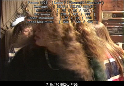

    You should check that you are not crushing the blacks or clipping the whites, i.e. to capture inside the "capturable range" of you card. Because you are using an AIW 9600 the limits are 16-250.
    Your captured sample does not show accumulations at Y=16 nor at Y close to max; the Y levels are always in the range 16-238, so no specific actions is required to change the capture set-up nor the levels in post-processing. Being obsessed you could shrink the levels from 16-238 to 16-235 if a filtering in RGB domain is required later (i.e. color adjustement) or whatever other operation requiring RGB colorspace.
    You can check analitically the levels with this simple script:

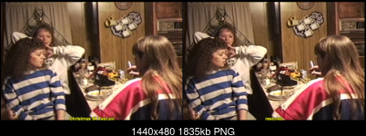

    Outcomes (unfair comparison, source is interlaced, you can try to compare with other deinterlacing methods outside AviSynth):
    Outcomes with image slider: https://imgsli.com/NDMyMzIx
