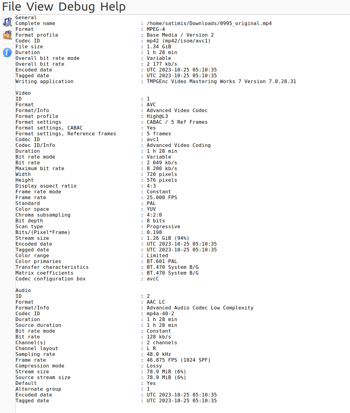

    Another thing that would help analyse the files you got from your shop: an analysis by MediaInfo.
    Install MediaInfo, open one of your MP4s and on the View menu, choose "Text". Copy all that text and paste it here. That'll tell us a lot about the files you've been given.
    Hi Alwyn,
    The screenshots of MediaInfo are attached here
    1)
    The text outcome of the completed video ripped by the profession shop
    2)
    The text outcome of a trimmed section, with unclear picture
    The fonts are very small, not easy to read
    Regards

  12. The full version looks basically ok.
    The 'trimmed' version is a mess:
    - re-encoded rather than just trimmed
    - wrong frame rate (30fps)
    - different (wrong) aspect ratio
    - upscaled, possibly without prior deinterlacing?

    @Satimis, that's good. TMPGenc (which I don't use) would indicate that the shop is at least semi-serious about video conversion. I would use a higher bitrate; 2000kbps is a bit low for my liking. I aim for 4000kbps or CRF 24 in VDub 2 for SD video such as this. That'll give you about 2-2.5GB per hour. If you want to edit it later, even higher bitrates are good.
    I guess the next step is to give us a sample so the experts can assess the quality of the encoding of the MP4s. The numbers from the MediaInfo report are only one side of the story.
    Use AVIDemux to create some sample of the good video.
    The "trimmed" file is a bit of a mess, as pointed out by Sharc, but that's not important at this stage. AVIDemux will do a smart-copy so your files won't be rencoded.

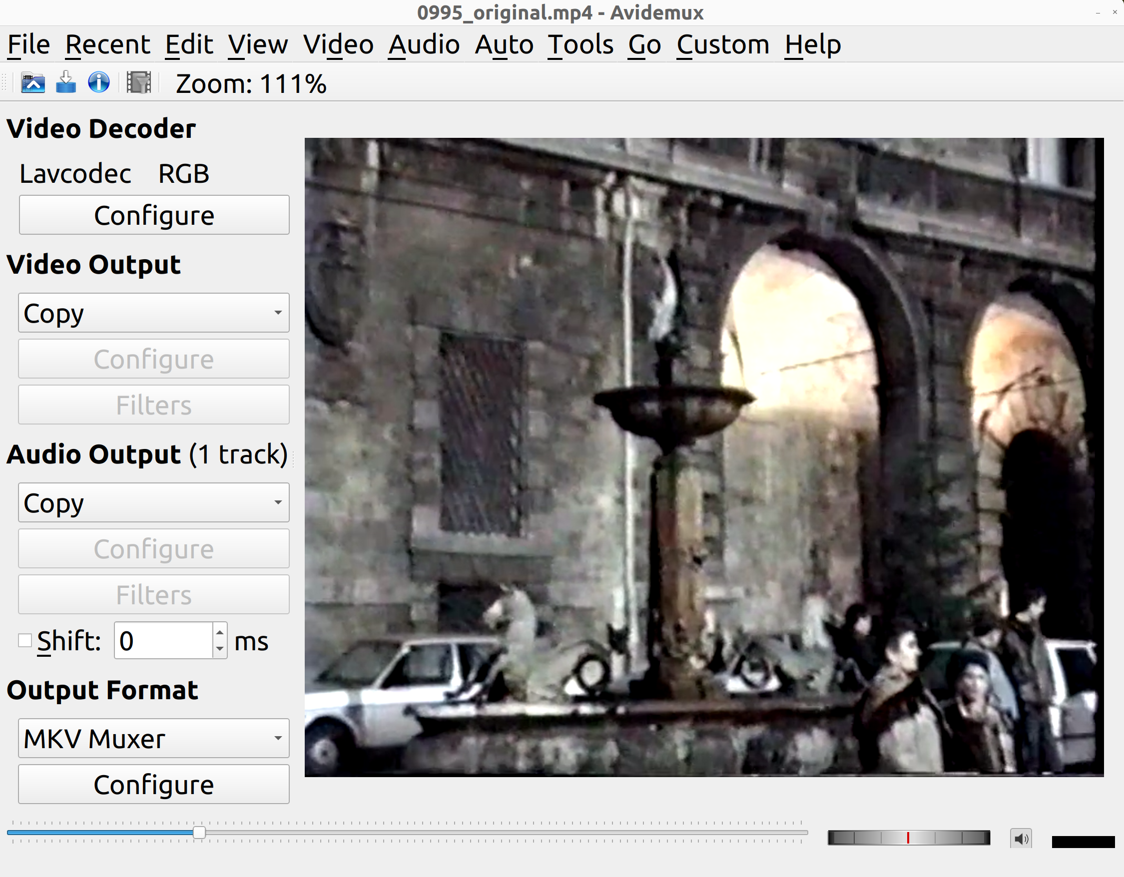

    Hi @Alwyn,
    Thanks for your detailed advice. The described steps sound similar to trimming a section video running OpenShot video editor performed by me previously. The trimmed video needs to be exported(saved).
    Now I have AVIDemux installed, running on Ubuntu 22.04 desktop. (Please see attached screenshot). But I couldn't find A and B buttons. I can't resize AVIDemux desktop.

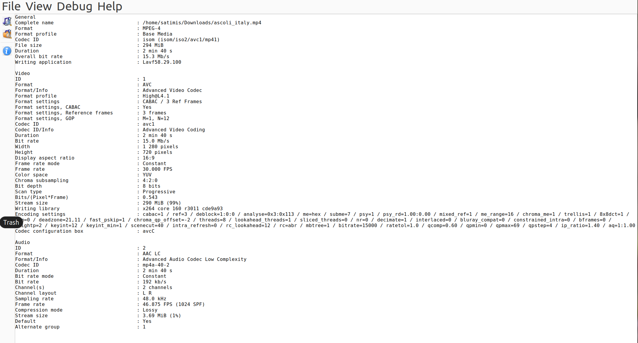

    Then I ran ffmpeg to do the job, trimming the blurry section of the video again.
    Running the original video, ripped by the profession shop, on OpenShot I found the blurry section;
    Starting time: 00:20:05,21
    duration time: 00:02:40 (how long)
    On Terminal run;
    $ ffmpeg -i 0995_original.mp4 -ss 00:20:05 -t 00:2:40 -c:v copy -c:a copy ascoli.mp4
    It took 2 seconds to finish, very convenient, without browsing the original video
    Before I have upload the blurry section to YouTube
    Ascoli, Italy
    https://www.youtube.com/watch?v=rwSR0WX6u1Y
    MediaInfo of the trimmed video
    Please refers to screenshot_mediainfo attached

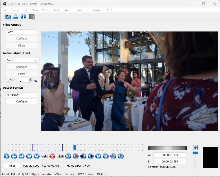

    @Satimis, I don't use Linux, but it looks like your zoom is a bit big. Try View>Zoom 1:4. The Windows version (at Zoom 1:4) looks like this:
    [Attachment 75010 - Click to enlarge]
    The A and B buttons are below the timeline, as you can see. My screen is set up for a Copy Copy MP4 smart-render.
    Make sure you're on the latest version, which is 2.8.1.
    We really need the smart-rendered/copied trimmed piece attached here (or put on a file-sharing service such as Google Drive). YT is no good because YT does a full re-encode on the video and therefore doesn't accurately represent your original.

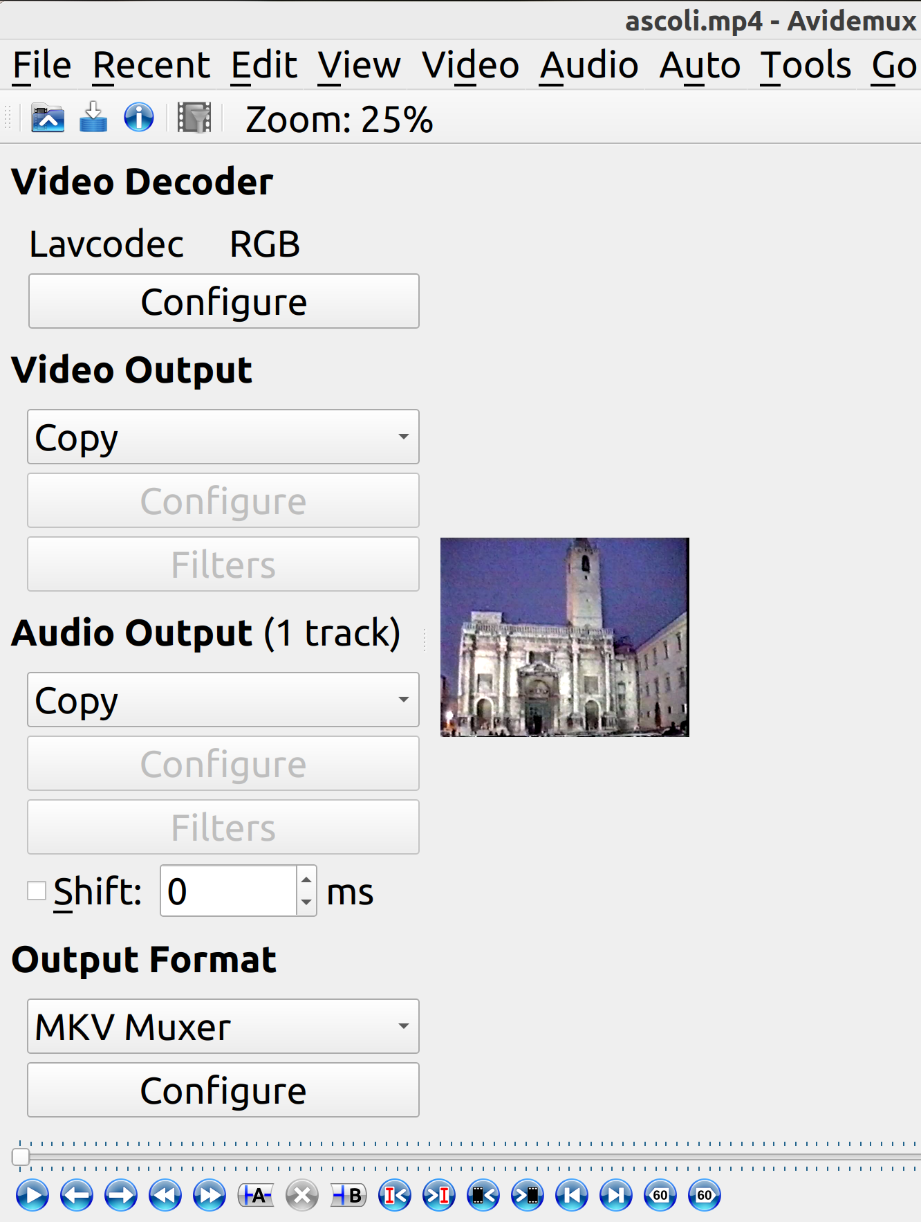

    Hi @Alwyn,
    View -> Zoom: 1:4
    can't help. I must resize the window of Ubuntu 22.04 desktop and then I find it. Please see attached screenshot.
    Version - Avidemux 2.8.1 - Release
    My problem here is uable to resize the window/desktop of AVIDemux.
    The section of the blurry video, trimmed with command, is quite clean without browsing the original video ripped by the profession shop during processing. Can I upload it to my account of Dropbox and share it here?
    Regards

  27. OMG. You don't need to zoom anything. Actually you zoomed by 1/4 = shrinking the preview to 25%.
    Just trim with the A,B buttons for selecting the scene you want to keep, forget about the zoom. Or if you want to enlarge the preview select zoom 2:1.
    Or use the ffmpeg commandline for trimming as you did before if you can't get along with Avidemux on Ubuntu. This also works.
    Yes you do, Sharc. Try it. If my zoom isn't set properly, the A and B control line drops off the bottom of the screen.
    Observe the difference between Satimis' first screen (111%) and their last (25%).
  30. Originally Posted by Alwyn View Post
    Resizing (zooming) the Avidemux window yes, but not the video preview explicitely. Anyway, let's hope for success.
