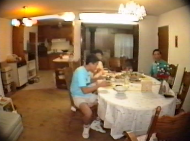

    Hi all,
    Avidemux is completely new to me. Just found it lately on Internet with search.
    I have video which is ripped from VHS tape on DVD, done by a shop of this service. However some parts of the video are not clear, blurry (please refer to attached photo). Please advise how to fix it with Avidemux ?
    I'm running Linux Ubuntu 20.04 desktop.
    Avidemux version - 2.7.8 (Qt 5)
    OR is there any other solution? Thanks in advance
    Regards
    Image Attached Images

    It would be better if you used avidemux to extract a section of the 'blurry' video (use 'copy' for video audio not so important) and upload that as an attachment.
    But I would not raise you hopes in getting a clear picture. The two characters in the background will, IMO, never be totally restored.
    If you have the original vhs then that may be better but the issue could already have been burnt in to the tape at the original transfer stage.
    Could you please advise how to do it?
    The attachment was made as follow;
    1. Play the .VOB file on VLC
    2. Pause the video
    3. Take a screen capture
    I couldn't resolve that not the complete video is blurry, only certain sections on the video. The rest video is quite clear without blurry.
    The VHS tape was ripped from V8 tape. I still have several original V8 tapes on shelves in good condition. Before I took one V8 tape to the shop to rip it on DVD. Unfortunately the shop returned the V8 tape to me, saying the tape unable to turn. Besides the V8 tape was broken by the shop. I hesitate whether to give another V8 tape to the shop to rip it on DVD.
    Is there any way to check whether the V8 tape can be turned/rotated. I don't have V8 player. Also my Sony V8 camera is broken.
    Regards

    The original camera was out of focus. How do you expect to fix that NOW?

    There are clearly 'focus' issues although the foreground chair is in focus. What also concerns me is the face of the male on the right where there top is partially clear and the lower part almost totally blurred out. I also do wonder whether the lights over-exposed the video.
    Do you have a section of the same recording just before this one where everything is in focus - totally sharp ?. If you have may I ask you to do a longer section both with the sharp and the blurry bit.

  13. The file suffers from mpeg2 compression artefacts, best seen as blocks on moving objects (like waving hand). All details are lost. The damage has probably been done when convertig the VHS to DVD. The VHS tape should be properly captured (lossless) rather than converting it on the fly to mpeg2.

  15. A little sharper with an unsharpmask and protection for already sharp edges, noise reduction, deinterlacing, in AviSynth.

    Re-reading again, you now state that the original camera Video8 was transferred to VHS and then the VHS to DVD ?
    I had hoped to see the male sitting at the table before the first sample started. But there is evidence of the camera stopping and restarting.
    The first sequence of the new sample is not that clear either so, as my friend points out, the damage was done during the transfer to DVD. That probably was done rather amateurishly and added a layer of noise from the VHS as well as low bitrate to get all the tape on one DVD disk.
    So do confirm the transfer history. Just Video8 to DVD or Video8 to VHS to DVD. The original Video8 would give you the best picture but did you not say that was broken by the shop ? Another sign of a poor service.
    But whatever you have really does need a new cleaner transfer. Surely there are firms even by mail in your country that do this work ?

    Now I can see that the male is wearing a mask or covering on his face which kinda threw me.

  19. Originally Posted by satimis View Post
    Besides the VHS tape has been played multiple time on TV before its player broken down. There was no blurry problem. However the TV set was X-ray tube model and now it is a digital display.
    The VHS tape was most probably of a better quality than its poor digital DVD conversion which introduced blocking artefacts, blurred the picture even more and lost the details.
    Secondly, old CRT TVs were more forgiving with interlaced VHS sources. With digital high resolution TVs the defects and losses become much more apparent.
    If the VHS is the original source (is it? or what format/medium did your camera produce?), you should re-capture the VHS lossless in a first step, and then encode and filter the capture with a decent encoder, off-line. This should give at least some improvement.
    Hi,
    Thanks for your help. The sharpness of the video on the right is better than the video on the left. Could you please advise how to do it? Thanks

    I think what looks a little like a mask is may just be blocking artifacts from MPEG compression.
    The left side isn't sharpened, just deinterlaced. It's there so you can compare to the right side which is sharpened. I used an AviSynth script for both. The sharpened version was create with this script:
    # My custom UnSharpMask...
    function UnSharpMask(clip v, float radius, float strength)
      blurry = v.BinomialBlur(VarY=radius, VarC=radius, Y=3, U=3, V=3) # or GaussianBlur
      edges = Subtract(v, blurry).ColorYUV(off_y=2).ColorYUV(cont_y=(int(strength*radius*256.0)-256.0))
      Overlay(v, edges.ColorYUV(off_y=-128), mode="Add")
      Overlay(last, edges.Invert().ColorYUV(off_y=-128), mode="Subtract")
      ColorYUV(off_u=-1, off_v=-1) #overlay is causing U and V to increase by 1
    Mpeg2Source("vob4_ab_01.d2v")
    QTGMC(sharpness=0.5)
    SMDegrain (tr=9, thSAD=500, refinemotion=false, contrasharp=false, PreFilter=4, mode=0, truemotion=true, plane=4, chroma=true)
    emask = mt_edge(mode="prewitt", thy1=100, thy2=250).mt_expand().mt_expand().mt_expand().mt_expand().mt_expand().Blur(1.4)
    Overlay(UnsharpMask(2.0, 2.0), last, mask=emask)
    QTGMC() was used first to deinterlace the video. SMDegrain() was used to reduce a lot of the noise (because the later sharpening would greatly increase it) I was aiming at shapening the blurry portions of the picture while avoiding oversharpening the already sharp parts. I used mt_edges() etc. to build a mask of all the sharp edges in the source. A sharpened version of the video was created with UnSharpMask(). Overlay() was used to replace the areas that were not sharp in the original video with the sharpened video.
    Regarding your Video8 to VHS to DVD process: it's terrible. You should go back to the original Video8 tapes if you still have them. Use a DVD recorder with a line time base corrector to clean the video (don't record to DVD, don't apply any other filters, just pass the signal through the recorder for time base correction) and capture uncompessed YUY2 of YV12 video on the computer. You'll get much better results that way - more detail, less noise, and sharper picture. You may not even need to sharpen in post.
    <oops>
    I just checked the script I used for the side-by-side video -- the left side is deinteralaced with QTGMC and denoised with SMDegrain(). The right side is further sharpened as described.
    </oops>

  30. Member Cornucopia's Avatar
    Assuming good remaining tapes & equipment, all else being equal...
    V8 --> computer file
    Is better than
    V8 --> VHS --> computer file
    which is better than
    V8 --> VHS --> DVD --> computer file
    And lossless computer file
    Is better than
    lossy (standard) computer file.
    Go back to the source! Simplest straight wire approach is least damaging. Only device that should go in the middle would be a TBC when necessary.
