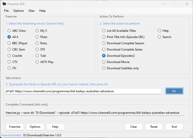

    I've been super impressed by the work of @stabbedbybrick with the awesome Freevine app. Being an old school VB coder from way back, I started playing around with making myself a GUI, basically to overcome my laziness in having to type out all these long commands every time.
    Since Freevine v1.0.0 was released last week, I looked a bit more seriously at tidying up my code and making it work with the new version. Then thought about the possibility of releasing it for others to have a play with too.
    So here we are. FreevineGUI v0.1.0 is now available at https://github.com/billybanana80/FreevineGUI
    [Attachment 74875 - Click to enlarge]
    [Attachment 74876 - Click to enlarge]
    [Attachment 74877 - Click to enlarge]
    Note: all the usual requirements for Freevine are exactly the same. This GUI just essentially kicks off the Command Prompt for you.
    It is Windows only and requires .NET 6.0 Desktop Runtime
    Have fun and let me know what you think.

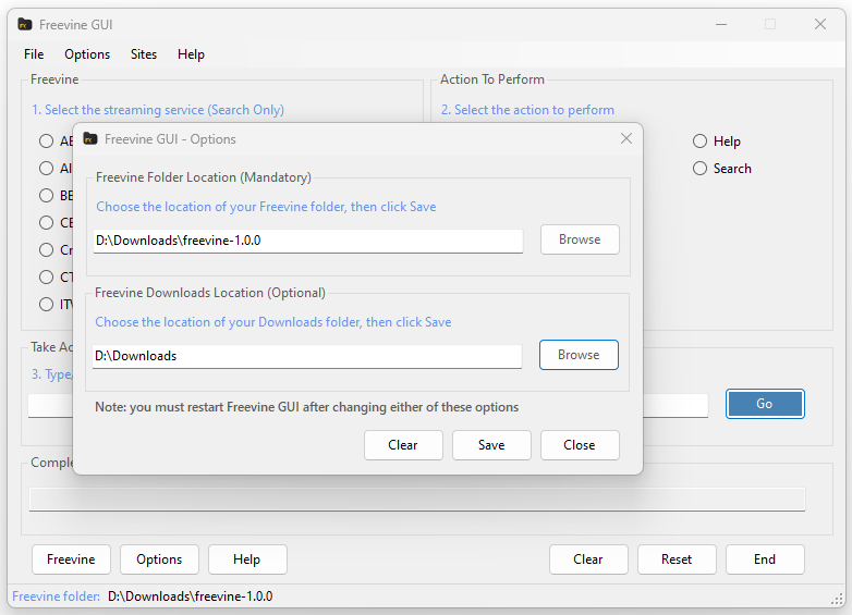

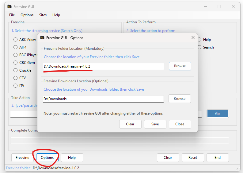

    [Attachment 74931 - Click to enlarge]
    Then in freevineGUI go to Options and choose the freevine-1.0.02 folder as your Freevine Folder Location and Save it.
    [Attachment 74932 - Click to enlarge]
    You also need to create your L3 CDM in order to decrypt videos. That's the tricky part for you if you don't get alot of this stuff I'm afraid. This is all pre-requisite stuff to get any of this to work. it's nothing specific to freevineGUI. Good luck !

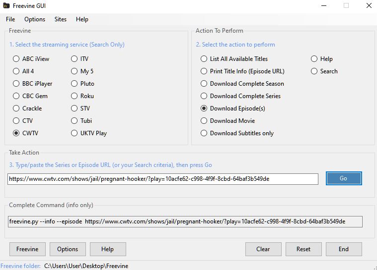

  22. Got a question that is probably just user error. I wanted to download Jail S06E03 from CWTV. I got S01E01. Any idea what settings I have wrong? The URL is correct for that episode.

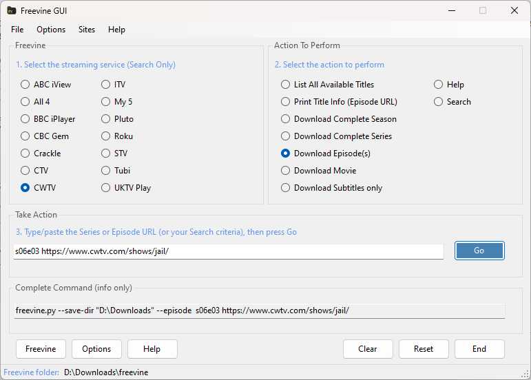

    I tend to use the main series URL and the season/episode numbers for best results. In this case:
    s06e03 https://www.cwtv.com/shows/jail/ works fine.
    [Attachment 75131 - Click to enlarge]
    If using the direct episode URL you still need to specify the season/episode number ie:
    s06e03 https://www.cwtv.com/shows/jail/pregnant-hooker/?play=10acfe62-c998-4f9f-8cbd-64baf3b549de
    This change from freevine >1.0.0 from memory.

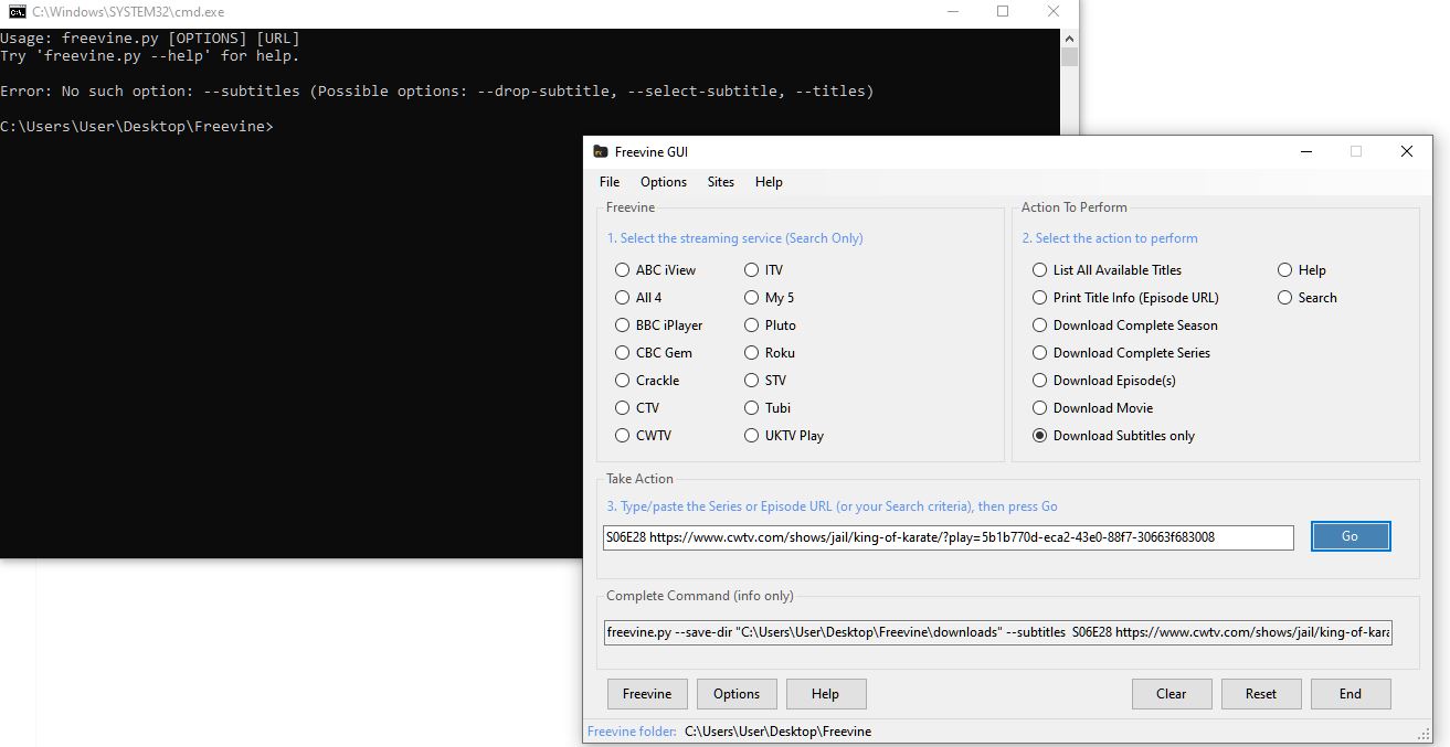

  25. Did I do something wrong when trying to download just a subtitle?
    [Attachment 75137 - Click to enlarge]
  26. Member
    Oct 2023
    Afghanistan
    Yes my bad. I have the incorrect command there. Should be " --sub-only". Will fix and update later today.

    I've fixed the issue with download subtitles only and also modified some code to change the order in which the saved downloads folder path is passed through to the command prompt. It means the subs are saved in the same downloads directory where required.
