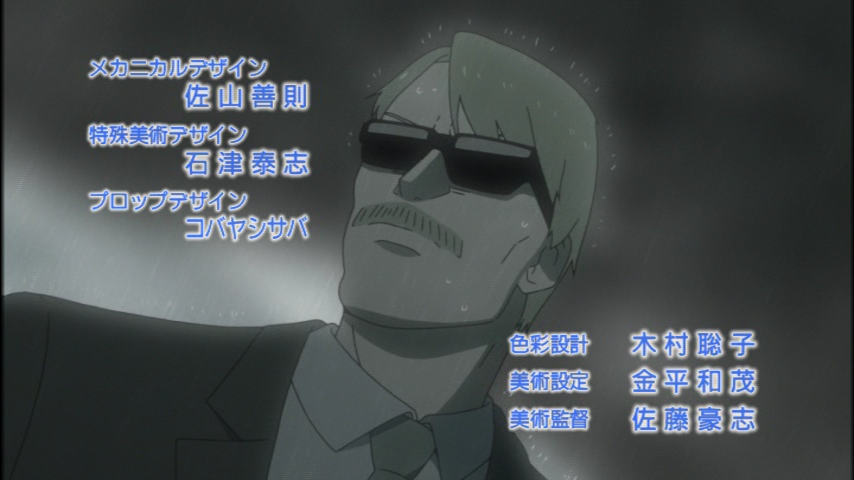

	I performed this before and I still get problems. I use the credits as a point of reference, the bright white outline of the names are interlaced, despite the content in the background (constant panning) being perfectly fine. When you preview TIVTC around frame 4367, you'll see the rain drops and the title credits being combed.
 [Attachment 74764 - Click to enlarge]
 [Attachment 74765 - Click to enlarge]
	Credit fade overlays are added after the main content was produced .
 You can add vinverse to treat residual combing without damaging picture too much. You can combine it with TFM pp modes or deactivate pp
 You can filter the credits differently if you want, divide up into sections to prevent slightly blurring by vinverse on the main sections, it depends on how picky you are
	You're opening a huge can of worms.
 In the shot you referenced the background is telecined film (2:3 pulldown) but the titles are overlaid as fully interlaced video -- the fade with each field. You can keep the smooth fades by using a good double frame rate deinterlacer (QTGMC) but the background will have 3:2 repeats. Or you can IVTC to 23.976 fps and have the titles fade less smoothly.
