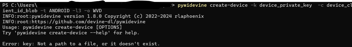

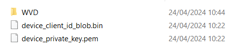

  2. Afternoon all. I've battled on and fully gone step-by-step as best I can. I have both device_private_key and device_client_id_blob via the excellent cedric guide. No apparant issues with that. I just can't for the life of me get the "pywidevine create-device -k device_private_key -c device_client_id_blob -t ANDROID -l3 -o WVD" step to work. I'm forever getting "Error: key: Not a path to a file, or it doesn't exist."
    I have tried all examples (including the basic folderA / folderB and still get the same result).
    [Attachment 78583 - Click to enlarge]
    [Attachment 78584 - Click to enlarge]
    The WVD directory is created. I'm running the command from the folder containg the x2 files (not WVD). Regardless of (env) or any type of attempt I get hit with the same error. Any ideas.
    Thanks all, sorry it's that question again !!
  3. Originally Posted by F1sav28 View Post
    Since your files have extension you need to add them to your command:
    pywidevine create-device -k device_private_key.pem -c device_client_id_blob.bin -t ANDROID -l3 -o WVD
    When those files are dumped they don't have any extension, so I guess you manually added those but still ran the standard command, hence the error.
  4. No way !!
    I barely ever have extensions visable, but needed to see some hidden things so only turned them on this morning, whilst I attempted this. First run after reading your obvious answer and I have a WVD file.
    Many thanks, sometimes it's right in front of you eh!
    Cheers

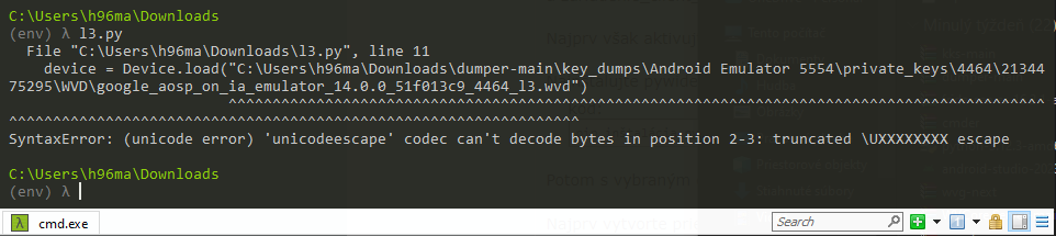

  7. Originally Posted by ivanko362 View Post
    Use a raw string instead:
    Device.load(r"C:\Users...

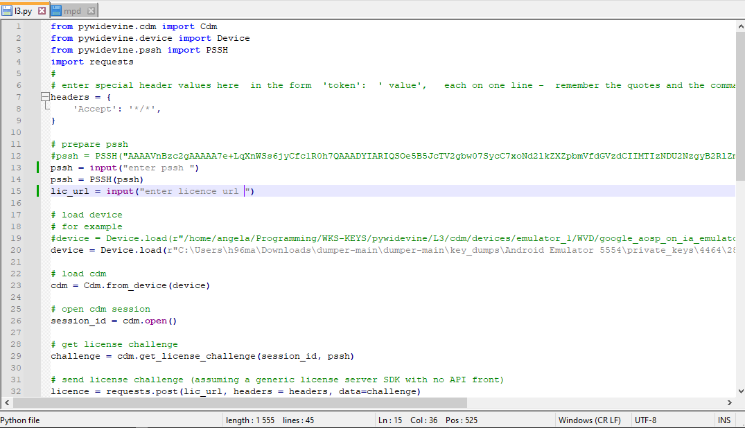

  9. Originally Posted by ivanko362 View Post
    I am helpless
    https://www.youtube.com/watch?v=pLvS8bOCR6g
    C:\Users\h96ma\Downloads
    λ l3.py
    AAAAOHBzc2gAAAAA7e+LqXnWSs6jyCfc1R0h7QAAABgSEB27IdjcUyOzN/LrJaGmbXtI49yVmwY=
      File "C:\Users\h96ma\Downloads\l3.py", line 14, in <module>
        pssh = PSSH(pssh)
      File "C:\Users\h96ma\AppData\Local\Programs\Python\Python312\Lib\site-packages\pywidevine\pssh.py", line 67, in __init__
        raise ValueError("Data must not be empty.")
    ValueError: Data must not be empty.
    Only change CDM path in that script with your CDM path and once you execute script you need to feed PSSH and LIC URL Manually to script via input in terminal like this. If everything is right, then keys will be printed on screen.
    May 2024
    slovakia

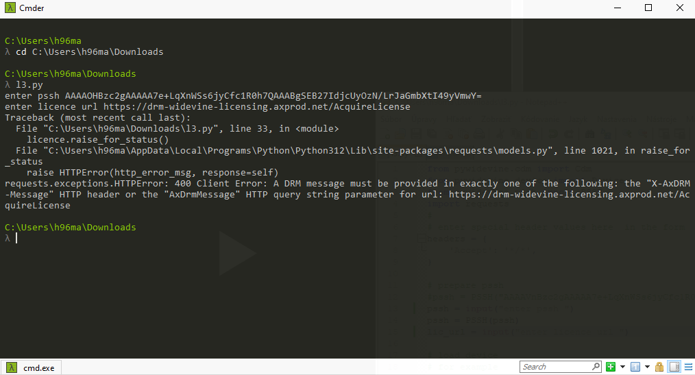

    next error
    [Attachment 78946 - Click to enlarge]
    [Attachment 78947 - Click to enlarge]
    λ l3.py
    enter pssh AAAAOHBzc2gAAAAA7e+LqXnWSs6jyCfc1R0h7QAAABgSEB27IdjcUyOzN/LrJaGmbXtI49yVmwY=
    enter licence url https://drm-widevine-licensing.axprod.net/AcquireLicense
      File "C:\Users\h96ma\Downloads\l3.py", line 33, in <module>
        licence.raise_for_status()
      File "C:\Users\h96ma\AppData\Local\Programs\Python\Python312\Lib\site-packages\requests\models.py", line 1021, in raise_for_status
        raise HTTPError(http_error_msg, response=self)
    requests.exceptions.HTTPError: 400 Client Error: A DRM message must be provided in exactly one of the following: the "X-AxDRM-Message" HTTP header or the "AxDrmMessage" HTTP query string parameter for url: https://drm-widevine-licensing.axprod.net/AcquireLicense
  11. Originally Posted by ivanko362 View Post
    next error
    λ l3.py

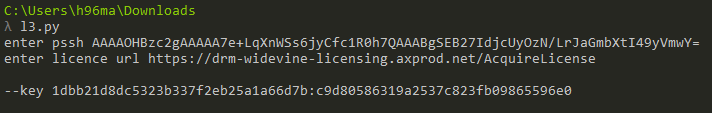

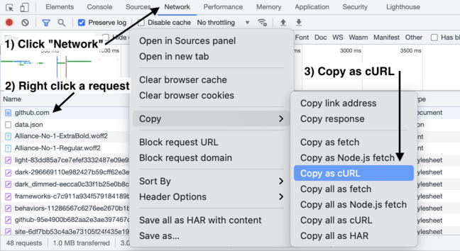

    Your license server needs additional header payload data in order to obtain keys.
    1. Reload video again
    2. Go to inspect > network and find Licence url by typing lic in search box
    3. In your case your licence url is this : https://drm-widevine-licensing.axprod.net/AcquireLicense
    4. Right click on it. Find copy > copy as cURL(bash) - as shown in image
    [Attachment 79359 - Click to enlarge]
    5. go to curlconverter.com and paste data in that text box
    6. After you paste the data in the text box, a result will be generated below that text box.
    7. Copy and paste that data in your script's header section.
    headers = {
    8. Keys will appear on the screen once you run the script again if everything is okay.
    Last edited by LittleSoldier; 25th May 2024 at 23:02. Reason: Added Screenshot for more easy understanding

    Now you need an l3.py to use for simple keys
    PHP Code:
    from pywidevine.cdm import Cdm
    from pywidevine
    .device import Device
    from pywidevine
    .pssh import PSSH
    import requests
    # enter special header values here  in the form  'token':  ' value',   each on one line -  remember the quotes and the comma!
    headers = {
    'Accept''*/*',
    # prepare pssh
    #pssh = PSSH("AAAAVnBzc2gAAAAA7e+LqXnWSs6jyCfc1R0h7QAAADYIARIQSOe5B5JcTV2gbw07SycC7xoNd2lkZXZpbmVfdGVzdCIIMTIzNDU2NzgyB2RlZmF1bHQ=")
    pssh input("PSSH? ")
    pssh PSSH(pssh)
    lic_url input("License URL? ")
    # load device
    # for example
    #device = Device.load(r"/home/angela/Programming/WKS-KEYS/pywidevine/L3/cdm/devices/emulator_1/WVD/google_aosp_on_ia_emulator_14.0.0_xxxxxc_4464_l3.wvd")
    device Device.load(r"<enter your path to the wvd file you have created, here>")
    # load cdm
    cdm Cdm.from_device(device)
    # open cdm session
    session_id cdm.open()
    # get license challenge
    challenge cdm.get_license_challenge(session_idpssh)
    # send license challenge (assuming a generic license server SDK with no API front)
    licence requests.post(lic_urlheaders headersdata=challenge)
    # parse license challenge
    cdm.parse_license(session_idlicence.content)
    # print keys
    for key in cdm.get_keys(session_id):
        if
    key.type=='CONTENT':
            print(
    f"\n--key {key.kid.hex}:{key.key.hex()}")
    # close session, disposes of session data
    cdm.close(session_id
    [edit] I forgot to mention that you can now rename the wvd file created to something easier to type and you can copy it to anywhere in the system. The file contains data about your key and blob's location so be sure to never move your key and blob unless you want to do this process all over again. [/edit]
    I plan moving away from WKS-KEYS in future script releases.
