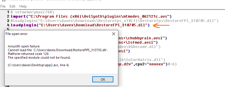

    Mpeg2source can only open d2v index files created by DGIndex (which can index m2v/mpg/vob, etc.)
    No surprise it didn't work
    Error code 126 is a general error usually related to a dependency issue one way or another.
    Try AvsMeter on your plugins library to see if it finds any errors -
    Since I can't read the error in your image due to the language, I'm only guessing
    The error message in Portuguese says ''Could not find the specified module''
    To run ''AvsMeter'' do I need to run it in PowerShell?
    No, use the regular command prompt
    EDIT - I was able to reproduce your 126 error by having either bad path or the dll name.
    Check it carefully. Here in this example, I made the path with a deliberate error:
    (the dll had the right name)

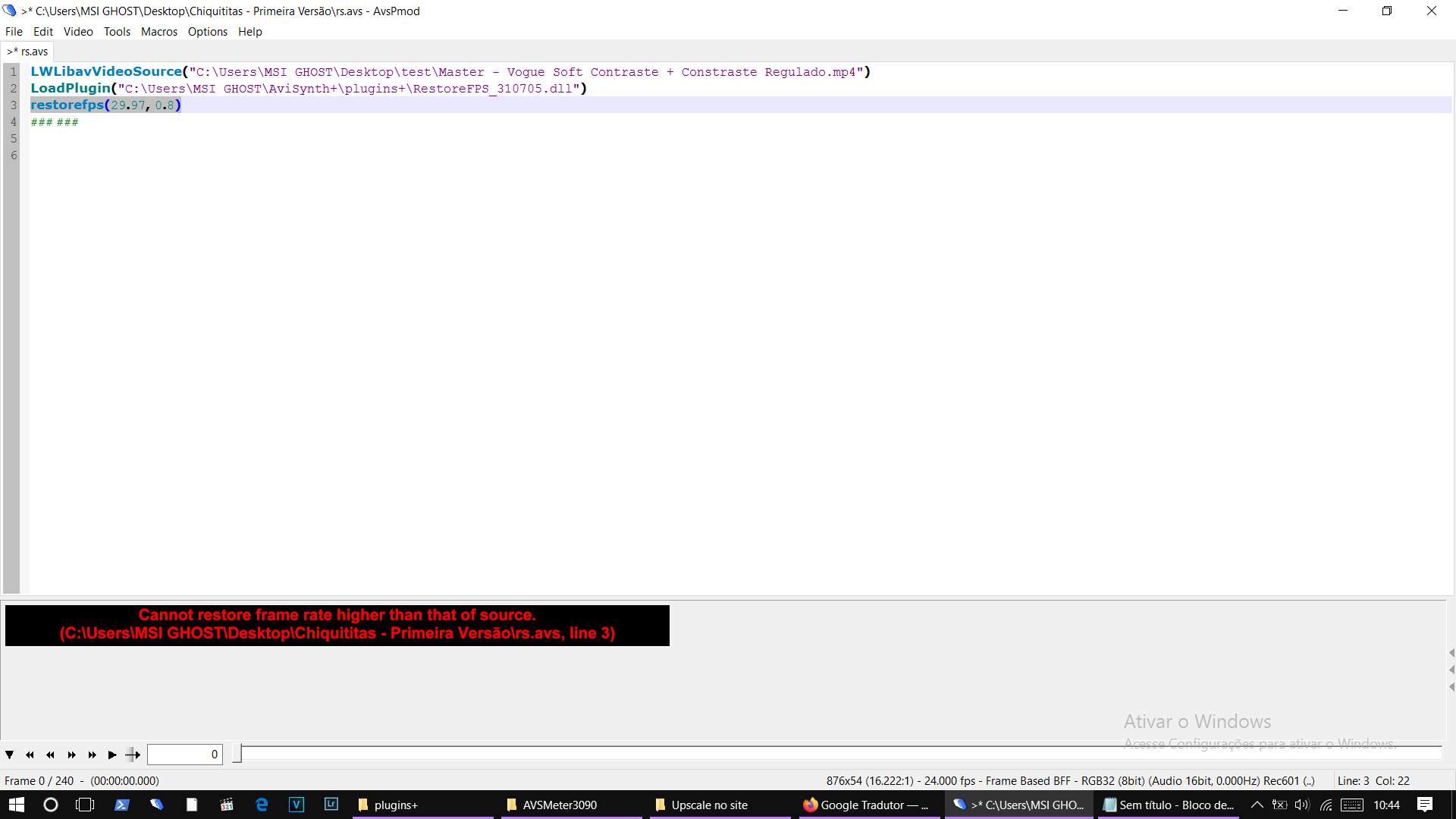

    Ok, I added the plugin path and I believe it worked, but in the ''restorefps'' phase, it showed me this error:

    Yes, it assumes "convertFPS" was at one time previously used in the past to increase the frame rate,
    so for RestoreFPS, you have to provide the original frame rate (which must be less than it is now)

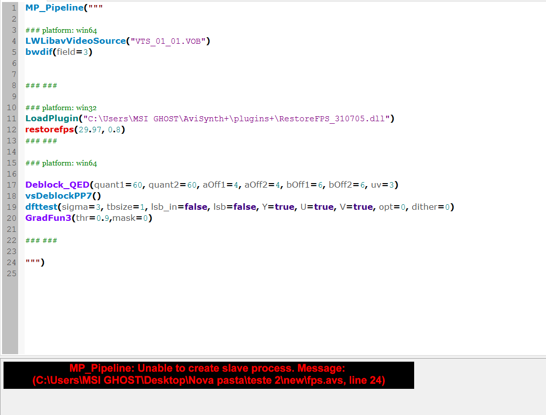

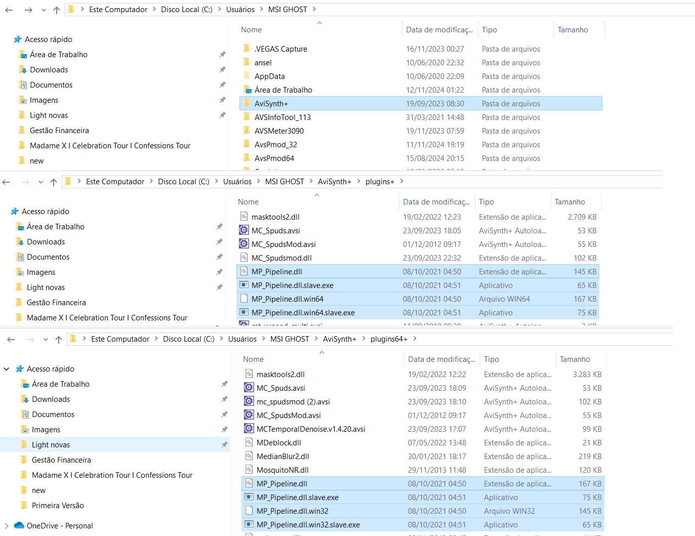

    Hi friend, surprisingly, I'm trying to restore this same file, but I can't run your script. I have
    ''AviSynthPlus 3.7.3'' installed, and I have ''MP_Pipeline.dll'' in the plugin folders, but I know little about the software and I can't find a way to run the 32-bit version to execute the ''restorefps'' phase.
    When I open AvsPmod and try to run MP_Pipeline, I get this error in the print below.
    Could you help me with what I might be doing wrong?
    Mar 2008
    Post your complete script

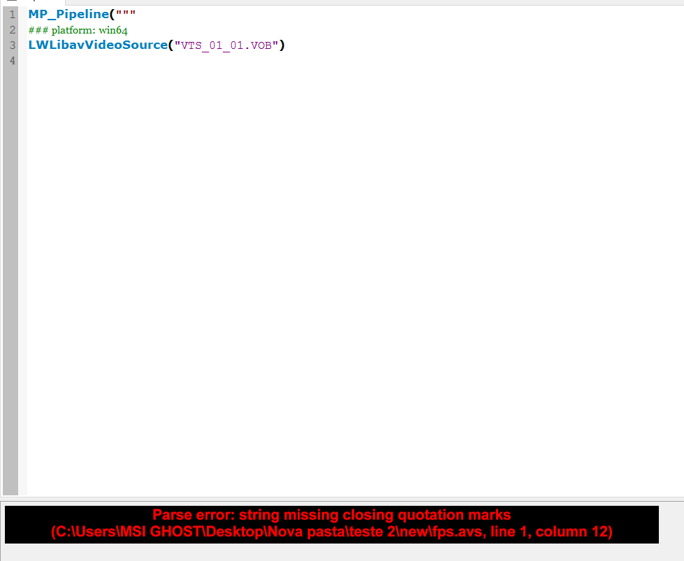

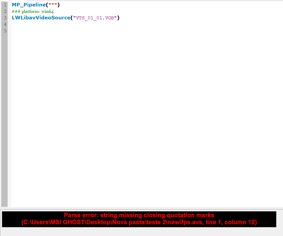

  12. Originally Posted by Roberto.marinho View Post
    The error is saying that you have open parentheses, but no closed
    You have this
    MP_Pipeline("""
    #script
    But it should be this
    MP_Pipeline("""
    #script
    ie. you're missing the closing """)

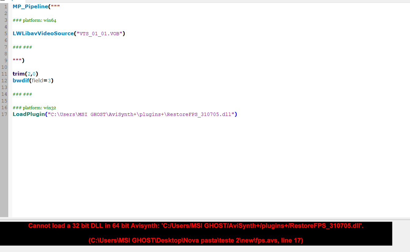

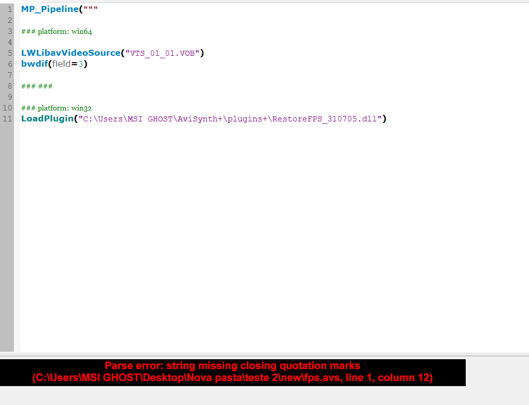

  13. Originally Posted by poisondeathray View Post
    You have this
    MP_Pipeline("""
    #script
    MP_Pipeline("""
    #script
    The error still persists...

  14. Originally Posted by davexnet View Post
    Sorry, I don't understand.
    I want to run the expert's script ''poisondeathray'' from post #19, but I get errors from the start of the desired script
    Mar 2008
    Did you try poisondeathray's advice?
  16. Originally Posted by davexnet View Post
    About closing the parenthesis? I tried but the error still persists
  17. Originally Posted by Roberto.marinho View Post
    It's the wrong syntax. You need the splitter ### ### and the """ on both ends . You need to run the script within the mp_pipeline. Inbetween both """ and """
    A basic source filter only script with mp_pipeline loading the video in x64 avs would look like
    MP_Pipeline("""
    ### platform: win64
    LWLibavVideoSource("PATH\YourVideo.ext")
    There are examples in the documentation as well
    (It would be so much easier and faster if someone would compile x64 versions of old plugins like restorefps)

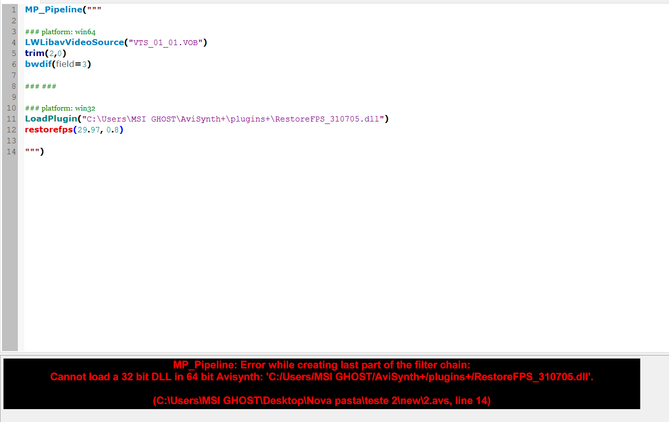

  18. Originally Posted by poisondeathray View Post
    MP_Pipeline("""
    ### platform: win64
    You were right.

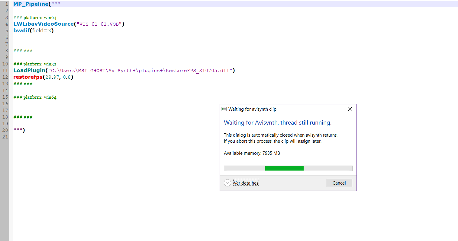

    I managed to get to this stage, I added the path to the plugin ''RestoreFPS'' and I get this error
    I believe it is because I am using the 64-bit version, but how do I run the 32-bit version for this phase of ''RestoreFPS''?

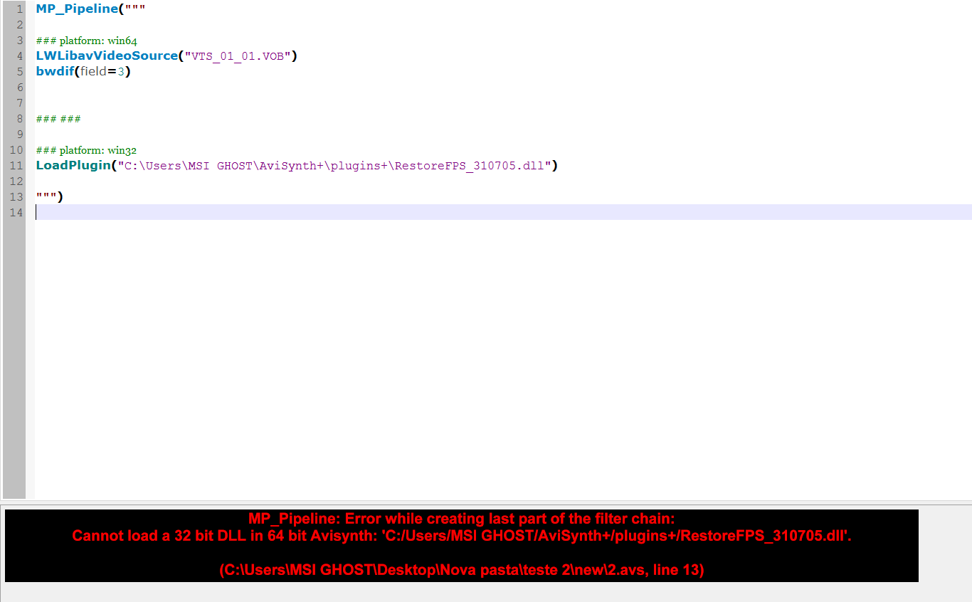

  19. Originally Posted by Roberto.marinho View Post
    Do not close the mp_pipeline """) until the end of the script . Right now you're loading restorefps in x64 because mp_pipeline is closed. Move """) to the end of the script
    Look at the example in the original post. Just follow that syntax
  20. Originally Posted by poisondeathray View Post
    Ah ok,
    I removed the closing to add it at the end, but it's giving me the same syntax error as at the beginning

  21. It tells you what the error is - you're missing the end """) . You never added it back
  22. Originally Posted by poisondeathray View Post
    I searched on Google for a solution to this error but I didn't find it
  23. You loaded the plugin , but you need to call the filter to use it . Such as
    restorefps(29.97, 0.8)
    If it's exactly the same source, the trim value should be the same, otherwise you might have to adjust it
    MP_Pipeline("""
    ### platform: win64
    trim(2,0)
    bwdif(field=3)
    ### platform: win32
    LoadPlugin("PATH\RestoreFPS.dll")
    ### platform: win64
    #add any x64 filters here

    Unfortunately I can't proceed from the ''restorefps'' phase
  25. Look at post 53
    You are missing ### ### to close off the win32 section
    Just copy/paste it and change the paths to your video and plugin location
  26. Originally Posted by poisondeathray View Post
    Look at post 53
    I added my preferred filters in version 64, but the error in the ''restorefps'' phase always persists
  27. Do you get error message if you comment out or delete the 4 filters? If not, start add them back 1 by 1 to debug which filter is the problem
  28. Originally Posted by poisondeathray View Post
    I deleted the 4 filters to test, but when it asks to process, it doesn't leave the loading screen, it's been loading for 10 minutes. Is this normal?
  29. Originally Posted by Roberto.marinho View Post
    Not normal
    What AVS versions ?
    Confirm that you have both avisynth x64 and x86 installed and that you're using the most recent mp_pipeline version .
    https://github.com/pinterf/MP_Pipeline/releases
    Did you do this as per the mp_pipeline README? There should be 4+4=8 files
    Copy files from x86 (or x86_xp) folder to the plugins directory for 32 bits plugins
    Copy files from x64 (or x64_xp) folder to the plugins directory for 64 bits plugins

    Good morning.
    The ''AviSynth+'' version has 2 versions installed ''32 and 64 bits'', right? If so, this would be the version I have installed.
    About the ''mp_pipeline'' version, it is the most recent version ''MP_Pipeline v0.23'', I downloaded it again and added it to the respective folders. Here are the pictures
    I tried to change the ''RestoreFPS'' plugin, I changed it to the 3 available in the folder, which are: ''RestoreFPS.dll'', ''RestoreFPS_310705.dll'', ''RestoreFPS_old.dll'', but again I face the same error, it only executes the loading but does not finish.
