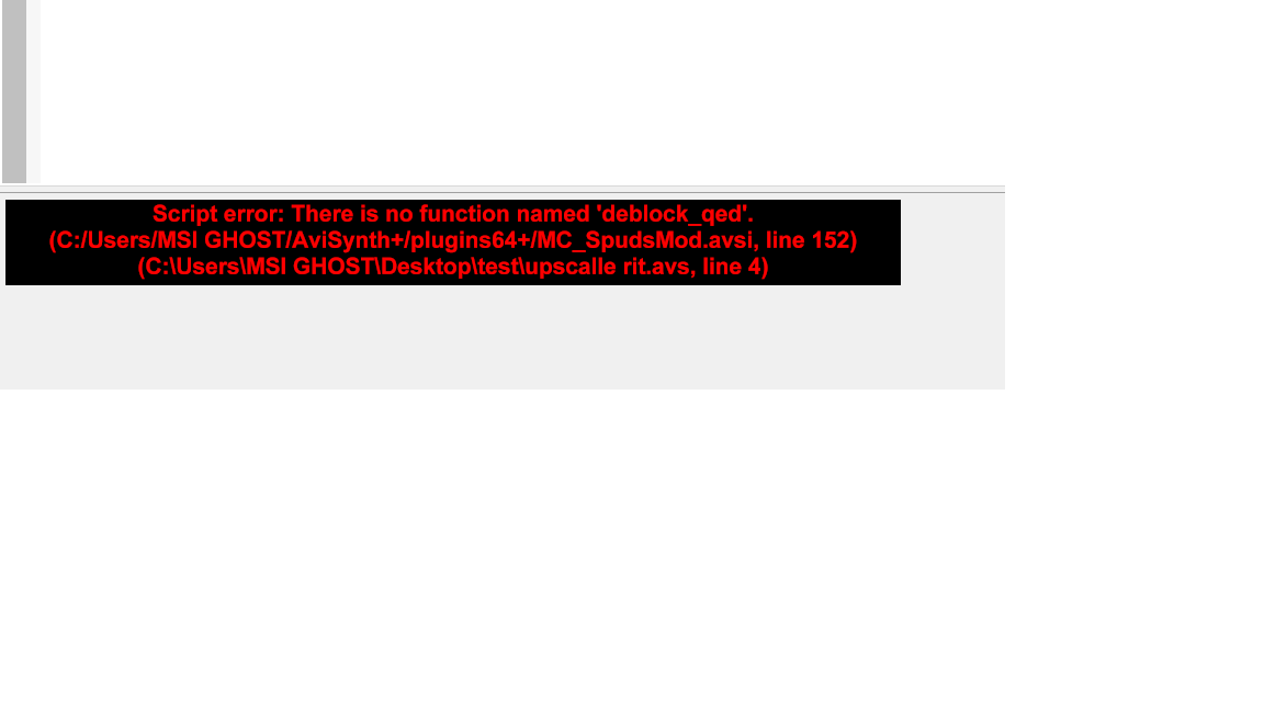

    I was racking my brain haha, thank you very much.
    It just gave an error in the filter (mc_spudsmod) with the message ''there is no function called 'deblock_qed'''
    I looked for the error on Google, but I can't find a solution
    If you know any solution I would be very grateful and I won't bother you anymore lol
    Mar 2008
    Look for, download and add to the Avisynth plugin folder(s)
    .dll and .avsi (scripts) will load automatically if placed in the proper place,
    Otherwise you load them using Loadplugin or import respectively

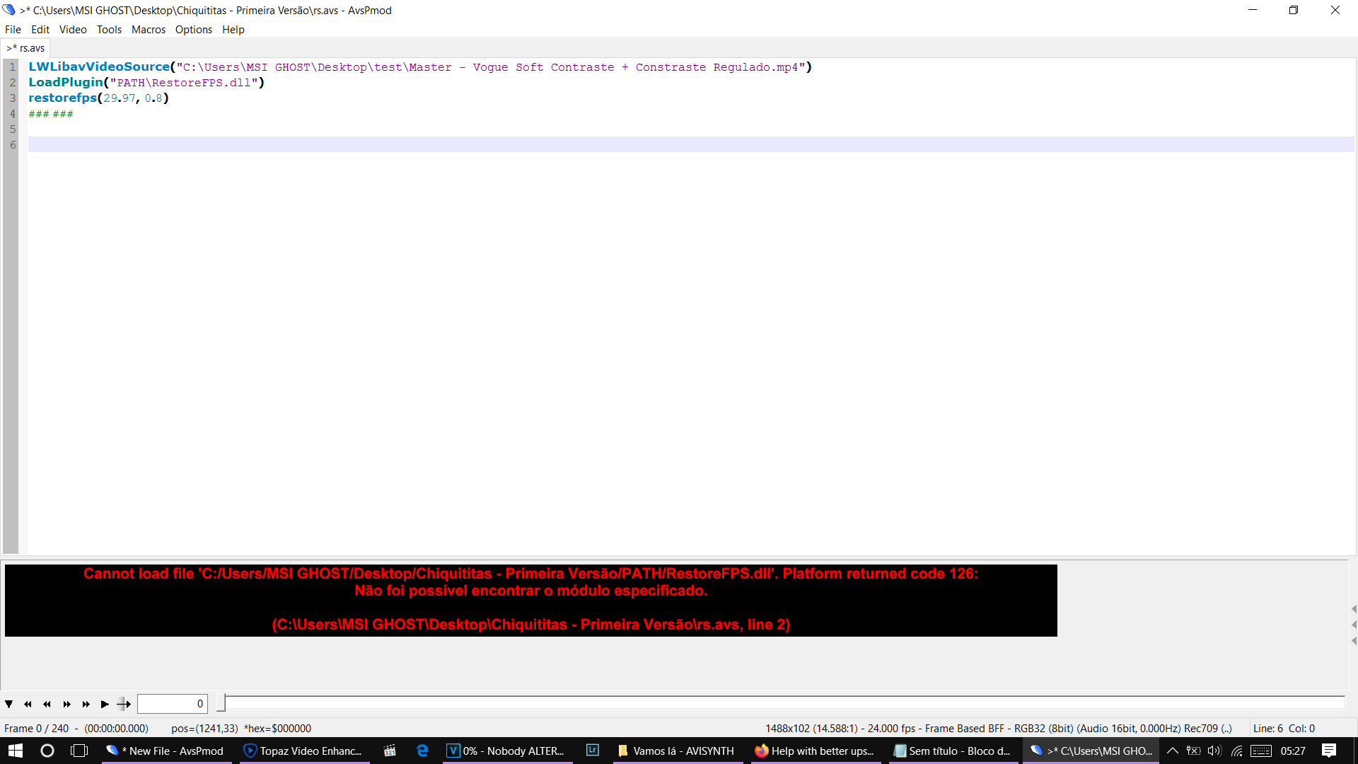

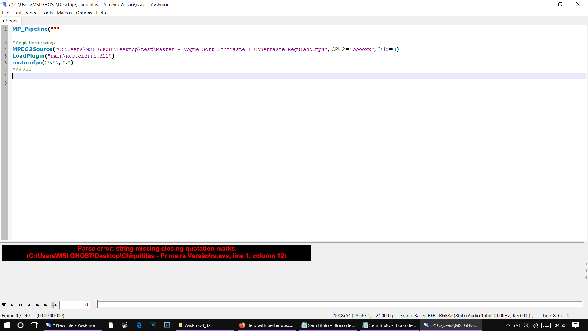

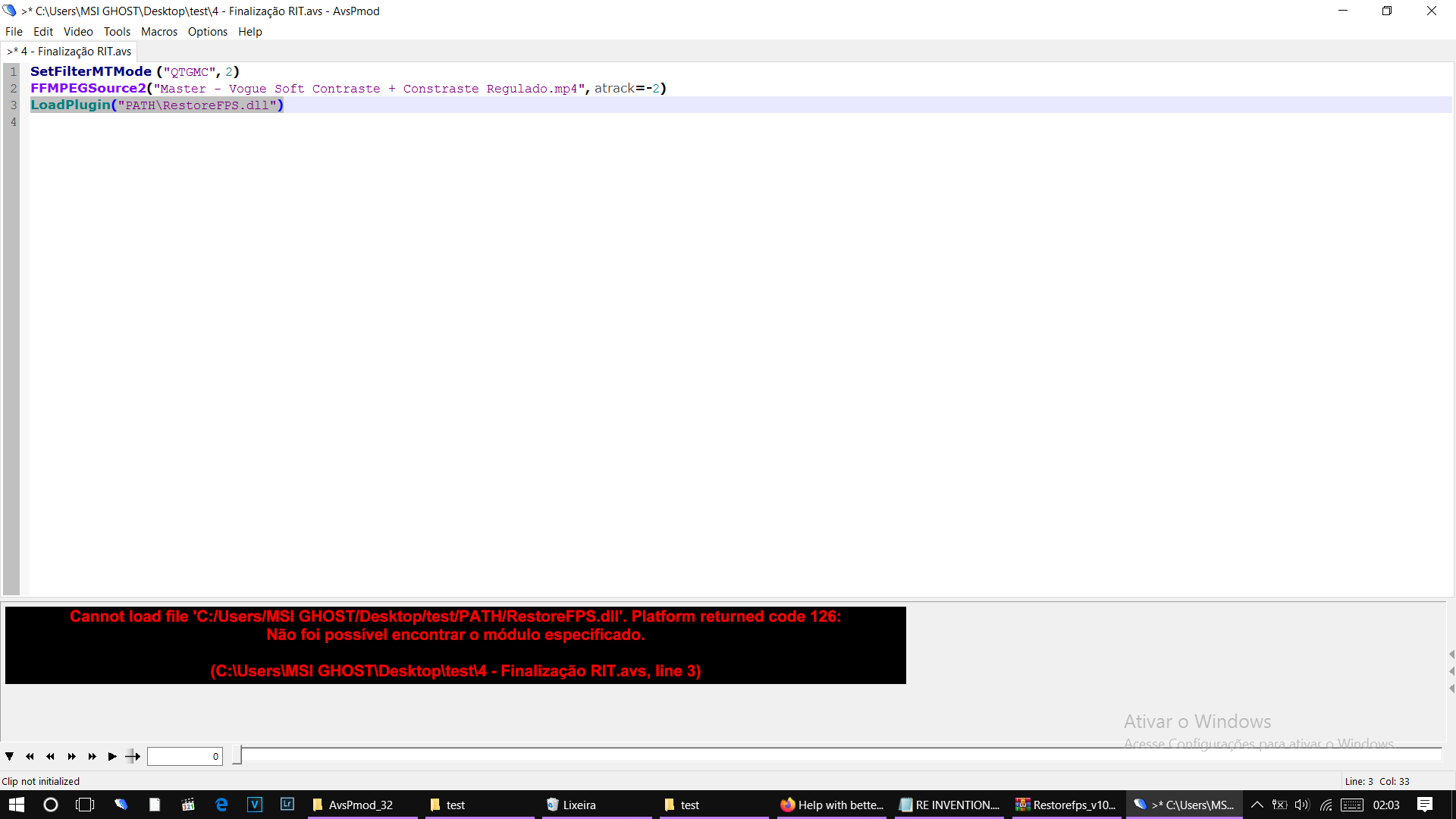

  17. The source is a ConvertFPS style blend conversion from NTSC to PAL 25i . The source deblends fairly well with RestoreFPS to 29.97 after double rate deinterlacing.
    The YT version is 30 FPS - but it has blends , is jerky, and it was not processed properly .
    You can interpolate to fake 59.94p using rife or similar and it will look smoother, at the risk of artifacts. Unfortunately this source has blended scene changes and that causes extra problems. The avs version of RIFE has bad scene change detection in the first place (a lower scenechange threshold will cause some frames to duplicate and stutter in the middle of sequences because of false positive detection). One option is to use remapframes to specify frames to duplicate for the bad scenechange frames, or blend them (mix a convertfps version). Alternatively, you can interpolate 1 direction using DMVFN to fix the scene changes completely with unique frames, but there is no avs /vpy implementation yet
  18. Originally Posted by poisondeathray View Post
    Wow, this is really incredible, I've never seen this file with this frame interpolation, the restorations always had the wrong rate, it's incredible and smooth!
    I have very little experience in Avisynth, unfortunately I still don't know how to add values to the filters that would require specifying the frames, could you share the script you used?
    I would be very grateful.
  19. RestoreFPS is x86 only. You can use it in mp_pipeline (combine and run x86 and x64 functions in a either x86 or x64 host. x64 host is usually faster does not have memory amount restriction. Or you can divide up into steps with lossless intermediate. If you were using very slow filters, maybe that would be a better option
    The Trim(2,0) was because of the way the sample was cut , there are 2 leading garbage b-frames (open GOP) that screw up the cadence. On a full source, you probably don't need it
    The RestoreFPS phase might need to be adjusted. In this example it was "0.8" ,but for some scenes a different value might be slightly better e.g. 0.85, or 0.9 - or you can mix/match scenes/settings for best results. 0.8 was sort of the average , where all scenes looked ok
    I left scenechange for RIFE off , because it really isn't very accurate. ReplaceFrames was used to fix the scenechanges with duplicates. Some of the blends before the scene change I left in, because it's smoother and looked ok - you'd have to go through the entire concert to fix it properly. If I was spending the time fixing it up properly - I would probably use DMVFN to interpolate the scene changes. Because you don't have a reference frame "after" before the scene change, or reference frame "before" the beginning of the next scene, you cannot interpolate using RIFE or optical flow. DMVFN is 1 directional interpolation using 2 previous frames
    You can play with other deniosing /deblocking/upscaling filters - the main point of this post was really RestoreFPS to 29.97 - it gives you the best starting point for that source - clearer frames and reduction of blends. It's arguably the most important step no matter what filters you choose

    Friend, could you help me? In the RestoreFPS phase I need to run on the AvsPmod 32-bit platform, right?
    I downloaded the RestoreFPS DLL and placed it in the 32-bit plugin folder, but I can't execute the line: LoadPlugin("PATH\RestoreFPS.dll"), I get this error in the photo.
    I'm sorry, I have little time with Avisynth and I wanted to understand this part

    If you're using MP_Pipeline for 32 and 64 bit sections of your script,
    You can certainly open it with a 64 bit host app.
    Did you try that?
    Do I need to run the ''MP_Pipeline'' plugin at the beginning of the script for each platform?
    If so, I'm not able to run it either

    It still gives me this error
  28. Member
    Mar 2008
    Is that the complete script? Since you're only running one section, no need for MP_Pipeline at all,
    you can remove it. Just open the sdcript in a 32 bit host
    Are you running the latest version of Avisynth Plus ?

    MPEG2Source cannot open the file, so I opened it with LWLibavVideoSource, and this error appears when I try to run ''RestoreFPS''
  30. Member
    Mar 2008
    Mpeg2source can only open d2v index files created by DGIndex (which can index m2v/mpg/vob, etc.)
    No surprise it didn't work
    Error code 126 is a general error usually related to a dependency issue one way or another.
    Try AvsMeter on your plugins library to see if it finds any errors -
    Since I can't read the error in your image due to the language, I'm only guessing
