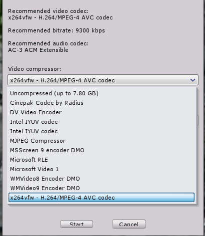

    I am also currently playing around with Video Enhancer 2.2 that uses super resolution resize, it was mentioned in a post I stumbled across.
    However it will only accept my huffyuv video if I select the Uncompressed option. Does anyone use Video Enhancer?
    [Attachment 73777 - Click to enlarge]
