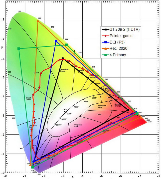

    I suppose the spec is about broadcast formats, and there have been only two digital HD broadcast formats: 720p and 1080i. 1080p50 has been introduced in Europe around 2016. 625p50 was considered HD in Australia, I wonder whether it used 709 or 601?
    I believe the reason for 709 is that it allows wider color gamut, which I suppose was influenced by switching from CRT to plasma and then LCD, which offered higher dynamic range and color gamut. I don't think this standard is related to whatever people do with their files, but I suppose as long as the content matches the header, and the playback device can make sense of it, any of the two can be used.
    Now thinking of it, since we use LCD panels, does it make sense to use 709 for everything?
    On a second thought, I searched online and 601 looks very similar to 709. Looking at the numbers, they are practically identical, 709 has slightly more in the green channel. So, I guess who cares, use one or another. Compared to 2020 or other formats, the difference between 601 and 709 is negligible (expecting lollo doing frame subtraction comparison in 3... 2... 1... seconds).
    EDIT: an interesting article about multi-primary displays: WCG Standards Needed for Multi-Primary Displays
    Image Attached Images

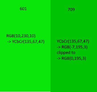

    @Sharc, assuming that one can accept the small difference between 601 and 709 in the green channel, is 709 more, um, correct or predictable when transforming RGB <-> Y'CbCr, in particular when full range values are used? I looked at the messages regarding color space and it seems that some of the conversions one way or another produce out of bounds values or something?
    Yes, this may happen, as others have explained.
    Here an example for RGB transformed to YUV using the 601 matrix and decoded to using the 709 matrix:
    Source is RGB(10,230,10) -> using 601 matrix -> YCbCr(135,64,47)
    Decoding YCbCr(135,64,47) -> using 709 matrix -> RGB(-7,195,3) => R(-7) is out of gamut -> clipped to RGB(0,195,3)
    [Attachment 73038 - Click to enlarge]
