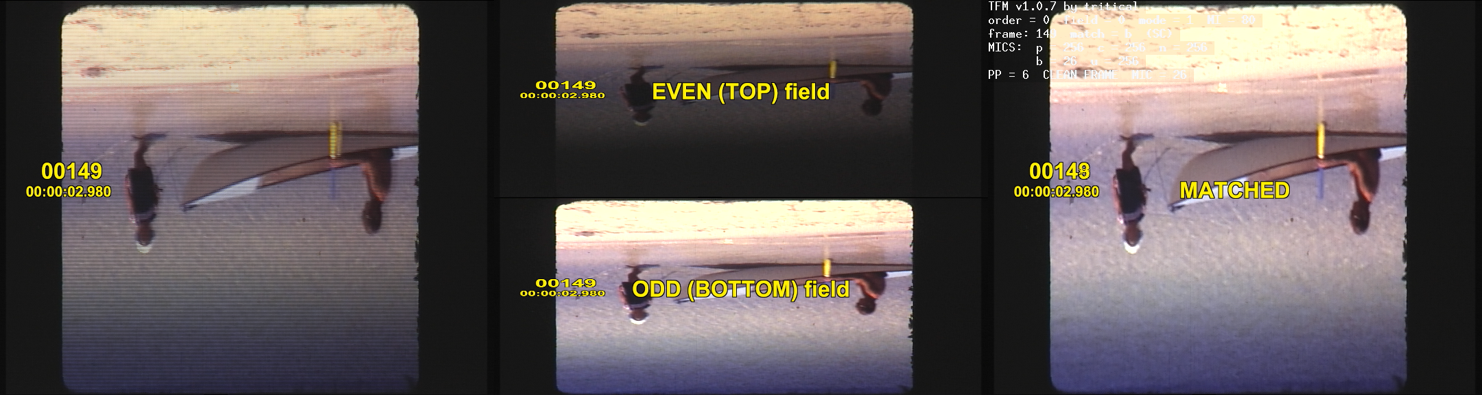

    I took a look to the manual. The GS300 (PAL) doesn't support 50 interlaced frames per second (aka 100 fields per second). It records 50 fields per second which get woven to 25 interlaced frames per second, so the format is the standard PAL 25i (=25 interlaced frames per second, sometimes called 50i referring to the 50 fields per second).
    So something went wrong with the capture process it seems. (I refer to the file 'GS300 Canoe 1-000 F2-8.avi' of post#36).
    The fields with changing parity can be matched using TFM() though, see below.
    Added2:
    Here a script for visualizing:
    AVISource("GS300 Canoe 1-000 F2-8.avi")
    clip=last
    clip=clip.showframenumber(scroll=true,x=60,y=260,size=36).showtime(x=100,y=286)
    even=clip.separatefields().selecteven().subtitle("EVEN (TOP) field",size=36,align=5)
    odd=clip.separatefields().selectodd().subtitle("ODD (BOTTOM) field",size=36,align=5)
    split=stackvertical(even,odd)
    matched=clip.TFM(mode=1,pp=6,display=true ).subtitle("MATCHED",size=36,align=5)  #pp=0 for no posprocessing of combed frames
    return stackhorizontal(clip,split,matched)
    Example for frame 149:

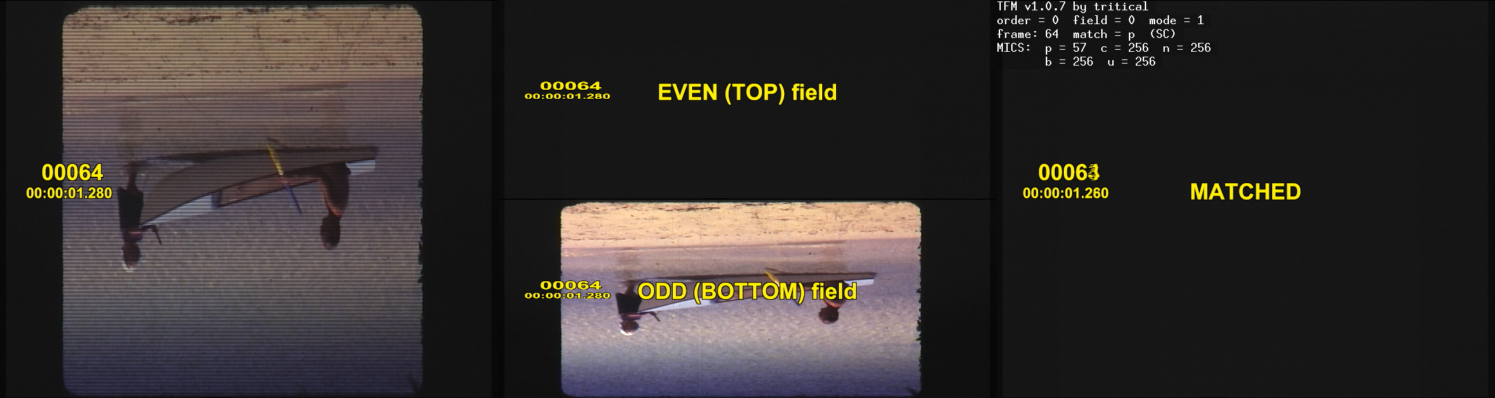

  26. Right. See my script above and set TFM(pp=0) for no postprocessing to see the orphans.
    For example frame 64 with pp=0.
    There's no point in dealing with this cap.
    Agree. After desparate attempts

    That's a killer, Jagabo, thanks. My plugins folder is ever increasing in size.
    What's your opinion on the black bars: I'm obviously going to chop them all off and make it 4:3, but do they affect/upset AVISynth functions? Should I get rid of them before running the script?
