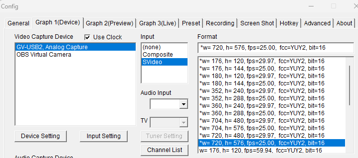

  8. I am using the driver which was shipped with the device. Works perfectly. I can set the Proc Amp etc. No reason for upgrading.
    Windows 11: 1.1.0.93 28.06.2010
    AmarecTV 3.10: 1.1.0.93.5, 2010/06/28
    Settings:

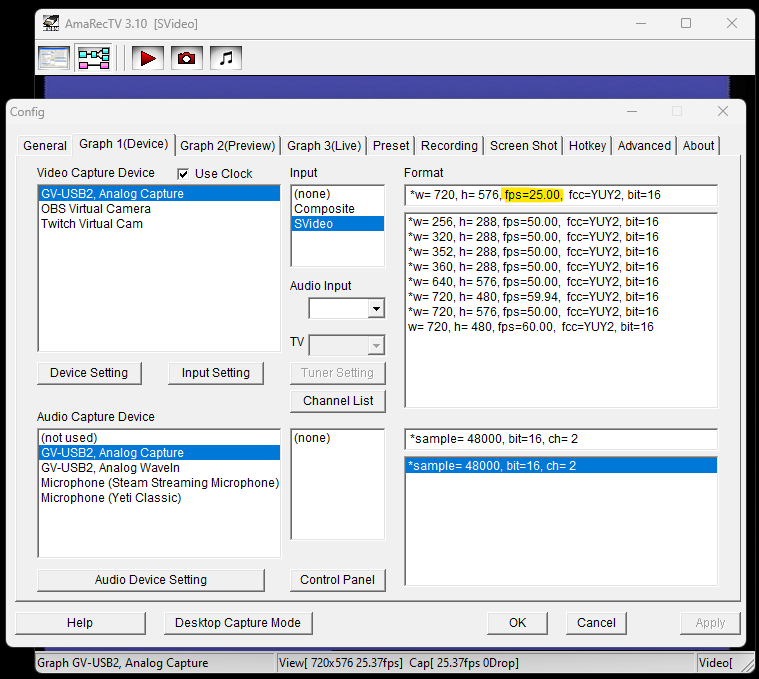

    Any chance you can share the driver here? my version is 1.1.093.8 (1.12) (downloaded from io-data web page) and it doesnt give me the option to select *w= 720, h= 576, fps=25.00, fcc=YUY2, bit=16 only 50fps. I am using Windows 11 and going back to the previous driver (1.11) from their web page does not work at all.

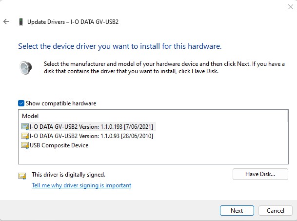

    Fair enough, mine works fine on Win 11 with the 2010 version so I don't think it's a fundamental driver issue. Are the two driver versions (dated 2010 [1.1.0.93] and 2021 [1.1.0.193]) visible in Device Manager, like this?

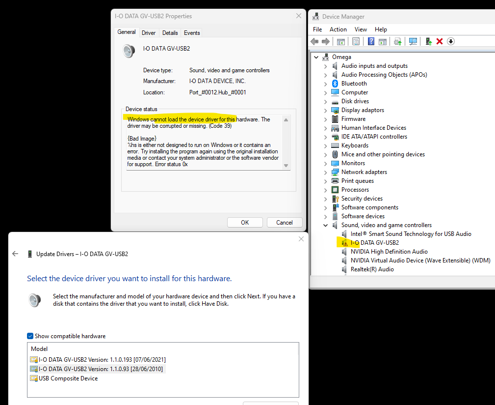

    This is what i get when i install the 2010 version from io data page

    Hi Sharc, thats great thank you, i have downloaded that driver and thats the same one from IO datas web page, it doesnt work for me, was this from your original disc? Its weird the device doesnt like that driver, or windows doesnt like it.
    Thank you.

    Sharc's didnt work, i just cleared the registry and reinstalled the 1.11 version still doesnt work. it really is weird.
    Thanks for your help
    DMS
    May 2005
    Australia-PAL Land
    I reckon you have a dud device. Bummer.

    The newest driver works but doesnt give the 25fps option, when i use it on my Windows 10 laptop it works perfectly, just windows 11 doesnt like the older driver. I will stick with the newer driver and use the work around of manually changing the fps in amarectv
    [Attachment 79122 - Click to enlarge]
    I was just curious as Sharc's driver seemed to have a different version number to the one from io data web page.
    Cheers
    Well there you go, I tried that many moons ago with a HDMI grabber and it didn't work but it certainly does for the GV-USB2. Thanks for the headsup.
