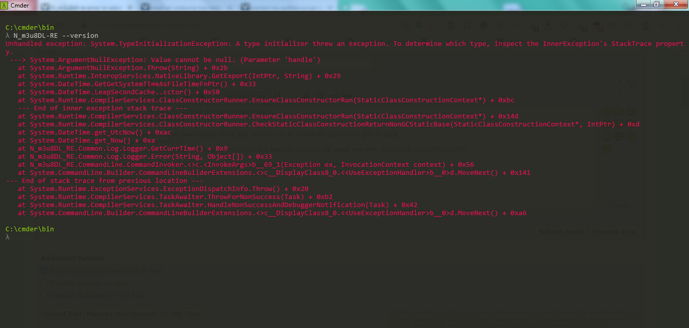

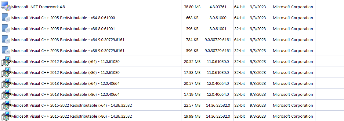

  1. I have installed .Net Framework 4.8 in windows 7 service pack 1.I really want to use N_M3U8DL-RE but it is giving this error as shown in the image.
    if anybody can help please.
    Thanks.

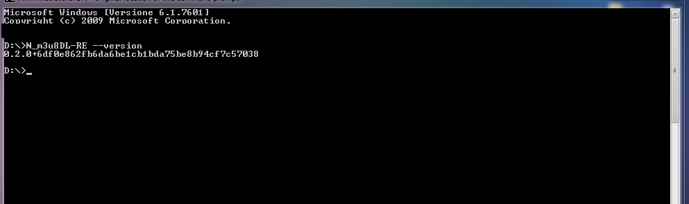

  5. @kartik
    N_m3u8DL-RE work fine on win7 and i think .NET Framework is not required from this tool
    [Attachment 73603 - Click to enlarge]

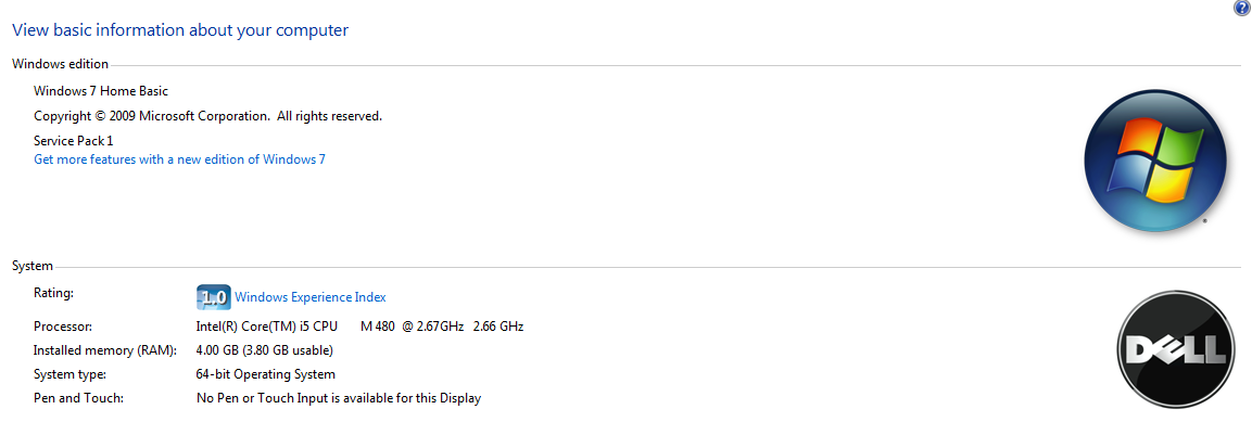

    I do not know if I have installed all the updates then why is it not working in my dell laptop ?
    please see this image.
    [Attachment 73607 - Click to enlarge]
    I really need your help to run this tool in my laptop.
    Thanks.

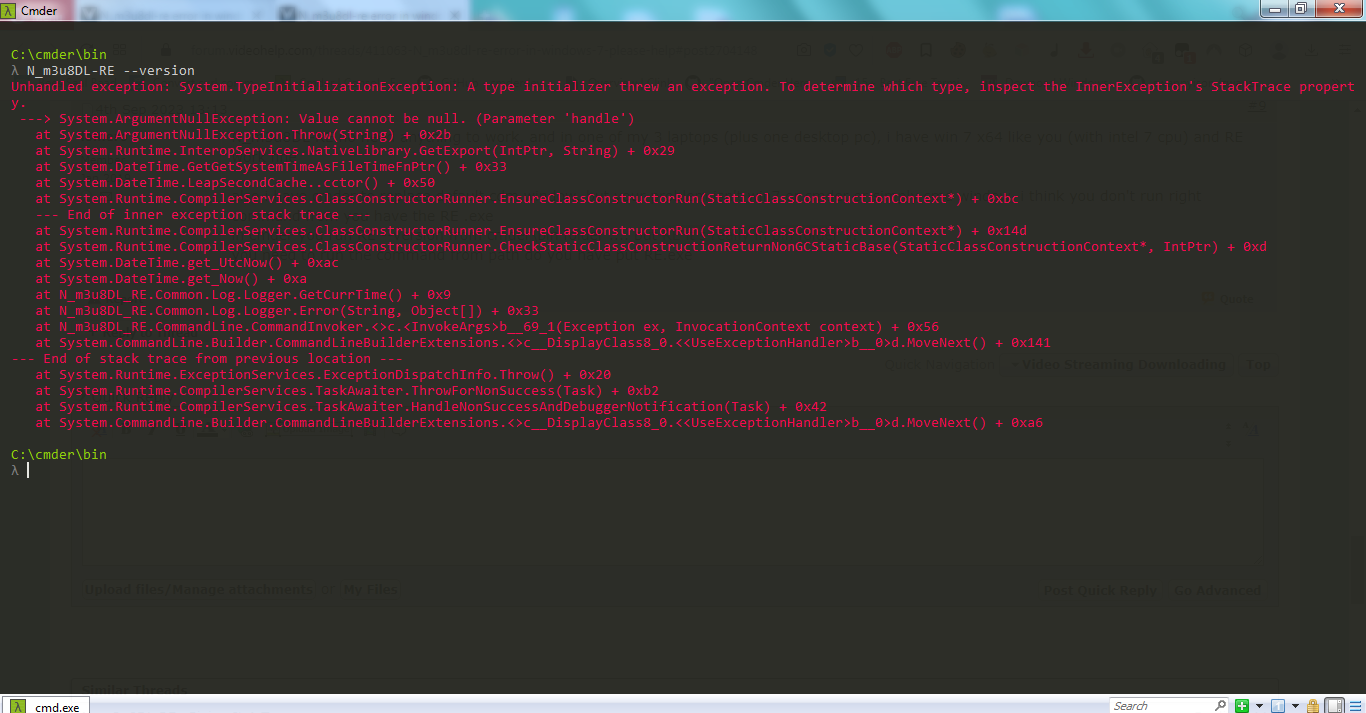

    I tried to run it in cmder but it gives me this error why ?
    [Attachment 73609 - Click to enlarge]
    what kind of error is this ?
    please help thanks.

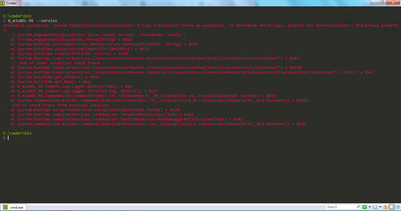

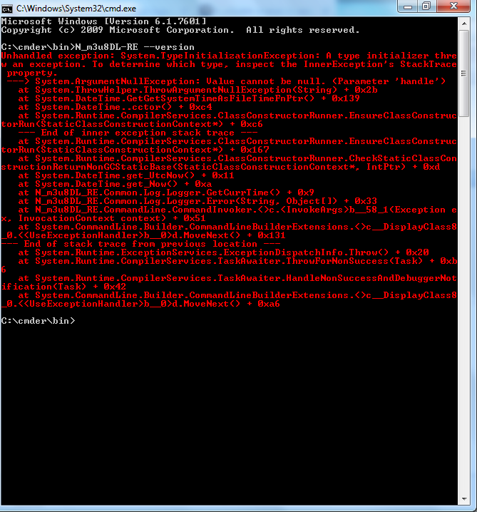

    Thanks for the reply lomero but i have done all the required settings for N_m3u8dl-re but still gives error.
    Added to
    C:\cmder\bin\N_m3u8DL-RE
    N_m3u8DL-RE also added into the PATH environment variable.
    N_m3u8DL-RE is in bin folder but when i tried again look what error came.
    [Attachment 73621 - Click to enlarge]
    is there any way like installing update or anything to solve this issue so it can run in my laptop ?

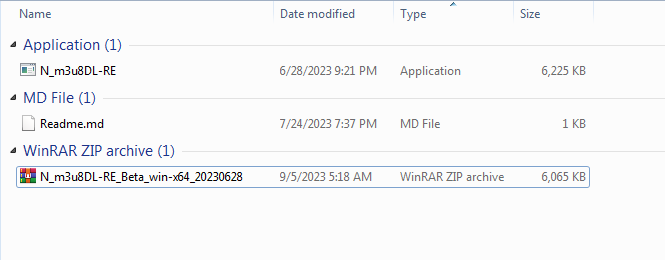

    Thanks piaohua and lomero for replying.i downloaded latest version and look what happens in image.
    [Attachment 73631 - Click to enlarge]
    [Attachment 73632 - Click to enlarge]
    I do not know what thing is causing this trouble ?
    I had never any problem like this before so anybody can help me please.
    thanks.

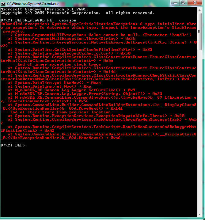

    Try in command prompt and post a screenshot of the command prompt
    Thanks for repling Karoolus but i tried in command prompt also look what happens in below image.
    [Attachment 73638 - Click to enlarge]
    can you help please ?

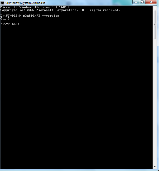

  18. Originally Posted by pteque View Post
    I think the suggestions upthread regarding updating to Windows 11 are very sensible; running an unsupported OS is asking for trouble.
    However, it seems that this error is related to two missing software updates, Microsoft Visual C++ 2015-2019 Redistributable and KB3063858.
    https://behroozbc.hashnode.dev/run-net-desktop-app-on-creepy-windows
    I had already installed Microsoft Visual C++ 2015-2019 Redistributable as you can see in this image but it was not working.
    but when i installed KB3063858 see what happened.
    [Attachment 73644 - Click to enlarge]
    you are amazing my friend it is working.
    Thank you so much for helping.
