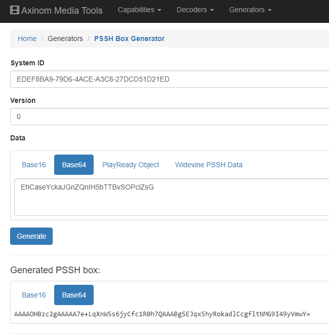

  15. 1) update N_m3u8DL-RE to 0.1.9 version
    2) obviously replace my generic --key xxxx with real kid:key .... your kid is 1f591015b7a44311b47035b6a787e245 add corresponding key
    3) also replace generic --save-name xxx to --save-name your_video_file_name
  16. Lomero: Thank you for your post. I was able to update N_m3u8DL-RE to version 0.1.9
    I put the real kid : real psh
    The program didn't like the name so I reverted to generic.

  28. try converting that short pssh "EhAJqQUDr1ZHJINXKE5VieM2SOPclZsG" to a full widevine box pssh https://tools.axinom.com/generators/PsshBox
    AAAAOHBzc2gAAAAA7e+LqXnWSs6jyCfc1R0h7QAAABgSEJqx5hyRokadlCcgfltNMG9I49yVmwY=
    and then use that on cdrm-project.com
    [Attachment 72136 - Click to enlarge]
    if that doesnt work, paste a screenshot of what cdrm-project shows
  29. ElCap: Thank you for your help and guidance. I was able to follow your directions in post number 26 and get the license and pssh and then using cdrm-project got the proper key and the file downloaded and was decrypted. I am going to practice this often to get it ingrained but it is worth the effort.
  30. A couple of tips, when it comes to the pssh you must be precise I neglected an equal sign on the end and it was rejected. I realized my mistake and corrected it. Also if your Internet goes out when in the process of using N_m3u8DL-RE and your project fails; don't give up, don't delete what has been gotten and just load the project again. What is missing will be gotten and then decrypted. It took me quite a while to get my project done this morning, but I learned more and it did turn out. With practice I should get quicker at it. Once again thank you to everyone that helped me. I hope A-n-g-e-l-a can find something of merit from this thread that she can put in a guide. Thank you iamghost, piaohua, lomero, A-n-g-e-l-a and El Cap. I appreciate being spoon fed as some would say; some of us need extra guidance and thank you all and other posters as well that teach us.
