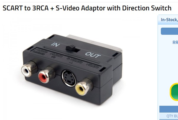

The real SCART to S-Video cables can't be found anywhere outside of Europe - the ones with S-Video and white and red RCA only. The cheap eBay SCART $2 adapters are composite over S-Video because they don't separate chrominance and luma, that's why there is red, white, and yellow on the same box. I tried using a SCART to composite cable I already have but just an S-Video cable has way better colours and is sharper. Component would need a converter box, not an option. HDMI capture devices have problems with analog signals.
This gadget outputs SVideo from SCART (from Cablechick):
[Attachment 73145 - Click to enlarge]
The Startech USB3HDCAP has Component input, and does a great job with HDMI input of an analogue source correctly set up for 576i output.Component would need a converter box, not an option. HDMI capture devices have problems with analog signals. -

So, what?Chroma and luma are coming out of the same S-Video port
And they are separate in the S-Video connector
Bigbad, you decide if true S-Video is coming out of the S-Video socket on that gadget or not.
I'm just confused because I have an offbrand S-Video cable for a PS2 that has the PS2 video connector on one end and RCA (yellow, white, and red) and S-Video. You can use either S-Video or Composite on one cable. One guy, on a gaming forum said that it wasn't true S-Video because of the yellow connector, and the original Sony cable had only the white and red RCAs. It seemed like a scam and the sellers in China might be using the same wires for composite for S-Video for this SCART adapter. Because just because it has a SCART pin for S-Video doesn't mean it's being used. I tested that S-Video cable and I remember it looking exactly the same as composite, it just looked a lot sharper. How they managed to create this kind of cable I don't know.
The PS2, just like the PS1 and even the PS3, outputs S-Video and Composite video simultaneously at it's proprietary connector. As a result, with a cable such as the one you have, you get proper S-Video at the S-Video connector and proper Composite video at the yellow RCA connector at the same time.
However, on a Scart output, such as at the back of a VCR, there is either S-Video or Composite, because some pins are shared. It is impossible to have S-Video and Composite at the same time through Scart.
Not correct, it is S-Video.
Yes, I actually happen to have that official Sony S-Video cable and it does indeed not have the yellow RCA. It has S-Video and audio (white and red RCAs). But that doesn't have any impact on S-Video vs. Composite if other cables do have the yellow RCA. It's just there in addition to S-Video because the PS2 supplies it all the time, whether you use it or not.
Like I said, some pins are shared. This is normal by standard and results in the infamous black and white picture in case of a mismatch. If you see color, it's all fine.
That is exactly what's to be expected. More horizontal detail, and no more dot crawl and cross color artifacts. S-Video isn't magic.Last edited by Skiller; 13th Aug 2023 at 08:22.
