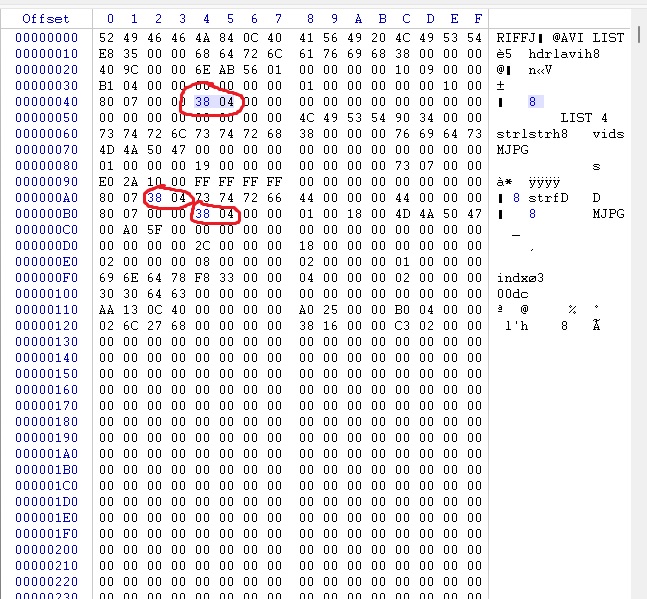

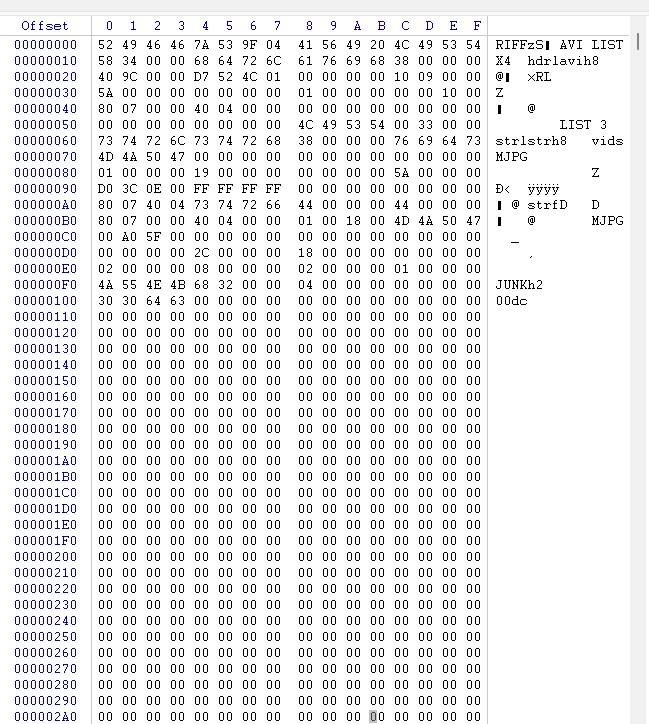

    please I wonder if does exist a way to change, via commandline in windows, the height value tag of an .avi file like this temp.avi
    https://www.swisstransfer.com/d/c6be6f53-50c7-4f8f-87dc-365d232a4f47
    so that the height internal tag change from the originally 1088 to 1080
    hex change from 4008 into 3808 in 3 points
    from
    [Attachment 73097 - Click to enlarge]
    to
    [Attachment 73096 - Click to enlarge]
    thanks

  3. I did what you wanted three changes, no problem to post python script to use in batch or even make an exe to run it with arguments,
    but I did those changes in avi header on pos 44, then it seams to be following video stream header bytes 54 (2bytes) and 72 (4bytes) changes, but mediainfo still reports original height 1088. Is that file suppose to be fixed?

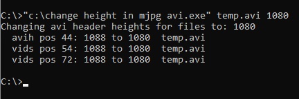

  7. based on this, this python script was made, you can use this python file in your batch script if you have python installed, usage as python is in there:
    import os
    import sys
    def load_value(avi_path, offset, length):
        with open(avi_path,'rb') as f:
            f.seek(offset,0)
            return int.from_bytes(f.read(length), byteorder='little')
    def get_offset(avi_path, string):
            offset = 0
            f.seek(0)
            while (buff := f.read(16)):
                if string in buff:
                    return offset + buff.index(string)
                else:
                    offset += 16
            else:
                print(f'  avi header with fcc type: "{string.decode()}" not found, avi header not found  in {avi_path}')
                return None
    def overwrite_bytes(avi_path, offset, new_integer, length):
        with open(avi_path,'r+b') as f:
            f.seek(offset,0)
            bytes_val = new_integer.to_bytes(length, 'little')
            f.write(bytes_val)
    def main(avi_path, new_dwHeight):
        new_dwHeight = int(new_dwHeight)
        avih_offset = get_offset(avi_path, b'avih')
        if avih_offset is not None:
            dwHeight = load_value(avi_path, avih_offset + 44, 4)
            overwrite_bytes(avi_path, avih_offset + 44, new_dwHeight, 4)
            print(f'  avih pos 44: {dwHeight} to {new_dwHeight}  {avi_path}')
        vids_offset = get_offset(avi_path, b'vids')
        if vids_offset is not None:
            dwHeight = load_value(avi_path, vids_offset + 54, 2)
            overwrite_bytes(avi_path, vids_offset + 54, new_dwHeight, 2)
            print(f'  vids pos 54: {dwHeight} to {new_dwHeight}  {avi_path}')
            dwHeight = load_value(avi_path, vids_offset + 72, 4)
            overwrite_bytes(avi_path, vids_offset + 72, new_dwHeight, 4)
            print(f'  vids pos 72: {dwHeight} to {new_dwHeight}  {avi_path}')
    if __name__ == '__main__':
        usage, this should change mjpg avi to height 1080 if using python in cmd prompt:
        python  change_avi_height.py  filename.avi  1080
        args = []
        for arg in sys.argv[1:]:
            args.append(arg)
        if len(args) < 2:
            raise ValueError('Two arguments needed. First argument is avi filename, second is new height')
        for i, arg in enumerate(args[:2]):
            if i==0:
                if not os.path.isfile(arg) or not arg.lower().endswith('.avi'):
                    raise ValueError(f'First argument must be existing avi filepath. Got: {arg}')
            else:
                try:
                    int(arg)
                except (TypeError, ValueError):
                    raise ValueError(f'Second height argument must be an integer. Got: {arg}')
        print(f'Changing avi header heights for files to: {args[1]}')
        main(*args)
    If not having python, you need exe file.
    If having python, you can make exe file yourself, install pyinstaller in cmd prompt:
    pip install PyInstaller
    then use command (make sure there is your current python installed version like 38, 39 or latest 311):
    "C:\Users\*** user name ***\AppData\Roaming\Python\Python38\Scripts\pyinstaller.exe"  "*** your path to python file ***\change_avi_height.py" --name "change height in mjpg avi"  -–onefile
    then in directory where your change_avi_height.py is you will find dist directory and in there your compiled EXE file you can use in batch scripts, usage is:
    "change height in mjpg avi.exe"  "filenami.avi" 1080

  8. Image
    [Attachment 73103 - Click to enlarge]
    oh wow it works
    absoluty useful (but I don't understand how you did it, but everything is fine)
    it changes very well
    [Attachment 73104 - Click to enlarge]
    oh my ***
    thanks
