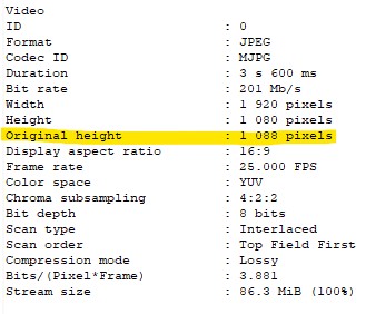

and AllRemuxConcatList.txt is:Code:ffmpeg.exe -y -v quiet -stats -threads auto -f concat -safe 0 -i AllRemuxConcatList.txt -vcodec copy -an output.avi
but the final output.avi is 1088 and not 1080:Code:file 'C:\Users\Administrator\Desktop\Nuova cartella (12)\AllSingleRemuxed\DJI_0139.MP4.avi' file 'C:\Users\Administrator\Desktop\Nuova cartella (12)\AllSingleRemuxed\DJI_0140.MP4.avi'

I believe MJPEG is always mod 16 internally. When a 1080 (mod 8) line video is compressed the encoder internally ads 8 lines to make it 1088 (mod 16) lines. On playback it removes those extra lines. All you're seeing is some confusion about those extra lines. The video stream itself isn't changed by the append operation.
After appending you can patch the AVI headers to indicate the video is 1080 lines instead of 1088. Or you can crop away the extra 8 lines when you edit the video. -

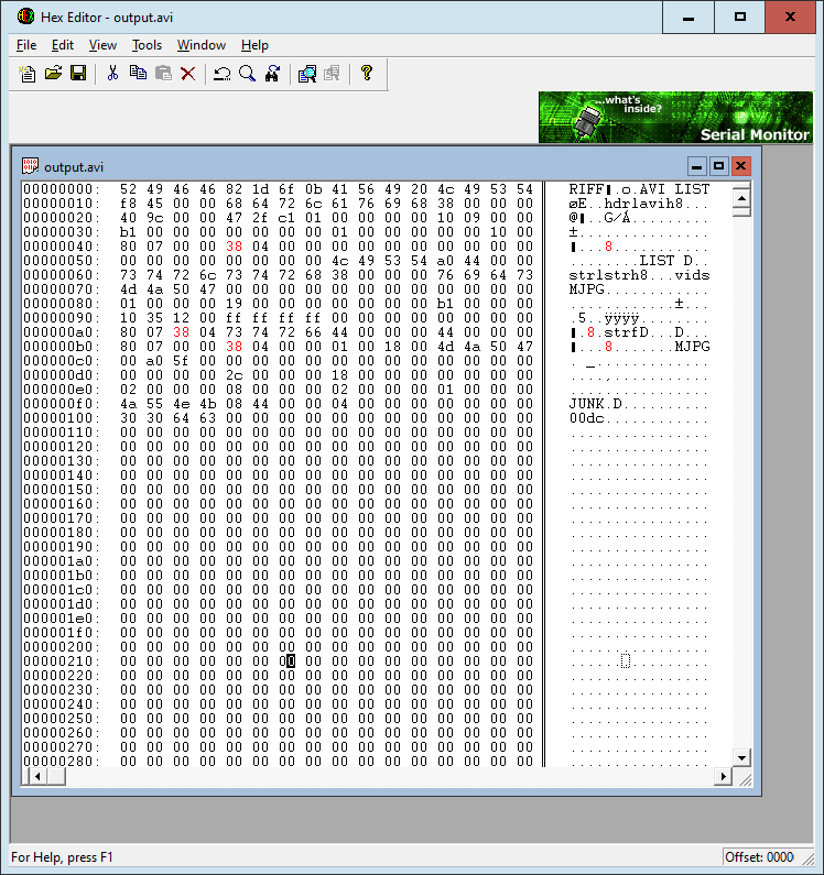

I used a hex editor to change three values near the start of the AVI file.
[Attachment 73083 - Click to enlarge]
The three red "38" used to be "40". Note that the value following them is 04. When you put the two bytes together into a word in little-endian order you get 0440 and 0438. 0440 hex is 1088 in decimal. 0438 hex is 1080 decimal. Those are the heights of the frame in the headers of the AVI file. So I changed the height of the frame from 1088 to 1080.
Useful information: https://learn.microsoft.com/en-us/windows/win32/directshow/avi-riff-file-referenceLast edited by jagabo; 9th Aug 2023 at 20:14.
