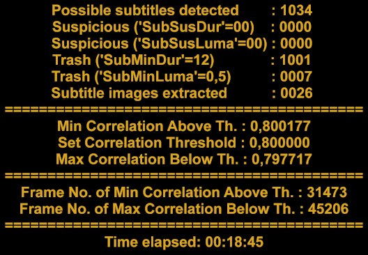

  3. Thanks. It finished after a while indeed.
    But it only extracted 26 subtitles out of 1000 detected.
    [Attachment 72742 - Click to enlarge]
    How can I improve the detection?

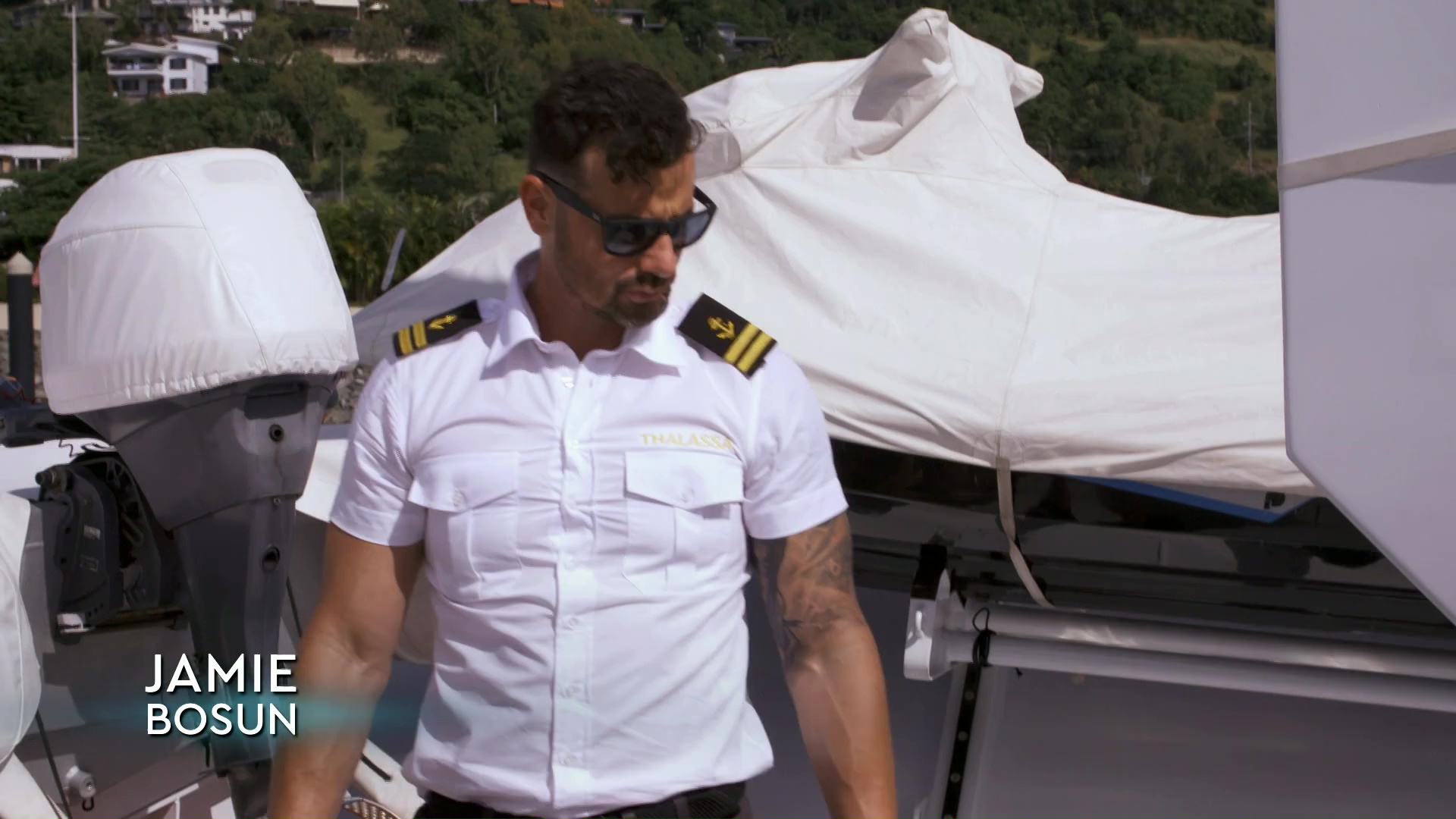

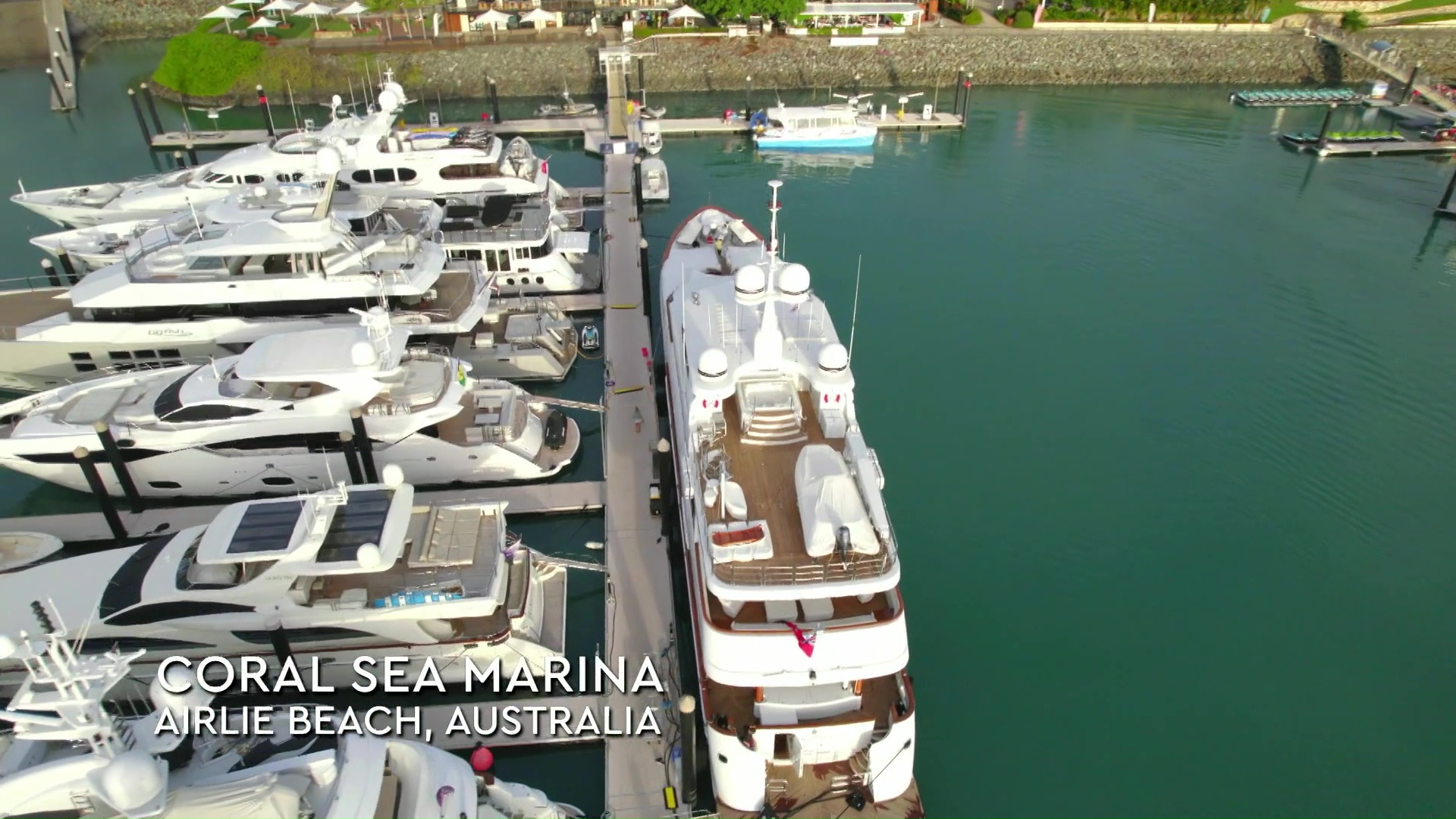

  5. I crop the file for test.
    I set DynMask to 2. It now found more subtitles, but still misses some.
    Here an example of what text I want to extract, it's not the usual subtitles, but more a description of the scenery/people
    [Attachment 72795 - Click to enlarge]
    [Attachment 72796 - Click to enlarge]
    Which setting can I adjust?
