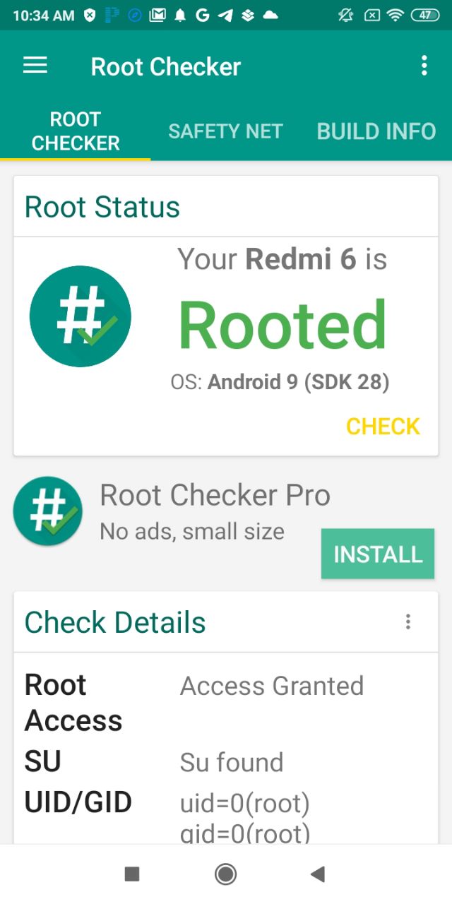

    And is your redmi 6 rooted?
    Jun 2022
    india
    [Attachment 72425 - Click to enlarge]
    yeah ofc ...how could i miss the main point...
