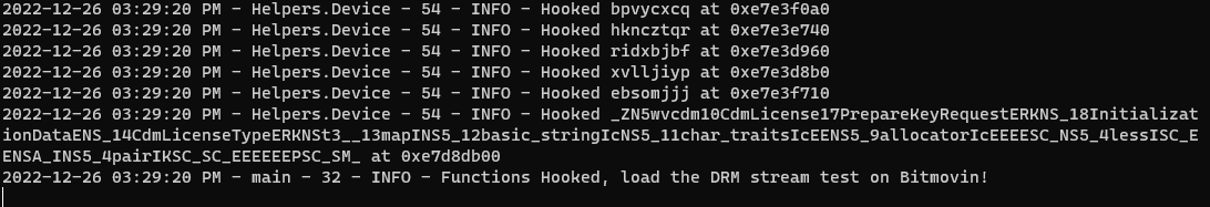

    [Attachment 68317 - Click to enlarge]
    Stuck here on android 10,11

    Send me your libwvhidl.so file, you can use this post to retrieve it - https://forum.videohelp.com/threads/404219-How-To-Dump-L3-CDM-From-Android-Device-s-(O...e6#post2646150
