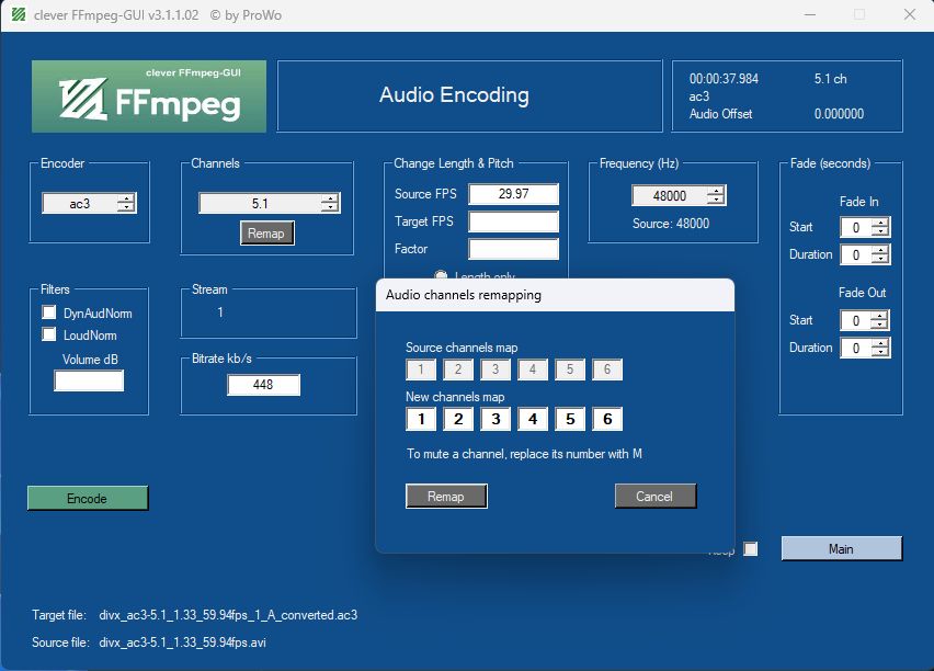

    The Standard Layout for 5.1 is:
    FL+FR+FC+LFE+BL+BR
    You can change the channels position with clever FFmpeg-GUI.
    [Attachment 71906 - Click to enlarge]
