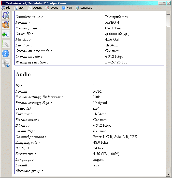

    Mediainfo's "Channel positions" (not the same as " channel layout" apparently) tells me "Front L C R, Side L R LFE" no matter what file I give it, and for files whose channel layout's are certainly different.

    Using FFmpeg to make a 5.1 file from 6 mono wavs with the channel layout mapped for SMPTE "L R C LFE Ls Rs", aka 5.1(side), I get a file that FFmpeg tells me is "5.1" -- NOT "5.1(side)" -- and it also has the "center channel playing through the left speaker" problem.
    Is FFmpeg doing some strange behind the scenes channel layout? Or is this a playback issue related to reading the files and their metadata or headers?
    Can one specify channel layout in FFmpeg, beyond what I've already did unsuccessfully with the mono files (see below)?

    Hmmm, I *suppose* that I have started to understand what is the _actual_ problem......
    Originally Posted by HoraceMcMahon View Post
    I'm not sure what difference the BACK left/right vs. SIDE left/right distinction makes in practice, but since the original DTS-HD file was 5.1(side), I'd like to end up there.
    MediaInfo and/or FFmpeg and/or whatever appear to be just following a convention invented in the "post-5.1 era"
    Namely, unless the 5.1 audio stream is inside an uncompressed .WAV /.AVI /.ASF /.WMA /.WMV file,
    it is always assumed to be FL+FR+FC+LFE+SL+SR.
    AFAIK, only uncompressed 5.1 audio inside a WAV /AVI /ASF container,
    or a Windows Media Audio stream inside an ASF container,
    can be properly-flagged as anything different than "FL+FR+FC+LFE+SL+SR".
    For example, in DTS-HD (and in TrueHD too, I presume), only the 7.1 channel layout may have the «side» channels. The official DTS-HD encoder has only one option for the 5.1 channel layout, and that option does not use Side-Left and Side-Right. The same thing happens with the formats MLP, AC3 and lossy DTS. In other words, it's up to the decoder or/and the end-user to decide whether the 'surround channels' in a 5.1 audio stream will be directed to the rear speakers (old-school preference) or to the lateral speakers (new convention).

    ffmpeg detected my DTS test file as 5.1ch(side) and all that was required to convert it to PCM in a MOV container was this:
    ffmpeg -i test.dts -acodec pcm_s24le output.mov
    For my AAC 5.1ch(side) test file, I had to inform ffmpeg of the distinction:
    ffmpeg -i test.aac -filter "channelmap=channel_layout=5.1(side)" -acodec pcm_s24le output.mov
    For combining six individual wave files:
    ffmpeg -i FL.wav -i FR.wav -i FC.wav -i LFE.wav -i SL.wav -i SR.wav -filter_complex "join=inputs=6:channel_layout=5.1(side):map=0. 0-FL|1.0-FR|2.0-FC|3.0-LFE|4.0-SL|5.0-SR" output.flac
    Thinking about it, if the input files are in the correct order the mapping is probably redundant:
    ffmpeg -i FL.wav -i FR.wav -i FC.wav -i LFE.wav -i SL.wav -i SR.wav -filter_complex "join=inputs=6:channel_layout=5.1(side)" output.flac
    By the way, I noticed the part of the command line specifying 24 bit signed PCM is being ignored when the output is a MOV container and what you get is 24 bit unsigned PCM instead. I don't know why. Maybe it's a limitation of the MOV container but 16 bit behaves and the output is 16 bit signed. Just thought I'd mention it....

    In my case, as mentioned in the OP, using just that command, I get a 5.1 -- not a 5.1(side) -- file, and channels play back scrambled: the center channel when played back through VLC and Quicktime seems mapped to the left channel. I have no idea why this is, as it plays fine in MPC-HC and everything is in the right order when checked in Adobe Audition.
    By the way, I noticed the part of the command line specifying 24 bit signed PCM is being ignored when the output is a MOV container and what you get it 24 bit unsigned PCM instead. I don't know why. Maybe it's a limitation of the MOV container but 16 bit behaves and the output is 16 bit signed. Just thought I'd mention it....
    I didn't notice that before, but true in my case as well.

    For a quick test with a flac quad file that MediaInfo says looks like this:
    Front: L R, Back: L R
    The following three command lines all produced the same result, according to MediaInfo:
    ffmpeg -i test.flac -f wav - | neroAacEnc.exe -q 0.5 -ignorelength -if - -of test.m4a
    ffmpeg -i test.flac -filter "channelmap=channel_layout=quad" -f wav - | neroAacEnc.exe -q 0.5 -ignorelength -if - -of test.m4a
    ffmpeg -i test.flac -filter "channelmap=channel_layout=quad(side)" -f wav - | neroAacEnc.exe -q 0.5 -ignorelength -if - -of test.m4a
    which was:
    Front: L R, Side: L R
    It looks like AAC can't distinguish between quad and quad(side), but quad(side) is what you want anyway.
    To double check MediaInfo was getting it right I tried this command line:
    ffmpeg -i test.flac -filter "channelmap=channel_layout=4.0" -f wav - | neroAacEnc.exe -q 0.5 -ignorelength -if - -of test.m4a
    and the result was this:
    Front: L C R, Side: C
