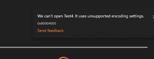

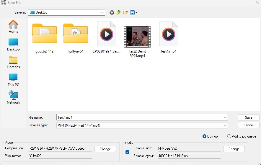

    Now the issue I have is that for some reason i cannot play the converted files from avi to .mp4 using windows media. See screenshot of my settings when saving the file using VirtualDub2. What am I doing wrong?
    The video that gives me the error is attached.

  2. You might need YUV420 instead of YUV422 pixel format. WMP might not accept AVC 422. There should be an option to downconvert in the conversion options
    Or a better idea is use a better player, such as MPCHC, or VLC, or MPV, etc...

    What is your source / what are you capturing ? It's unlikely that it has 4:2:2 worth of color information to begin with, unless it's a video game, or screen capture
    If the folks you're sharing it with use WMP or some bad player - then they won't be able to play it either, like you.
    4:2:0 is the most common distribution format by far, and will give you the least problems with playback

    I'm thinkin now, what if I want to upconvert these videos at a later time (say to 720p or 1080p) wouldn't it be best to compress it using 4:2:2 pixel format from the getgo? Also, wouldn't it be best to use 422 for TV playback? I am not sure i understand the implications of 420 and upconversion. Ultimately, i do want to try to make the picture better, if possible.

    VHS does not have very much chroma information to begin with. 4:2:2 is upsampled chroma already for a VHS source as SD resolution (720x480 for NTSC, would have 360x480 in terms of color samples)
    But 4:2:2 is important for the capture stage because of "interlace" . Each scanline has a chroma sample, instead of sharing samples . Many programs/devices can have problems with interlaced chroma in 4:2:0 configuration - you get errors like chroma notching
    But if you're deinterlacing properly, then 4:2:0 will be more than adequate to hold all the color information in the VHS source. There will be no difference upscaling later, 4:2:2 is already upscaled in terms of chroma information at SD resolution for VHS
    If you decide to keep it 4:2:2 for distribution, then tell your recipients to use a proper player, otherwise they won't see anything
