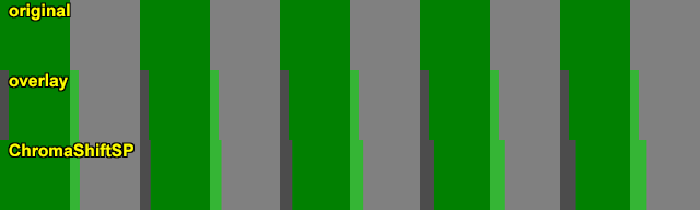

    OMG. While comparing the two methods, I just noticed there's a bug in ChromaShiftSP(). The amount it shifts varies across the frame:
    [Attachment 71466 - Click to enlarge]
    On the top is a row of alternating grey and green boxes. In the middle row is manono's method using overlay to shift the chroma 8 pixels to the right, Overlay(GreyScale,Last,X=0, Y=8, Mode="Chroma"). The shift is consistent all across the frame. On the bottom is ChromaShiftSP(x=-8). At the left of the frame the shift is correct, but at the right the chroma is shifted twice as much. The same thing happens on the Y axis (not shown here).
    This can be fixed by changing ChromShiftSP's last line from:
    clp.MergeChroma(clp.Spline16Resize(w, h, X, Y, w+X, h+Y)) }
    to:
    clp.MergeChroma(clp.Spline16Resize(w, h, X, Y, w, h)) }
    Is this an issue with the way different versions of AviSynth deal with out-of-frame pixels in Spline36Resize()? I'm using AviSynth+, v. 3.7.3.

  15. There is a modified chromashiftsp2 , the changelog says fix incorrect shifting - can you check jagabo ?

  16. Yes, that updated ChromaShiftSP2 fixes the problem (as well as offering additional features). The result looks the same as my proposed fix:
    [Attachment 71467 - Click to enlarge]

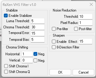

    PDR, sorry about that, by "3rd party" I really just meant "replacement", but I had a Virtual Dub "3rd party" filter mindset, although, I think I had to manually add ChromashiftSP to my plugins folder.
    Musing now, I wonder why would a programmer would make X values to the right of 0 negative? This stuff is hard enough to grasp anyway; to throw in that seems odd to me.
    I always wondered what Chroma I and Chroma Q was in Flaxen's VDub plugin; I guess that is what ChromashiftSP2 is doing with the separate U and V movement?

  18. Originally Posted by Alwyn View Post
    Yes, that always annoyed me too. You could fix it by negating the X and Y values to Spline36Resize. In addition to my earlier fix:
    clp.MergeChroma(clp.Spline16Resize(w, h, -X, -Y, w, h)) }
    That will match manono's Overlay method. I never bothered to "fix" that because then my version would be different than everybody else's.
    I don't know about the Flaxen filter in particular. But the I/Q system is a different rotation of the chroma. You should be able to get similar results by Tweaking the hue, shifting the chroma, then rotating the hue back to normal.
