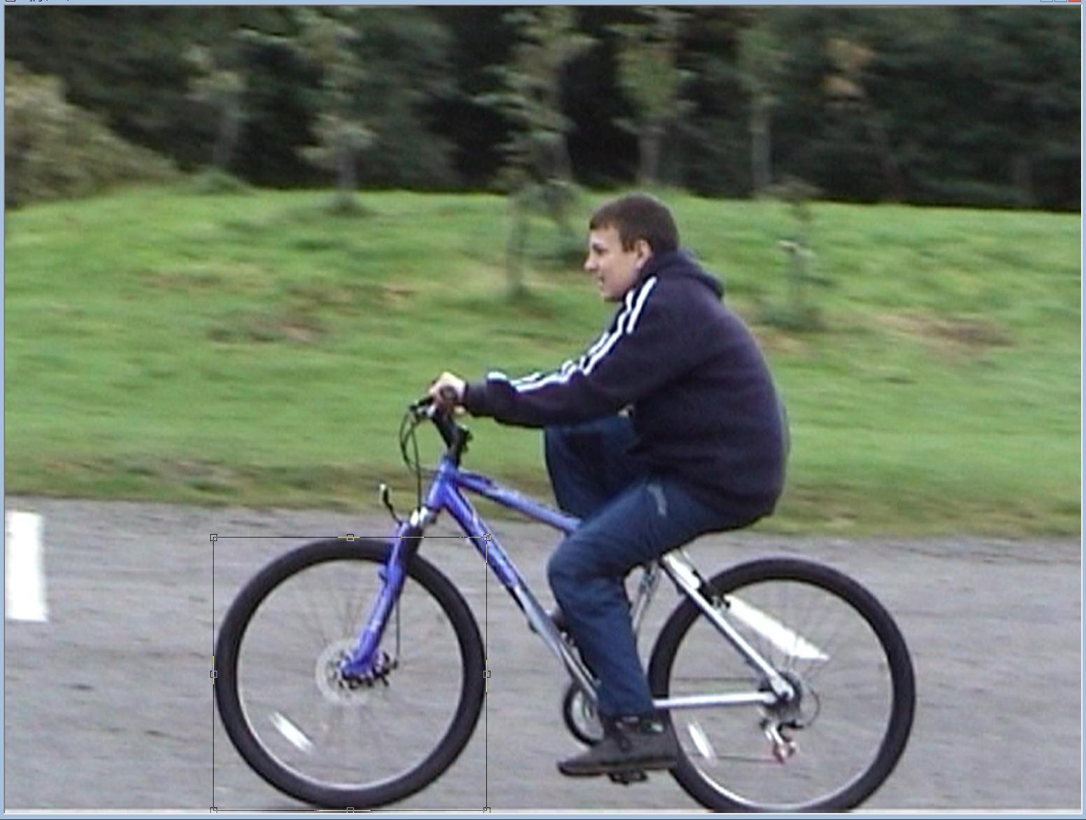

  10. You might be able to find something in one of the tapes to use as a reference. A round clock in the background, a ball, a bicycle wheel, a square window, etc. The bigger the better, as it's easier to see the difference between say 300 vs .306 pixels vs 30 and 30.6 pixels.
    Sep 2021
    Thanks jagabo. I was able to find bicycles. On the first clip I've encoded both, one SAR 12/11 and one 16/15. I've also added another couple of clips but I felt the first clip is probably the best as the bicycle is stationary. I've watch both videos and I couldn't really tell any differences.
  12. I'd be more confident if the wheels were closer to the center of the frame. But I'd say those were SAR 12:11 (ITU 704x768 = 4:3 DAR). Here's a square box overlaid onto one of the wheels after resizing to square pixels, frame 267 after:

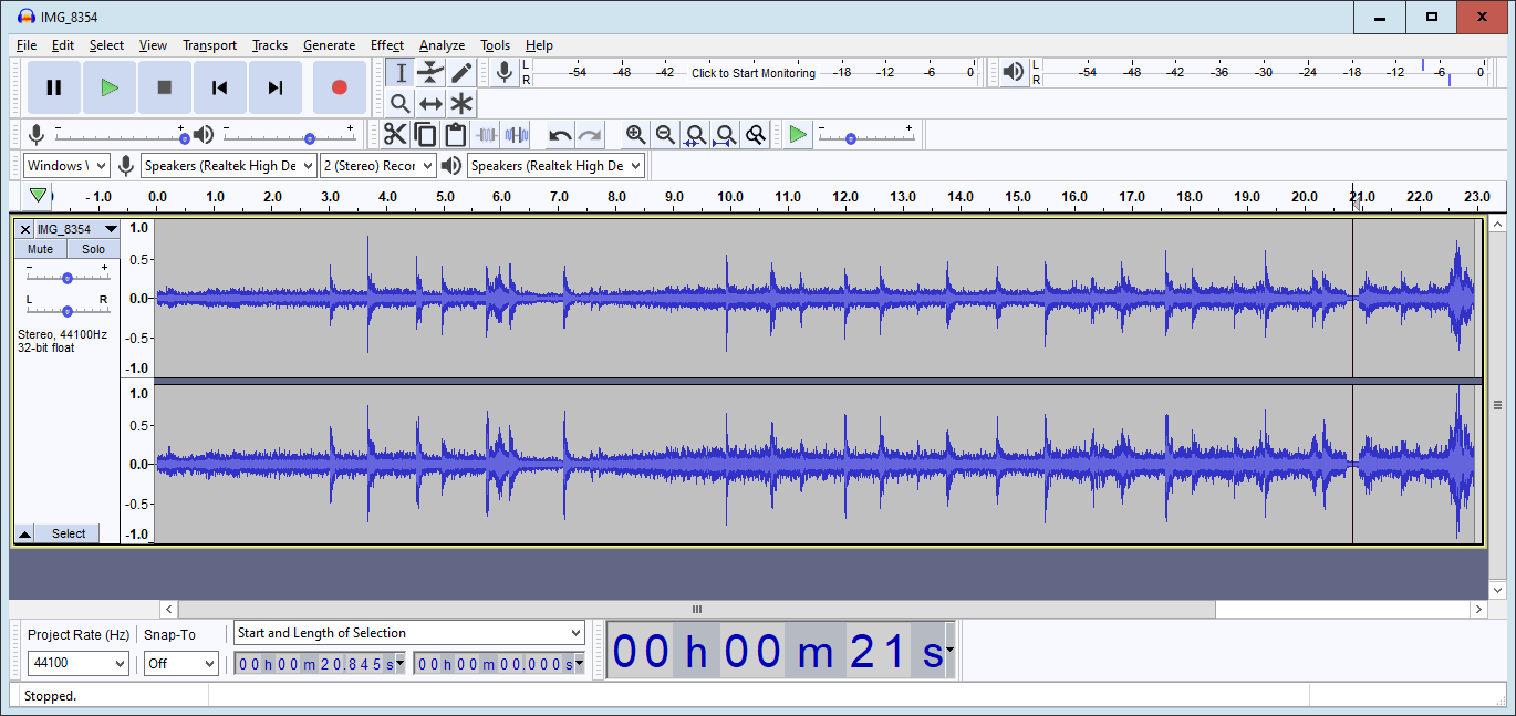

    Thanks jagabo. What a clever way of finding out. My wife and I have viewed the clips 12/11 and 16/15 quite a few times now and we couldn't see any noticeable difference whatsoever, which in itself is comforting. I will stick with 12/11. I appreciate you figuring that out for me. Another random thing I noticed, on my smart tv whilst watching the encoded MP4 movies sometimes we get a audio blip. The MP4 and the AVI version both play fine on my computer WMP & VLC and another TV with a USB port. The only device this happens on is the smart tv hence the reason I've upload a mobile clip (It happens at approx. 20 seconds in). It's no big deal as the videos look fantastic but I just wondered if you may know why this happens. Thanks.
  14. I don't know the cause but there is an audible drop in volume at that point:

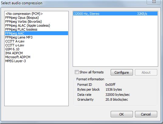

    Thanks jagabo. It has the same audio blip on my son's Samsung tv. I've done another copy of just that clip which plays ok on my smart TV. I would say the audio blip happens every couple of minutes throughout a 1 hour video. I will encode the full video again and see if this rectifies the problem. Strangely it doesn't happen on all the videos I have encoded.
Name:	FFMpeg AAC compression.JPG

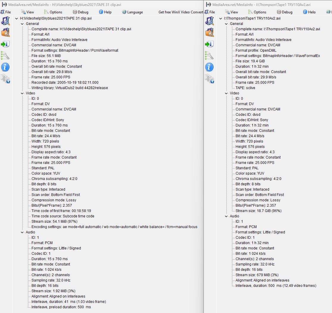

    Thanks Alwyn. I captured mine with WinDV then I saved them to a separate drive from my OS. Then with the help of everyone here I was eventually able to do a simple script and encode with Virtualdub 2. I haven't done anything else to the files I haven't changed any codec, maybe I should have? Hopefully I'm doing everything correct but it does seem odd they are unreadable in your system.
  18. The only significant difference I see is a lack of an ODML extension header on SkyBlues2021's file. If that's the problem it's a bug in your software. AVI files less than 4 GB (some programs use 2 GB as the limit) don't require an ODML header.
    By the way, VirtualDub adds ODML headers once the output AVI file exceeds 2 GB. It has an option to change that threshold to 1 GB.

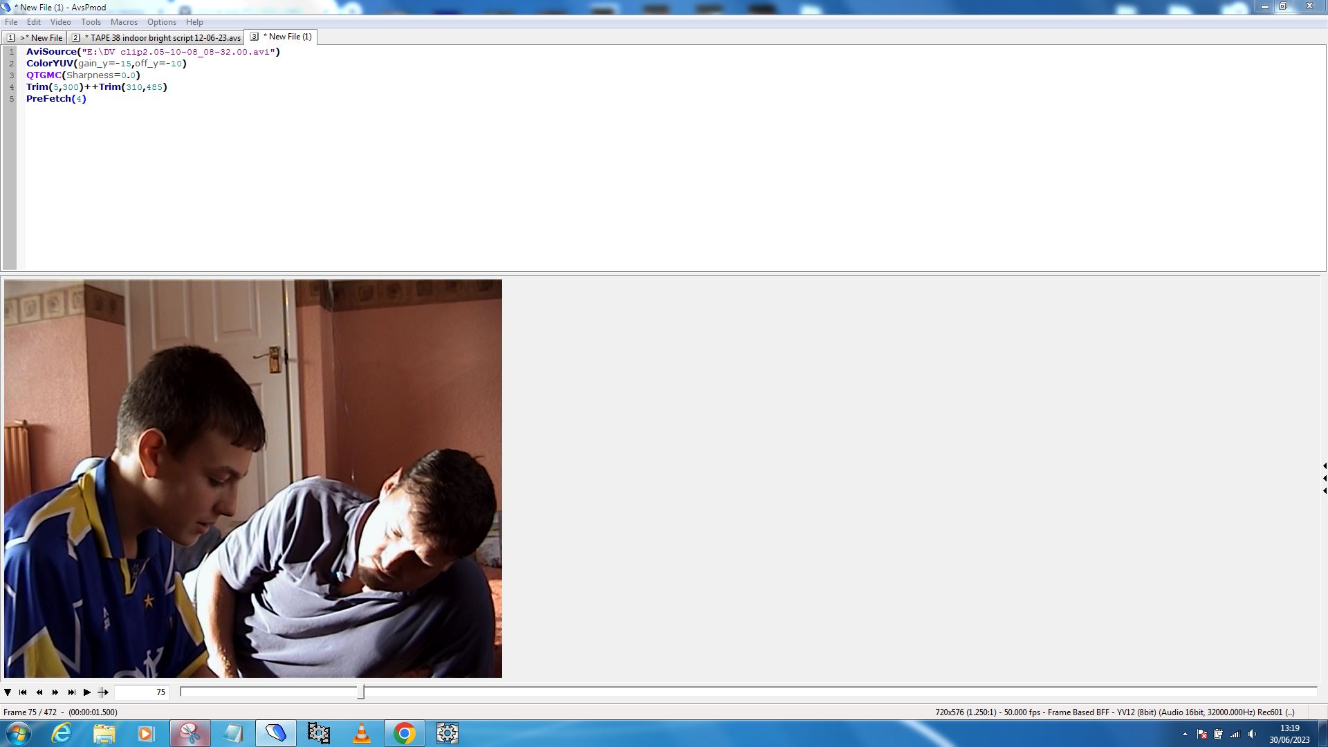

    I need to trim one of my DV AVI files but I wasn't sure of the placement of trim in my script as I've previously only used trim on interlaced scripts. I didn't know if it went before or after QTGMC. Also is ++ better than + for trim. Thanks.
Name:	trim placement.JPG
  22. You can Trim() anywhere you want. But keep in mind that QTGMC doubles the number of frames. So Trim(5, 300) would equate to Trim(2.5, 150) if you did it before QTGMC. But Trim only supports integers so you would have to Trim(2,150) or Trim(3,150), the nearest options. The resulting video will have one extra field, or one fewer fields (frames after QTGMC).

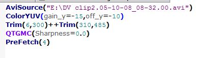

  24. I think you still don't understand. The trim numbers are the frame numbers at the point in the script at which trim is called, not the original frame numbers. After QTGMC you have twice as many frames as before it. So if you had 500 frames in the original video (frames numbered 0 to 499) you have 1000 frames after QTGMC (frames numbered 0 to 999). After QTGMC there's no reason you can't trim at odd frame numbers.
  25. Member
    Sep 2021
    Thanks jagabo. Just when I thought I understood I don't! Sorry, I can now see what I did wrong with my Trim, it should have been Trim(3,150)++Trim(155,242) if I did it before QTGMC. But if I did it after QTGMC would I then have to save the script watch it and find the new frames to cut after it's been deinterlaced or would it be Trim(12,600)++Trim(620,970) Sorry if this sounds crude. Thanks.
  26. Originally Posted by SkyBlues2021 View Post
    I believe that's the case but haven't seen what your doing. I'll take your word that 3-150 and 155-242 are the portions of the original video you want to keep.
    No the frame numbers are doubled after QTGMC. So you trims would be 6 to 300 and 310 to 484.
    Actually, I forgot about this earlier, but the last frame numbers aren't right, they should be 301 and 485. Consider a cut list from frames 0 to 1. That's two frames before QTGMC, 0 and 1 , and will become four frames after, 0, 1, 2, 3. The last number of the trim has to be the second value from before the trim times two, plus 1. To get exactly the same sequence. Ie, Trim(0,2) is only three frames. You need Trim(0,3) to get all four.
    For checking frame numbers after QTGMC you can open the script in an editor that supports AVS as input and shows frame numbers -- like VirtualDub (the original or version 2). Then go through the video and decide where you want to cut (VitualDub shows you the frame numbers, or you can use ShowFrameNumber() in your script (after QTGMC) to stamp frame numbers onto the frames). This has the advantage of being able to cut at any field (now a frame). Finally, add the Trim after QTGMC with the frame numbers you got. Since QTGMC is slow I often use Bob() while doing this. Then change to QTGMC when I'm ready to render (with one last check to be sure).
    Of course, if you already have a cut-list without QTGMC you should probably just go with it and Trim before QTGMC.

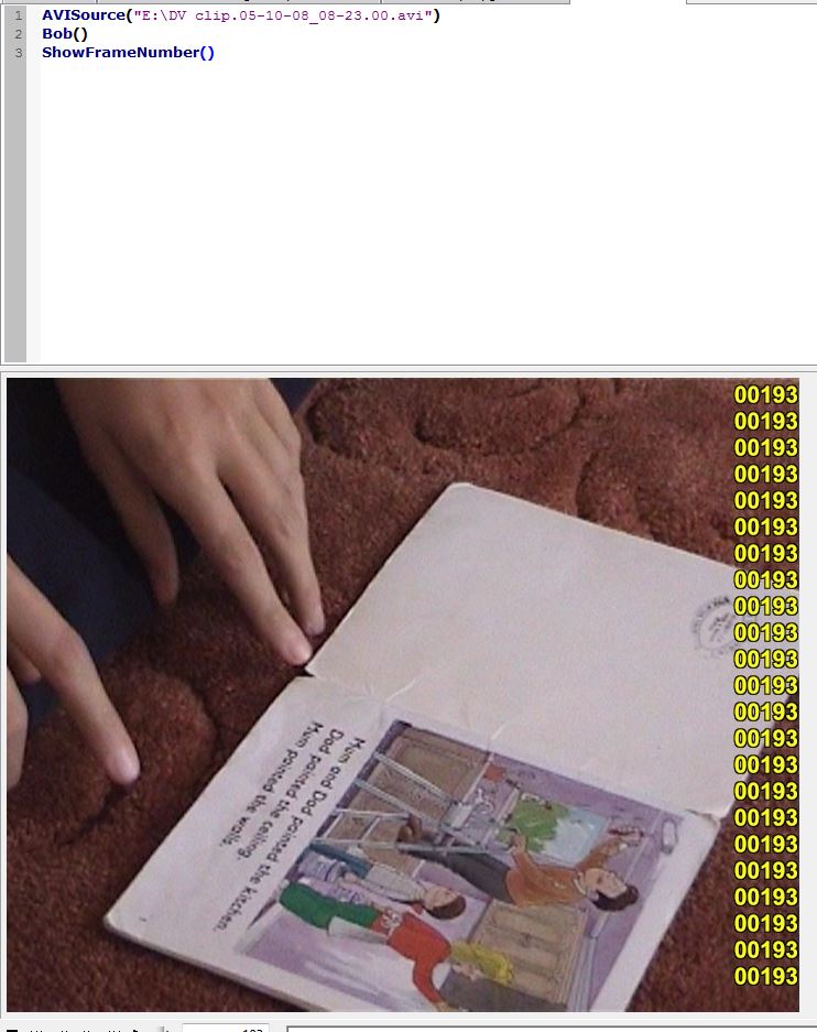

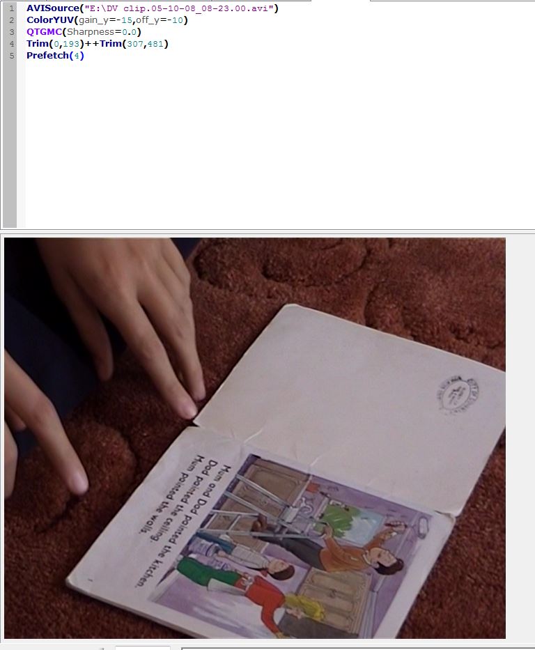

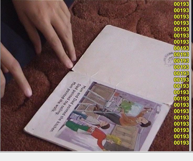

  29. Member
    Sep 2021
    Thanks jagabo. Hopefully this time I've got it correct. My cut reference point is when my sons fingers leave the book and it starts again when his chin appears in the left hand corner. Thanks.
Name:	Bob script.JPG
Name:	trim after QTGMC.JPG
Name:	Bob virtualdub2.JPG
  30. That looks right. I first see his chin at frame 306. But you can start anywhere you want.
