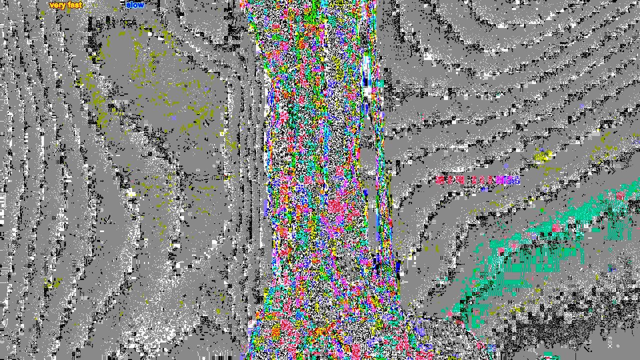

  17. FWIW here a script which I sometimes use for comparing variants on the PC, by stepping through the frames:
    original=LWLibavVideoSource("original.mkv").subtitle("original")
    v1=LWLibavVideoSource("very fast.mkv").subtitle("                     very fast")
    v2=LWLibavVideoSource("slow.mkv").subtitle("                                                        slow")
    #outputs for comparison:
    out01=interleave(original,v1)
    out02=interleave(original,v2)
    out012=interleave(original,v1,v2)
    out12=interleave(v1,v2)
    outdelta01=subtract(original,v1).Levels(127, 1, 129, 0, 255)  #plain gray means no difference
    outdelta02=subtract(original,v2).Levels(127, 1, 129, 0, 255)  #plain gray means no difference
    outdelta0102=interleave(outdelta01,outdelta02)
    #select the output from the out* list above:
    return out12
    .... I just can't see it. Can you post a frame number and area to look for it?
    All flat dark backgrounds. Using the (modified) script above for highlighting the differences between the 2 encodes, the banding contours pop up, e.g. around frame 380:
    [Attachment 69520 - Click to enlarge]
    P.S. If you can't see the banding of the "Very Fast" encode at all, you might have to readjust brightness, contrast, saturation .... of your TV. Maybe the banding is just masked (drowned in black).
