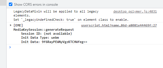

  3. yes, i know that
    but tampermonkey can't find real pssh. but only short and wrong pssh
    useless to get the key. need to be convert some value, but not idea wich one ...

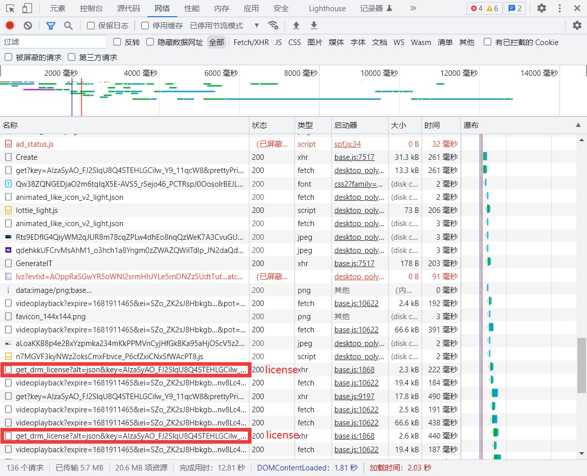

    about your post#30 to find lic url simply search "lic"
    but need also pssh to get the key ...

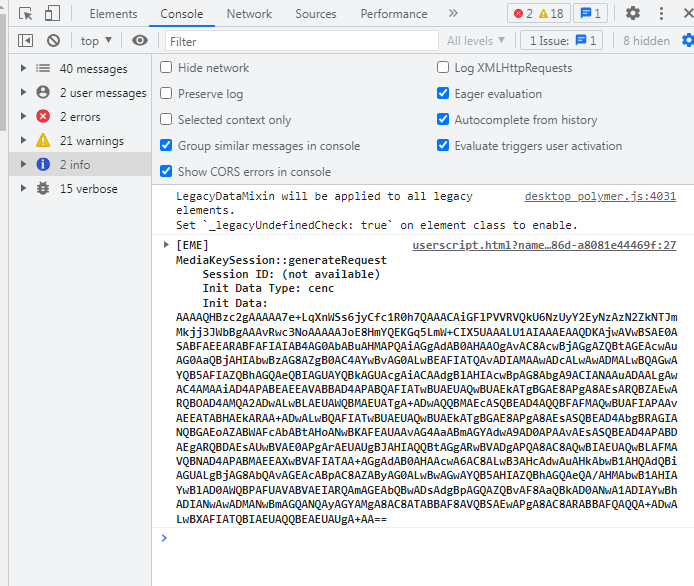

  8. holy shit
    today after LZZA post (thanks LZZA for your post) eme can found the right pssh ... weird
    [Attachment 70307 - Click to enlarge]
    so, from this long pssh:
    AAAAQHBzc2gAAAAA7e+LqXnWSs6jyCfc1R0h7QAAACAiGFlPVVRVQkU6NzUyY2EyNzAzN2ZkNTJmMkjj3JWbBgAAAvRwc3NoAAAAAJoE8HmYQEKGq5LmW+CIX5UAAALU1AIAAAEAAQDKAjwAVwBSAE0ASABFAEEARABFAFIAIAB4AG0AbABuAHMAPQAiAGgAdAB0AHAAOgAvAC8AcwBjAGgAZQBtAGEAcwAuAG0AaQBjAHIAbwBzAG8AZgB0AC4AYwBvAG0ALwBEAFIATQAvADIAMAAwADcALwAwADMALwBQAGwAYQB5AFIAZQBhAGQAeQBIAGUAYQBkAGUAcgAiACAAdgBlAHIAcwBpAG8AbgA9ACIANAAuADAALgAwAC4AMAAiAD4APABEAEEAVABBAD4APABQAFIATwBUAEUAQwBUAEkATgBGAE8APgA8AEsARQBZAEwARQBOAD4AMQA2ADwALwBLAEUAWQBMAEUATgA+ADwAQQBMAEcASQBEAD4AQQBFAFMAQwBUAFIAPAAvAEEATABHAEkARAA+ADwALwBQAFIATwBUAEUAQwBUAEkATgBGAE8APgA8AEsASQBEAD4AbgBRAGIANQBGAEoAZABWAFcAbABtAHoANwBKAFEAUAAvAG4AaABmAGYAdwA9AD0APAAvAEsASQBEAD4APABDAEgARQBDAEsAUwBVAE0APgArAEUAUgBJAHIAQQBtAGgARwBVADgAPQA8AC8AQwBIAEUAQwBLAFMAVQBNAD4APABMAEEAXwBVAFIATAA+AGgAdAB0AHAAcwA6AC8ALwB3AHcAdwAuAHkAbwB1AHQAdQBiAGUALgBjAG8AbQAvAGEAcABpAC8AZAByAG0ALwBwAGwAYQB5AHIAZQBhAGQAeQA/AHMAbwB1AHIAYwBlAD0AWQBPAFUAVABVAEIARQAmAGEAbQBwADsAdgBpAGQAZQBvAF8AaQBkAD0ANwA1ADIAYwBhADIANwAwADMANwBmAGQANQAyAGYAMgA8AC8ATABBAF8AVQBSAEwAPgA8AC8ARABBAFQAQQA+ADwALwBXAFIATQBIAEUAQQBEAEUAUgA+AA==
    decoded is that:
    AAAAQHBzc2gAAAAA7e+LqXnWSs6jyCfc1R0h7QAAACAiGFlPVVRVQkU6NzUyY2EyNzAzN2ZkNTJmMkjj3JWbBg==
    and me too i've found same keys to stabbedbybrick post

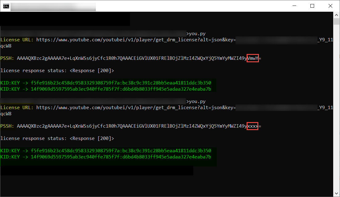

  10. i've get keys with edited script. python script. not trough getwvkeys
    and what headers ? no need headers

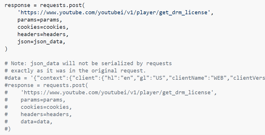

    I saw this note when converting the cURL to Python on curlconverter.com
    [Attachment 70325 - Click to enlarge]
    So when it says json_data will not be serialized by requests exactly as it was in the original request, what should I do? (It is a bit different from those in normal situations)

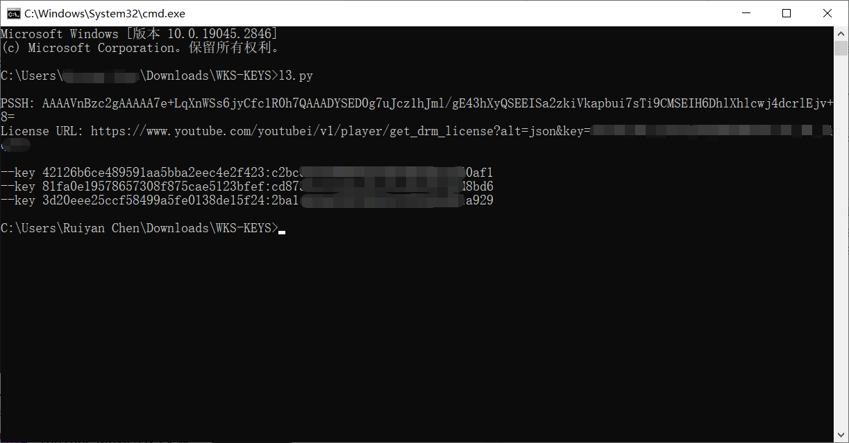

    I used WKS-KEYS to get the content keys, and I modified the original one, uploaded it to GitHub for convenience.
    Would anyone have a look at my code, for when I ran the .py program, it said "you should generate a license first"...
    URL hidden by user
    I have pasted all the things includin' cookies, headers, params and json_data to the headers.py in the WKS-KEYS.
    Much appreciated.
    Should it be
    response = requests.post(
        'https://www.youtube.com/youtubei/v1/player/get_drm_license',
        params=params,
        cookies=cookies,
        headers=headers,
        json=json_data,
    Or should it be like this:
        params=params,
        cookies=cookies,
        headers=headers,
        data=data,

  25. Originally Posted by LZAA View Post
    https://www.youtube.com/watch?v=dSyicDf9UvI
    PSSH:
    AAAAQHBzc2gAAAAA7e+LqXnWSs6jyCfc1R0h7QAAACAiGFlPVV RVQkU6NzUyY2EyNzAzN2ZkNTJmMkjj3JWbBgAAAvRwc3NoAAAA AJoE8HmYQEKGq5LmW+CIX5UAAALU1AIAAAEAAQDKAjwAVwBSAE 0ASABFAEEARABFAFIAIAB4AG0AbABuAHMAPQAiAGgAdAB0AHAA OgAvAC8AcwBjAGgAZQBtAGEAcwAuAG0AaQBjAHIAbwBzAG8AZg B0AC4AYwBvAG0ALwBEAFIATQAvADIAMAAwADcALwAwADMALwBQ AGwAYQB5AFIAZQBhAGQAeQBIAGUAYQBkAGUAcgAiACAAdgBlAH IAcwBpAG8AbgA9ACIANAAuADAALgAwAC4AMAAiAD4APABEAEEA VABBAD4APABQAFIATwBUAEUAQwBUAEkATgBGAE8APgA8AEsARQ BZAEwARQBOAD4AMQA2ADwALwBLAEUAWQBMAEUATgA+ADwAQQBM AEcASQBEAD4AQQBFAFMAQwBUAFIAPAAvAEEATABHAEkARAA+AD wALwBQAFIATwBUAEUAQwBUAEkATgBGAE8APgA8AEsASQBEAD4A bgBRAGIANQBGAEoAZABWAFcAbABtAHoANwBKAFEAUAAvAG4AaA BmAGYAdwA9AD0APAAvAEsASQBEAD4APABDAEgARQBDAEsAUwBV AE0APgArAEUAUgBJAHIAQQBtAGgARwBVADgAPQA8AC8AQwBIAE UAQwBLAFMAVQBNAD4APABMAEEAXwBVAFIATAA+AGgAdAB0AHAA cwA6AC8ALwB3AHcAdwAuAHkAbwB1AHQAdQBiAGUALgBjAG8AbQ AvAGEAcABpAC8AZAByAG0ALwBwAGwAYQB5AHIAZQBhAGQAeQA/AHMAbwB1AHIAYwBlAD0AWQBPAFUAVABVAEIARQAmAGEAbQBwAD sAdgBpAGQAZQBvAF8AaQBkAD0ANwA1ADIAYwBhADIANwAwADMA NwBmAGQANQAyAGYAMgA8AC8ATABBAF8AVQBSAEwAPgA8AC8ARA BBAFQAQQA+ADwALwBXAFIATQBIAEUAQQBEAEUAUgA+AA==
    I know this is a weird question ,but do you think youtube cares about the pssh ?
    The following was tested using a pssh and i made a small change in the pssh and requested again :
    [Attachment 70424 - Click to enlarge]
    weird right ? different pssh and still the same keys , do you think youtube only cares about "videoId" ?
    Regards

    Really appreciate it. Finally made it by trying on my own.
    [Attachment 70425 - Click to enlarge]
    However, may I ask which is the manifest...
    [Attachment 70426 - Click to enlarge]
