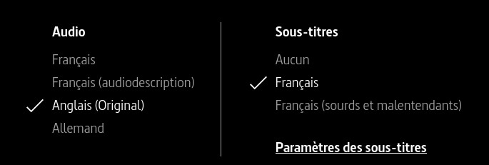

    There are several versions of French subtitles. One version is for "Sourds et Malentendants" (deaf and hearing-impaired).
    With the "fr" option, the system retrieves only the subtitles for the "Sourds et Malentendants".

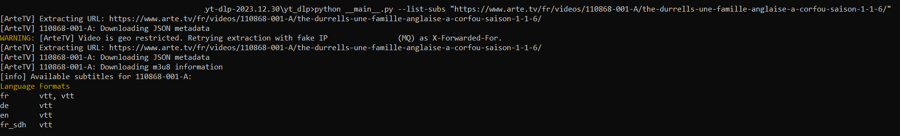

  3. yt-dlp --list-subs "https://www.arte.tv/fr/videos/110868-001-A/the-durrells-une-famille-anglaise-a-corfou-saison-1-1-6/"
    [ArteTV] Extracting URL: https://www.arte.tv/fr/videos/110868-001-A/the-durrells-une-famille-anglaise-a-corfou-saison-1-1-6/
    [ArteTV] 110868-001-A: Downloading JSON metadata
    WARNING: [ArteTV] Video is geo restricted. Retrying extraction with fake IP 185.212.73.110 (BL) as X-Forwarded-For.
    [ArteTV] 110868-001-A: Downloading m3u8 information
    [info] Available subtitles for 110868-001-A:
    Language Formats
    fr vtt, vtt
    fr-acc vtt
    de vtt
    en vtt
    Feb 2024
    Paris
    I don't have the same behaviour:
    Language Formats
    fr vtt, vtt, vtt
    de vtt
    en vtt
    Does fr-acc is for "Sourds et malentendants" ?
    What's your version ?
