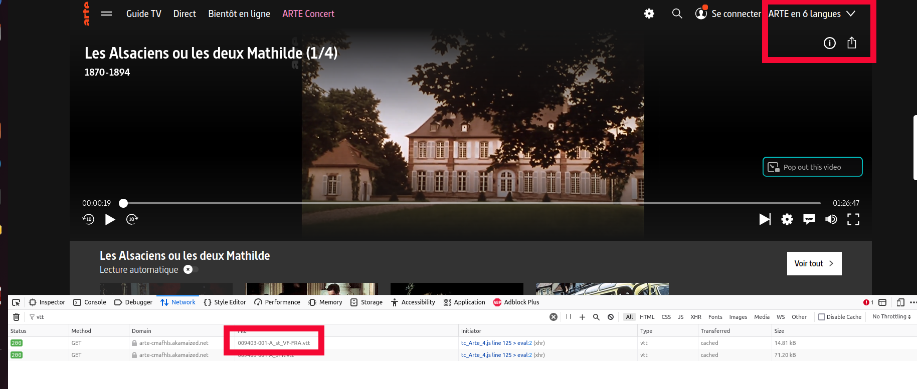

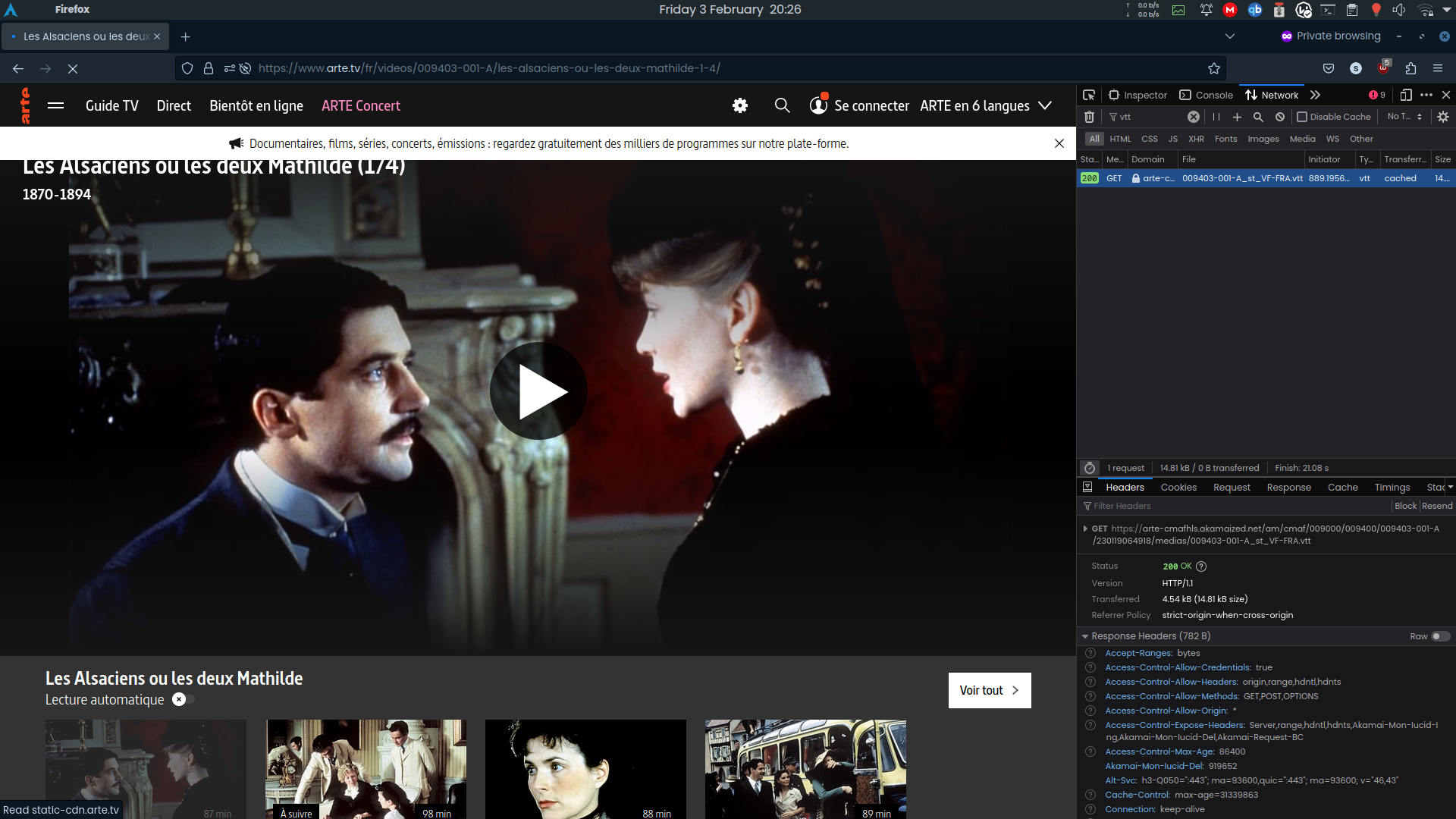

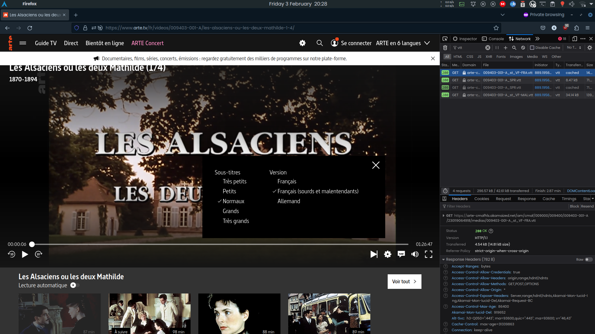

  4. i assume that you want the french forced subtitles that only show during german dialogue.
    if so, in the browser player when you change the subtitle it downloads a whole new m3u8 manifest with only 1 subtitle defined.
    yt-dlp grabs all 3 m3u8 manifests via the arte extractor but the problem is that yt-dlp assumes the forced french subs are duplicate and there doesnt seem to be an option to choose that particular one.
    heres a workaround:
    - open devtools in the browser
    - play the video
    - choose the subtitles that you want
    - go to dev tools - network tab
    - filter on "XQ"
    - copy the link to the last one
    - download it with yt-dlp or n_m3u8dl-re
    ie.
    yt-dlp --skip-download --write-subs "https://arte-cmafhls.akamaized.net/am/cmaf/009000/009400/009403-001-A/230119064918/009403-001-A_VOF-STF_XQ.m3u8"

    You may need to look the dev console and search for m3u8
    there are 3 top level m3u8s on the page
    009403-001-A_VOF-STMF_XQ.m3u8
    009403-001-A_VA-STA_XQ.m3u8
    the sub file you are looking for is
    Or in the dev console ,find the sub entry and curl it
    curl -o VF-FRA.vtt https://arte-cmafhls.akamaized.net/am/cmaf/009000/009400/009403-001-A/230119064918/medias/009403-001-A_st_VF-FRA.vtt
    resulting file is 14.5kb

    Alas, you've no choice but to do it this way, ARTE don't flag the subtitle files correctly for yt-dlp to get it. But, based on the m3u8 listed above you might be able to intuit a script.
    BTW, when the page loads, the VOF-STF.vtt get loaded into the buffer. (You'll see it load in Dev-tools. The others load on request.)
    For future reference
    VOF-STMF --> Full French
    VOF-STA --> Full German Subtitles
    VOF-STF -- French subtitles for German spoken parts.
    As for merging, MP4box, ffmpeg of mkvmerge will do it easily.
    Well ... in my case (Ubuntu, Mozilla Firefox) it happens differently: when I use filter "vtt" in Network tab the ONLY vtt appears, and this vtt is the "GOOD" one.
    I don't see any other subtitles you listed ... VOF-STMF, VOF-STA, etc., but for me it's Ok.
    The problem is how to do implement this in some way in Python script.
    As you reasonably mentioned, that's impossible.
    Concerning merging tools, I'm aware of them and use mkvmerge.
    It works just fine.
    But again, the reason I posted my request is if Python automation is possible.
    And the answer that emerges from the discussion is "No".
    Although negative, it is an answer anyway.
    Sincerely,

    I'm sure there is a python module to pull the streams, take a look at Beautiful soup or webvtt.py
    I'm sure other user more au fait with python could point you in the right direction. My python-fu is too damn rusty.
    Edit:
    And in my case (Arch, firefox) dev console in network and vtt found the initial vof-sta subs. Selecting the others would load them.
    initial page load
    [Attachment 69038 - Click to enlarge]
    playing video and selecting alternative subs
    [Attachment 69039 - Click to enlarge]
