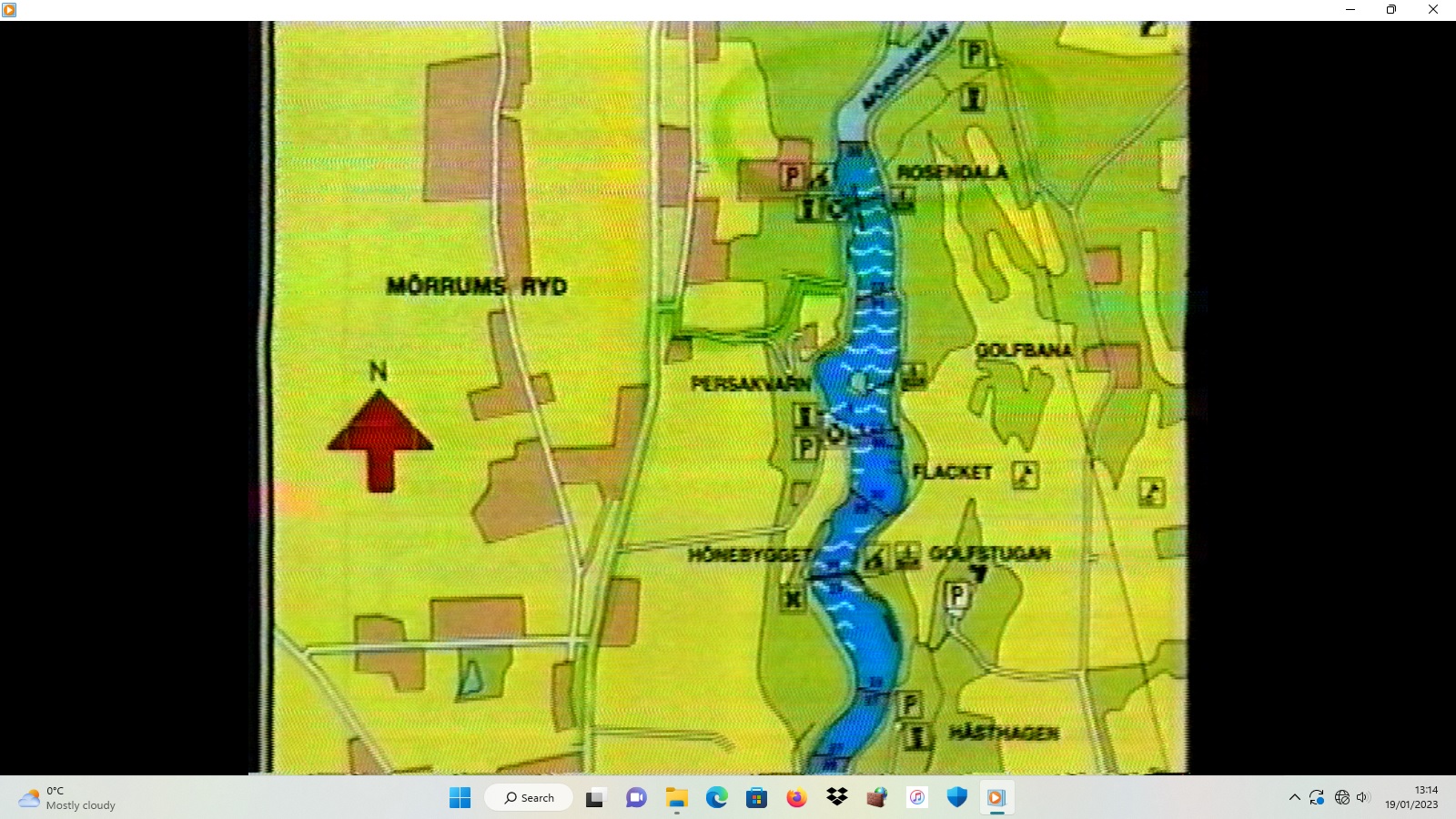

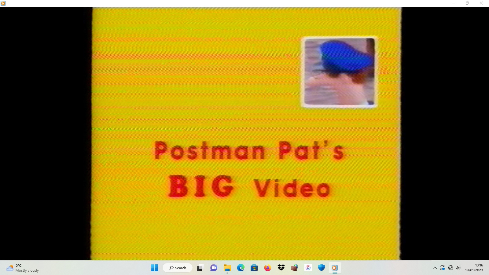

    I've finished converting my minidv tapes now and I'm really happy with the final results. I had a play around with deinterlacing them in handbrake but they didnt seem to look right so I deinterlaced them in virtualdub. I think it did a much better job, they look really good (to my untrained eye, anyway). I then converted them to mp4 in handbrake but have kept the original avi files also.
    Now I'm back to converting the box of vhs tapes that I have and its not going nearly so well, the capture looks awful to be honest.
    Elgato video capture cards were half price just before christmas so I purchased one and am using that. My vcr is just a two head Hitachi and I havent been using a tbc. I know that I'm not going to get great capture with this equipment but I wanted to have a play around and get the hang of using virtualdub before splashing out and upgrading everything.
    Like I said, I know that the capture wasnt going to be perfect but I didnt expect it to be this bad, the cheap hdmi dongle did a better job in obs.
    Ive taken some screen shots and was wondering if you guys could have a look?
    There is what looks like patterened lines going across the screen, just wondering if you could let me know what is causing this?

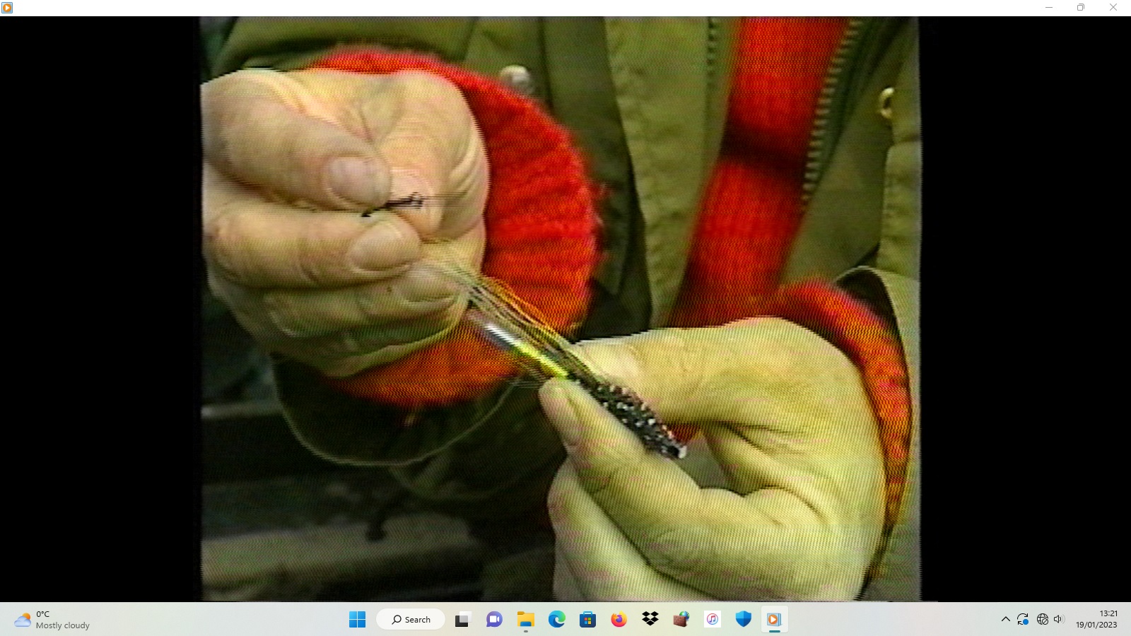

  27. One more screenshot, also I forgot say that there has been no dropped frames or audio syncing problems so far.

    It's hard to tell from a screen grab, Looks like dot crawl or interference, This is typical when using low end VCR via non-coaxial composite cable, Try a different cable and move the VCR to an area where you don't have signal interference.
  29. Agree, looks definitely like dotcrawl AND possibly interference. If your VCR has an S-video output use it instead of Composite or SCART to connect it to the capture dongle. If not, use a recommended Panasonic DVD recorder in passthrough which will provide better luma/chroma separation (comb filter). There are plenty of threads and posts about this subject.
