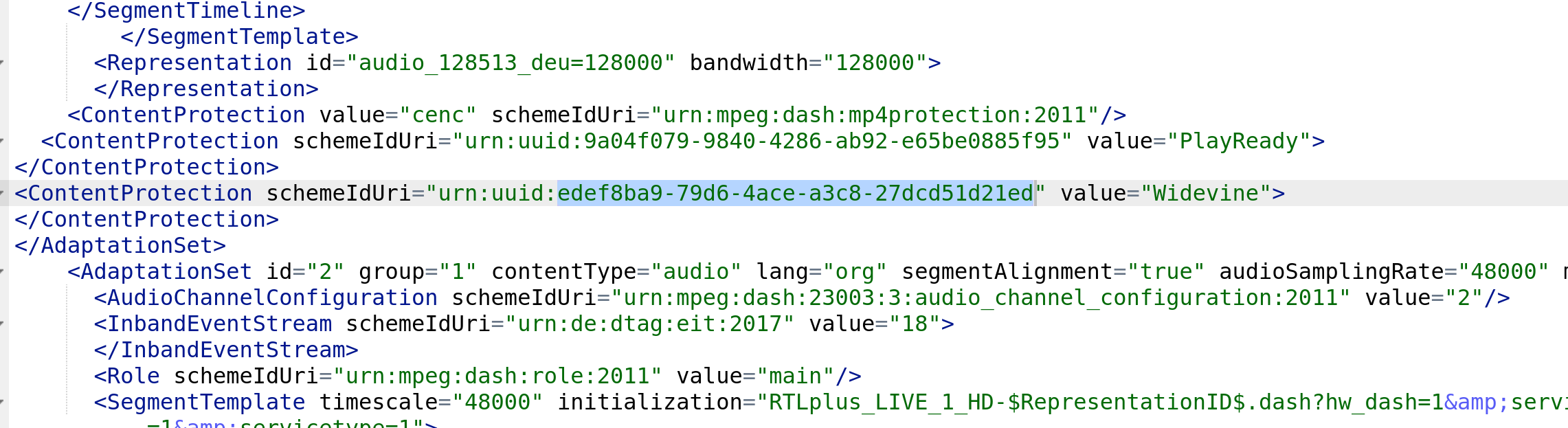

    [Attachment 67279 - Click to enlarge]
    Display the results from the mpd. I use curl 'mpd-url'. Or put it in a browser. Select the highlighted UUID - note the full line at the end says Widevine.
    Then decode with a python routine. I took this from part of a Notaghost program so thanks to Ghost we have this:-
    import base64
    def get_pssh(keyId):
        array_of_bytes = bytearray( b'\x00\x00\x002pssh\x00\x00\x00\x00')
        array_of_bytes.extend(bytes.fromhex("edef8ba979d64acea3c827dcd51d21ed"))
        array_of_bytes.extend(b'\x00\x00\x00\x12\x12\x10')
        array_of_bytes.extend(bytes.fromhex( keyId.replace("-", "")))
        return base64.b64encode(bytes.fromhex(array_of_bytes.hex()))
    kid = input("Please input KID in hex string: ")
    kid = kid.replace('-', '')
    assert len(kid) == 32 and not isinstance(kid, bytes), "wrong KID length"
    print("PSSH {}".format(get_pssh(kid).decode('utf-8')))
    When run the above routine produces:-
    PSSH AAAAMnBzc2gAAAAA7e+LqXnWSs6jyCfc1R0h7QAAABISEO3vi6l51krOo8gn3NUdIe0=
    which should match what whatshisface said,
    I cannot check it works as I am geo-locked.
