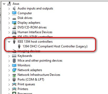

In Device Manager on your laptop, check you have Firewire recognised by Windows, like this (this is win 10 but IIRC Win 7 was similar):
[Attachment 67081 - Click to enlarge]
If not, try re-installing the Win 7 Firewire driver:
https://avid.secure.force.com/pkb/articles/en_US/troubleshooting/en370145
When that's done, try using WinDV or Scenalyzer
For the Win 10 machine, install the Firewire driver as per this:
https://www.startech.com/en-us/faq/firewire-cards-windows-legacy-driver-swap
and then try with WinDV or Scenealzer -
