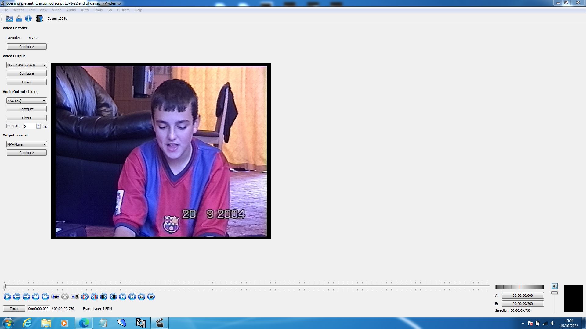

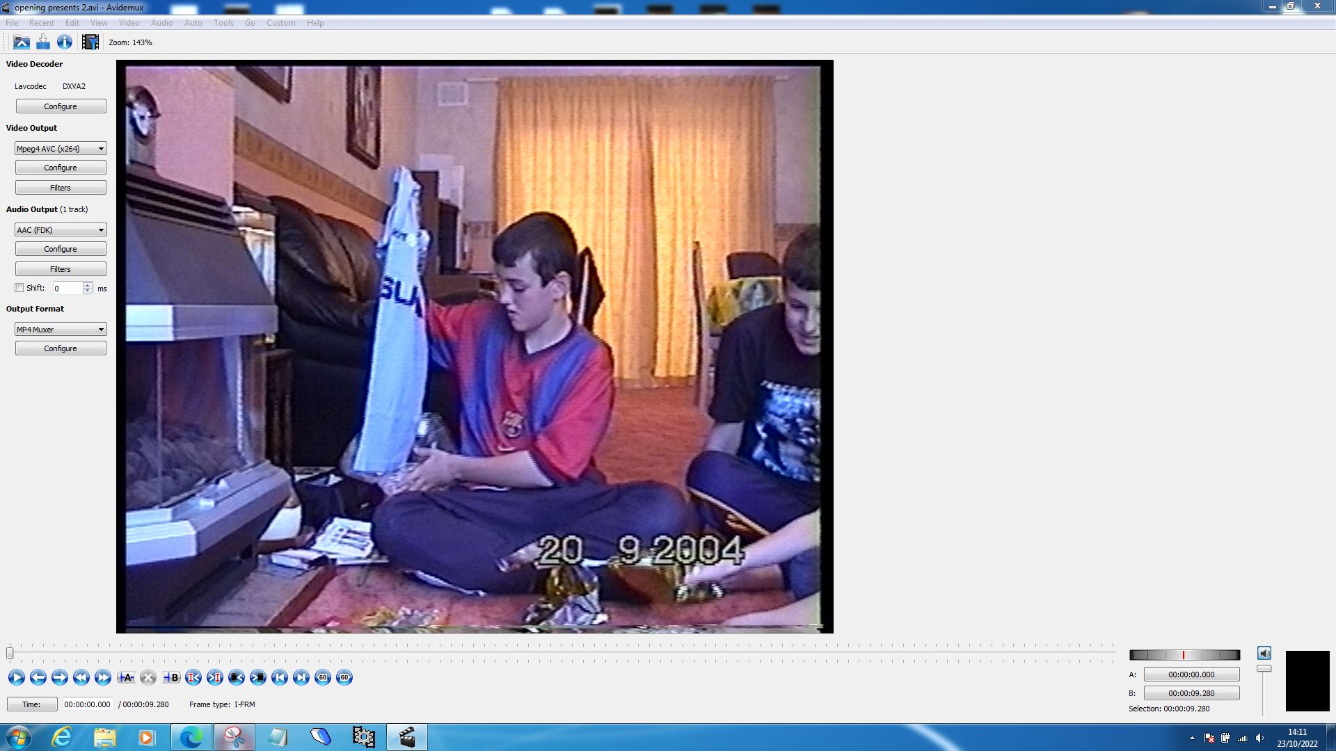

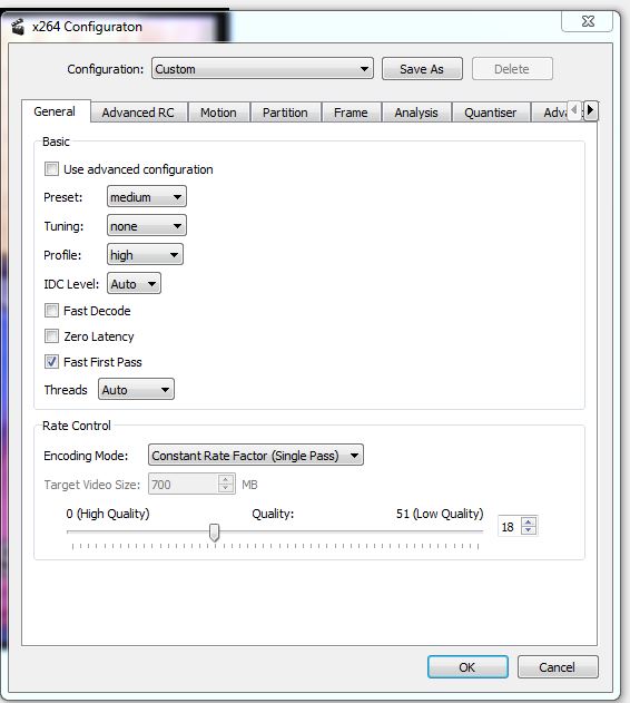

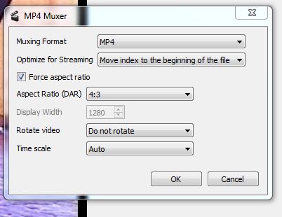

    I've had my first attempt at encoding with Avidemux and I will attempt Virtualdub2 next. I would be grateful for any advice.
    I haven't restored, deinterlaced or cropped anything I really just wanted to look at a capture I've done on my smart tv.
    I'm hoping I've followed jagabo's advice correctly, I chose MPEG 4 AVC.
    In custom configuration I chose Constant Rate Factor (single pass) (not sure if it should have been Constant Quantizer) and I set the quality slider to 18 or should this be 0 highest quality? All the other configure tabs everything was greyed out except for the frame tab which would allow you to change the GOB size, I didn't change this.
    I set the audio to AAC (Lav) I'm unsure if the (lav) part is correct, (FDK) was the other option. I didn't change any other settings in audio.
    For the output format I chose MP4 muxer. On configure I ticked the Force aspect ratio box and set it to 4:3.
    I then saved the new video which is 9.64MB the original being 91.8MB

    The avidemux video encodes the interlaced frames as progressive @ 25fps which causes the two fields to be
    mashed together. This is not the way to proceed. If you want progressive, use some kind of double rate de-interlacing
    and create video at 50fps

    Constant quantizer is a mathematically constant quality type of encoding. Constant Rate Factor is also a constant quality encoding but it takes into account what the human eye is more sensitive to. You usually want to use CRF as it gives better quality per bitrate.
    Around CRF=18 is pretty good quality (you won't see much difference between the original and encoded videos at normal playback speed) for video you will be watching -- a good compromise between visual quality and file size. CRF=12 is very high quality (you will barely see any difference when A/B switching between individual frames with a magnifier) but will deliver 2x or 3x larger files. CRF=0 is lossless encoding. Quality will be the same as the source (if nothing else has changed the video) but the file size will be very large, almost as large as your huffyuv source. Higher CRF values will give lower quality and smaller files.
    They are greyed out because you didn't enable the "Use advanced configuration" option on the General tab. Unfortunately, once you enable that you must adjust all the other settings yourself. I don't really use AviDemux. The version I have is a few years old. I don't consider any of the x264 Configuration presets in that version adequate. Maybe there's some more in newer versions? Look for Slow or Slower options in yours.
    The biggest problem with your encoded video is that it contains interlaced frames but it's encoded progressive. You should either encode interlaced (it's on the Frame tab of the x264 configuration dialog, and should be set to Interlaced, Top Field First) or deinterlace and encode progressive. To deinterlace you add one of the deinterlace filters from the Filters -> Interlacing dialog. In the version I have Yadif (field : Temporal and spatial check, Top field first) is the best option. Look for BWDIF or QTGMC in newer versions of the program. BWDIF is better than Yadif, QTGMC is the best. It probably won't have QTGMC as that's a very complex AviSynth specific filter.

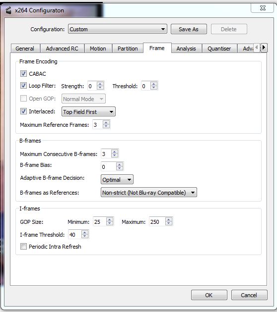

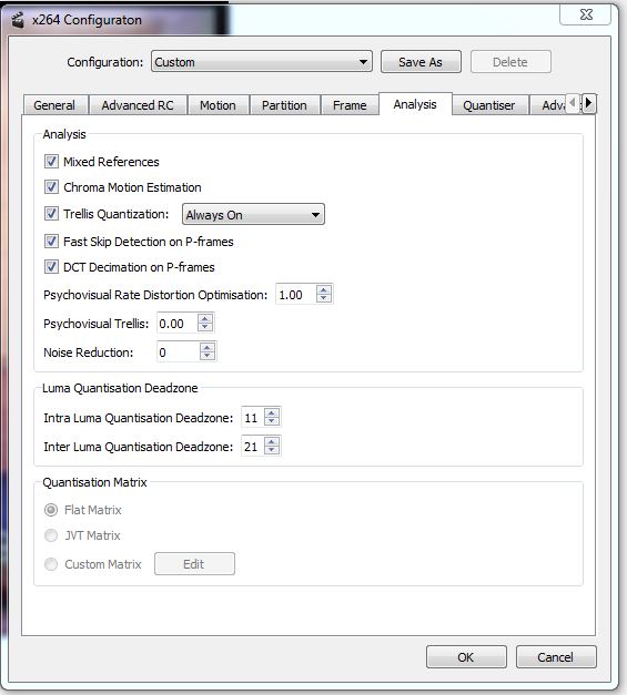

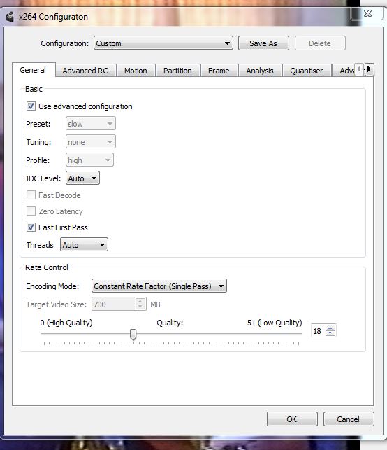

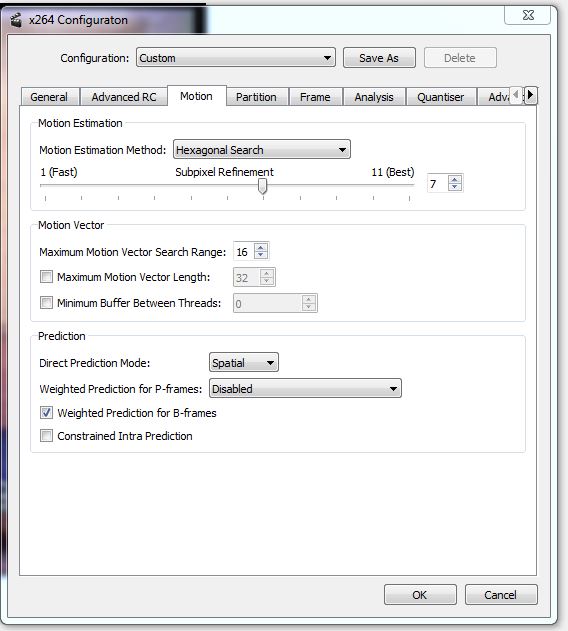

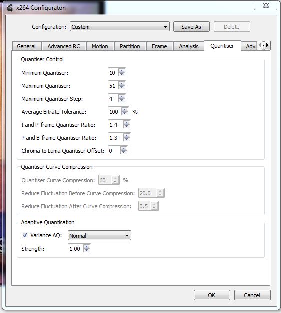

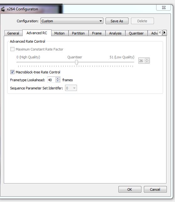

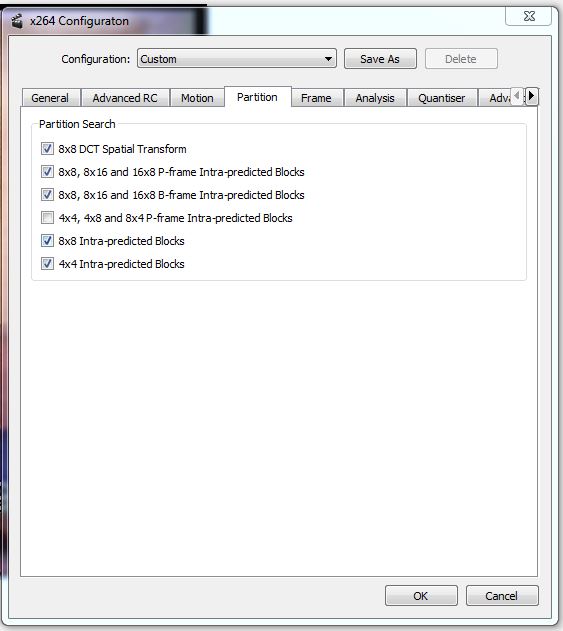

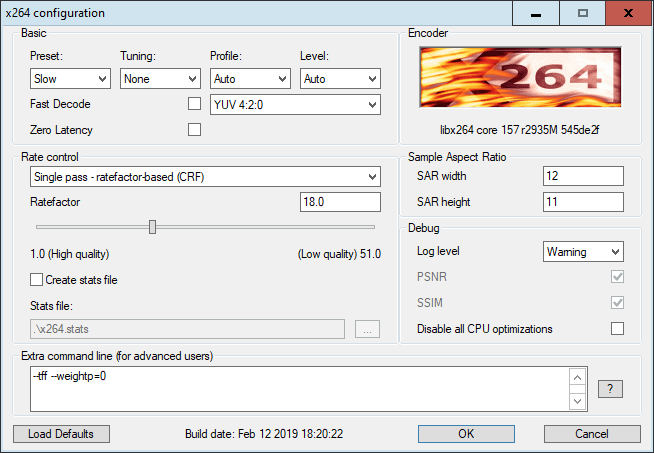

    I've changed some settings using jagabo's instructions and the Avidemux h.264 tutorial hopefully my encoded clip is better. I've attached all the relevant tabs and the original and encoded clip.
    I didn't configure the video decoder and left it unchecked.
    General tab: I chose preset> slow I'm guessing this is what jagabo meant regarding slow or slower options? once I ticked "use advance configuration" preset> slow became greyed out and I wasn't sure if this setting then became redundant?
    Advanced RC tab: I left it as default. I wasn't sure if I should increase the value on the frametype lookahead?
    Motion tab: I left it as Hexagonal search. I wasn't sure if most people use the better quality "uneven Hexagonal search" also should I adjust the slider to 11(Best)
    I disabled the "weighted prediction for P- frames as the guide said it could cause distorted video.
    Partition tab: I checked both the 8x8, 8x16 and unchecked 4x4, 4x16 as per the Avidemux tutorial
    Frame tab: I checked the interlaced and TFF.
    Adaptive B-frame decision: I changed to optimal
    B-frame as reference: I left at Non-strict (not blu-ray compatible)
    GOP size: I left at default which I think is ok for PAL
    Analysis tab: I only changed the Trellis Quantization to "Always On"

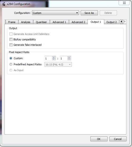

    Output 1 tab: I left this at Pixel aspect ratio: custom 1:1 I wasn't sure if I should have changed this to Predefined Aspect Ration 16:15 (PAL 4:3)?
    I'm using Avidemux 2.8.1
    Sorry for all the questions any advice would be grateful. thanks.

  18. It's unfortunate that AviDemux force you to choose between x264 presets or full manual control. Some other programs that use x264 let you choose a preset and then add modify individual options as necessary (VirtualDub2 for example). This post has a list of individual settings for each preset:
    https://forum.videohelp.com/threads/406282-X264-encoding-Comprehensive-questions-about...ty#post2661941
    I suggest that you try to replicate the settings that correspond to the slow preset. Except when you're encoding interlaced you need to add the interlace/tff option.

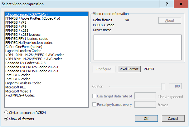

    Thanks jagabo. I downloaded virtualdub2 today. Could you suggest any external encoders as I couldn't find any built into virtualdub2.
    I will take your advice and try that encoder instead. Thanks.
  20. Vidoeo -> Compression... should give you a list of encoders from which to choose:
    [Attachment 67354 - Click to enlarge]
    You won't have all of those because I installed a few VFW encoders. But the x264 8 bit encoder should be there.
  21. Menu Video->Compression..... (or Ctrl P) opens a menu with a list of internal encoders. Select for example x264 8-bit and press the Configure button.
    Edit: jagabo was faster
  22. By the way, with the x264 dialog in VirtualDub2 you only have a few GUI controls. The rest you have to enter as command line options:
    [Attachment 67355 - Click to enlarge]
    some helpful x264 references:
    https://en.wikibooks.org/wiki/MeGUI/x264_Settings
    http://www.chaneru.com/Roku/HLS/X264_Settings.htm

    "G:\program files\ffmpeg64\bin\ffmpeg.exe" -i %1 -c:v libx264 -crf 17 -preset slow -aspect 4:3 -flags +ilme+ildct -x264opts tff -c:a aac -b:a 128k "%~dpn1_tff.mp4"
    pause
    Or deinterlace and encode progressive by using "-vf bwdif=mode=1arity=0" between the input and the libx264 specs.
    "G:\program files\ffmpeg64\bin\ffmpeg.exe" -i %1 -vf bwdif=mode=1:parity=0 -c:v libx264 -crf 17 -preset slow -aspect 4:3 -c:a aac -b:a 128k "%~dpn1_bwdif.mp4"
    pause
