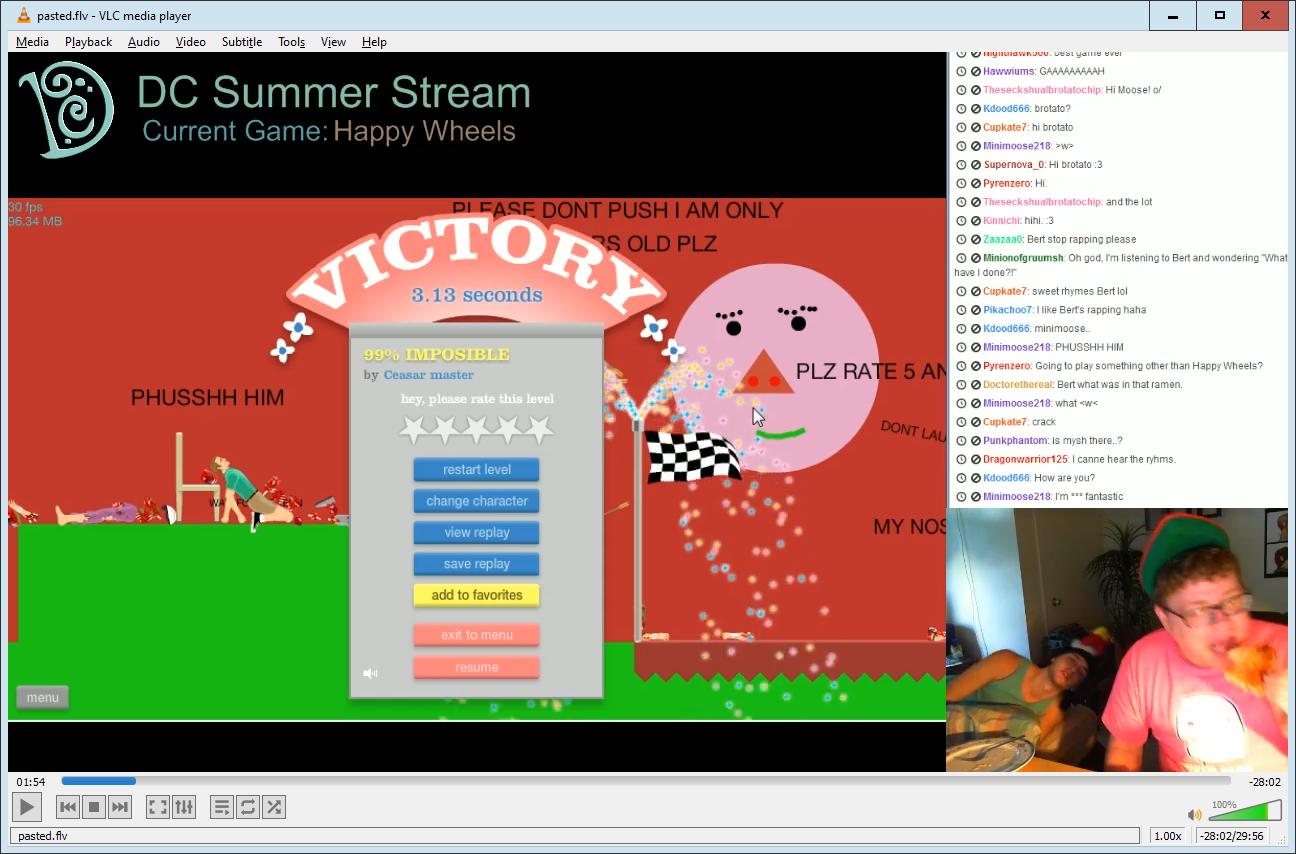

In a hex editor you can see that there is missing metadata at the start of the non-working file. I somewhat blindly pasted the first ~680000 bytes of the working file over the same part of the non-working file. The result was a file the played (VLC) a few seconds of the working video then skipped ahead about 2 minutes into the non-working video and played to the end(?).
[Attachment 66483 - Click to enlarge]
Pasting a smaller amount would probably get you more of the start of the non-working video.
Pasting about 0x5000 bytes (~20000 bytes) gave a file that plays pretty much from the start. Attached is the first 36 seconds of the "fixed" video remuxed into an mp4.Last edited by jagabo; 28th Aug 2022 at 19:52.
All but the first few second. Pasting the first 0x4900 bytes of the working video onto the non working video:
By the way, I also tried pre-pending (rather than replacing) 0x4900 bytes from the good file to the bad file. That gave a video that played all the way from start to end.
