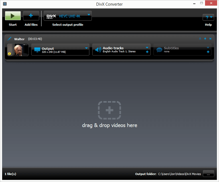

  30. Hello everybody!
    AVTech .avc files can easily be converted in program Free DivX video converter http://www.divx.com/en/software/converter/features
    Output Formats: AVI, DIVX, H264, HEVC, MKV, and MP4Image
