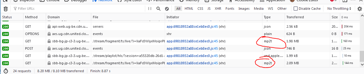

  1. I've made this thread a few months ago. Curiously, I've decided to look at yt-dlp's source code, and it seems that workflow for extracting video material out of every website supported is written as a python script.
    I have knowledge of programming languages such as C and C++, but not python, however it's not that hard to understand certain pieces of code by searching the internet so i might be able to modify one of the scripts in order to use it with the service I want to use. Now does anyone in here know a service that works the similar way.
    Basically it divides every stream into 4 second 1,45/2 MB clips in h264 format. All of these could be found on the network page. Fragments
    [Attachment 66135 - Click to enlarge]
    I've also uploaded a sample. It doesn't have a file extension but it works with mp4
    also here are some link samples:
    https://sbb-bg-pd-s3-2.ug-be.cdn.united.cloud/stream/fragment/ts/live/?i=CEH3Ip_P65ILJ...21&player=m3u8
    https://sbb-bg-pd-s3-1.ug-be.cdn.united.cloud/stream/fragment/ts/live/?i=FikQwYiIOw0-o...11&player=m3u8

    you should do some reading up on hls or on adapative bitrate streaming.
    i assume you are trying to download all the fragment files and join them as one, right?
    the file that you should be looking at is the manifest file, normally with the extension m3u8.
    it is in your screenshot "/stream/playlist/hls/?....."
    this file contains the information about all the fragmented files (or if its live streaming it will contain the information on the next couple of fragments)
    the fragmented file links have an expiry, so get a fresh link to the playlist/manifest file and put it into yt-dlp or any m3u8 downloader

    it does work, and it outputs the exact thing put into it, now how do i automate it
  11. Didn't even have to modify it. It works with FFmpeg.
