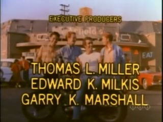

    Dear People :
    How do you make a sample ?
    I have a picture that depicts what the video looks like ,
    I would like to sharpen , get rid of the fuzzyness(word?), get rid of vhs tape sound and sound quality problems.
    John

    Here is a sample: (Below)
    That video is ultra compressed, and nothing can really be done with it.
    That's clearly
    - directly from a TV channel (probably NOT a VHS tape! hint: no timing wiggles),
    - recorded compressed to a DVD recorder many years ago,
    - later ripped,
    - then compressed further to the format of that 10+ years ago era, XviD or even FLV,
    - then repacked in (or reencoded to) an MKV years later
    The entire life of that file has been compressed garbage that will look and sound terrible viewed any larger than a phone, maybe 13" CRT.
    I hate to be the bearer of bad news, but that's it.
    PlutoTV supposedly streams Happy Days S7-11, so look into that.

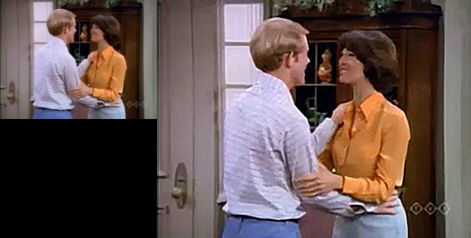

  7. I agree. It's not worth the trouble given how easy that show is to get. But here's an example with AviSynth:
    [Attachment 65925 - Click to enlarge]

    Thats no too bad really as i look with 20/100 eyes. I can't get the show on my laptop. They say its coming soon for Windows but isn't out yet. Can I take the compression out (decompress it)? what would I use? can you send a avisynth script that does this (as in the example)? John
  9. I play around with the script a bit since then but it was something like this:
    LWLibavVideoSource("Happy Days S07e01 Shotgun Wedding-sample.mkv")
    Crop(0,0,-2,-0)
    UnSharpMask(1.0, 1.0)
    Santiag(1,1)
    SMDegrain(tr=2, thSAD=500, refinemotion=true, contrasharp=false, PreFilter=3, mode=0, truemotion=true, plane=4, chroma=false)
    nnedi3_rpow2(2, cshift="Spline36Resize")
    aWarpSharp2(depth=10)
    CAS(0.5)
    My UnSharpMask() function can be found here:
    https://forum.videohelp.com/threads/401173-Repair-bad-de-interlacing-on-a-progressive-...eo#post2656284

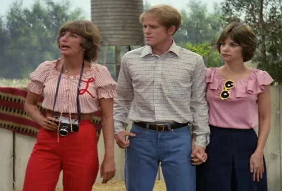

  27. I am pretty sure the Happy Days also got released on DVD, transferred from the master tapes
    [Attachment 66053 - Click to enlarge]
    and i was right, here's a screencap i have found online. not the best quality image encoding but still miles better than the version op sent
  28. Video Restorer lordsmurf's Avatar
    No.
    S7-S11 is not released. At least not in North America.
    Are you aware of S7-S11 releases elsewhere?
  29. You're right, those might be bootlegs. Now i'm confused about that image, it might be from earlier seasons maybe, idk never watched older american shows
