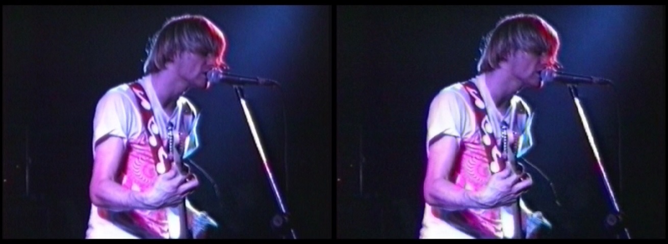

  1. Hello guys, I have a problem to remove this artifact that I believe is halo, correct? I tried in every way all possible combinations, Alpha_dehalo, FineDeHalo etc.. and nothing works, at most it's a small decrease, has anyone gone through this and have a solution?
    Thanks.
    [Attachment 65280 - Click to enlarge]
    [Attachment 65283 - Click to enlarge]

  4. For the negative ghost try:
    Overlay(last, last, x=14, opacity=0.03)
  5. Nice catch jagabo !

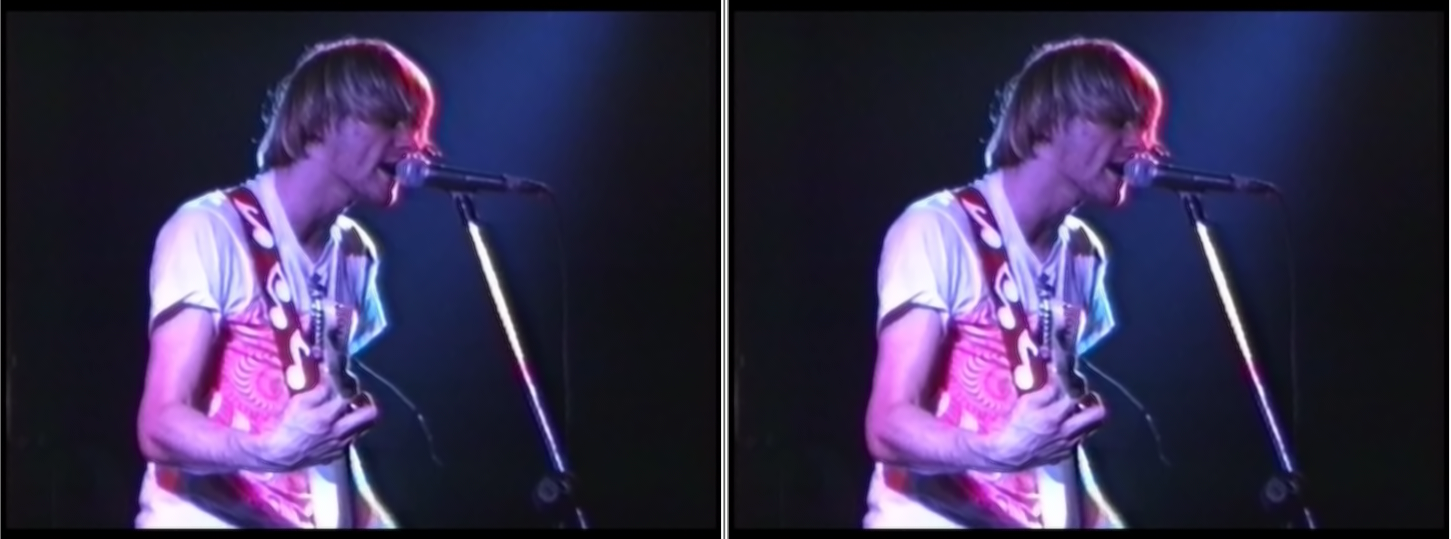

    before:
    after:
    I used VapourSynth with
    clip = havsfunc.Overlay(base=clip, overlay=clip, x=14, opacity=0.03, planes=[0])
    which should do the same as jagabo AviSynth call, aside that I only overlayed the luma channel.
    Cu Selur

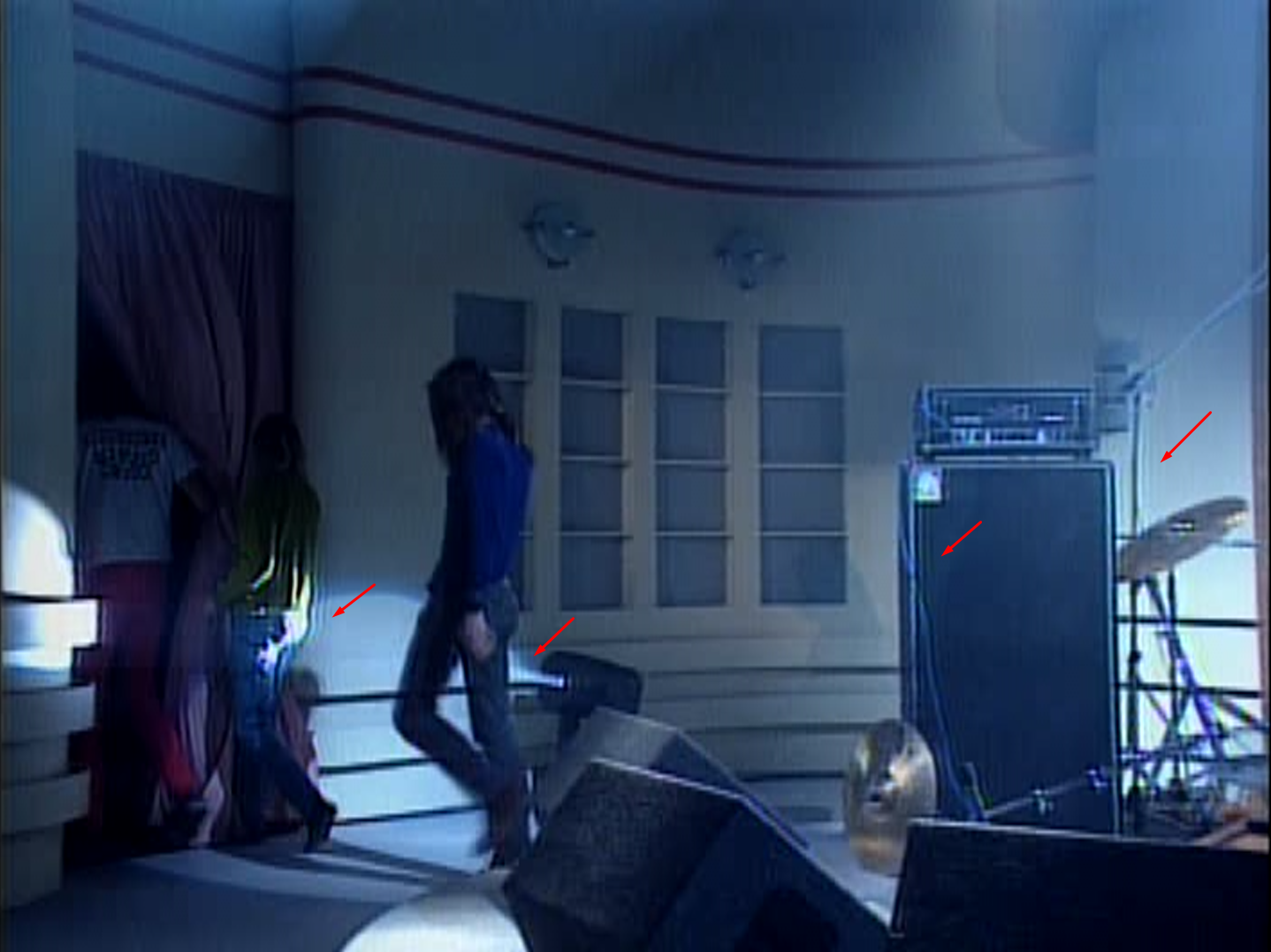

  13. Just to be sure:
    (used DPIR denoise strength 15 for clean-up of the general noise&co)
    What are you refering to when you write 'these lines' the lines at A or B?
    Or other lines? Best make a PNG screenshot and mark what you mean.
    Cu Selur

  15. Originally Posted by Selur View Post
    Just to be sure:
    Cu Selur
    [Attachment 65305 - Click to enlarge]
    Ok thanks, and here some examples.

  18. The overlay trick will not work with those. But DeHalo_Alpha even at default settings should lessen the intensity of these.
    Problem is to remove the halo while keeping general sharpness, so masking+dehalo might be a good approach.

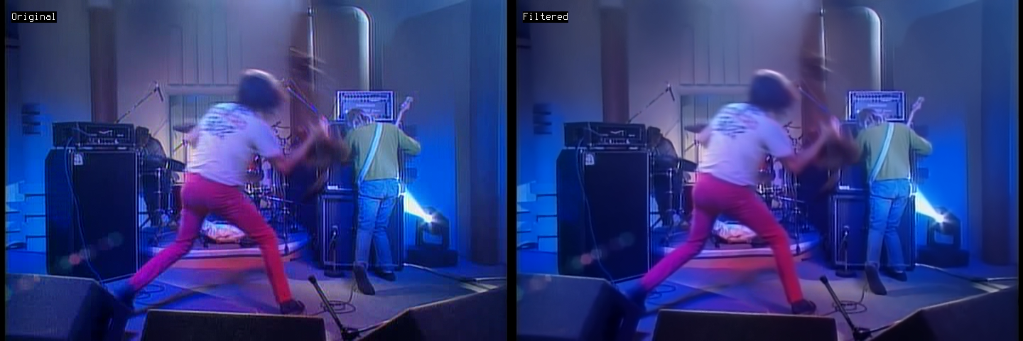

  24. try: YAHR and MCTemporalDenoise
    # denoising using MCTemporalDenoise
    clip = havsfunc.MCTemporalDenoise(i=clip, settings="very high", ncpu=1)
    # applying dehalo using YAHR
    clip = havsfunc.YAHR(clip, blur=10, depth=48)
    and try tweaking the settings of both YAHR and MCTemporalDenoise.
    Here also a screenshot of DPIR+YAHR:
    (not that much of a difference)
    Cu Selur
    Ps.: mainly adjusting the blur and depth value of YAHR should help with these halos, but remember to also check the other scenes. Strong dehalo can really mess with stuff.

  27. Ok thanks a lot, i change to blur 1 on YAHR, and apparently the other scenes are also much better..
    [Attachment 65314 - Click to enlarge]
