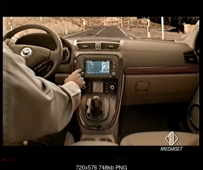

    Most of my analog recordings are from Y/C signal of a dvb-s set-up box, and, except for low resolution and occasional mpeg2 artifacts, are quite clean.
    One of my recording is from a terrestrial antenna, thus analog broadcast, and suffers from a ghost problem (a light copy of the picture shifted on the right, 2 echoes). Typical problem of not optimal TV reception of that time.
    I tried GhostBuster AviSYnth plugin and Exorcist VirtualDub plugin without success.
    Any alternative idea on how to reduce the problem?

  7. Originally Posted by lollo View Post
    This is from a VHS recording of an analog OTA broadcast? That would make the ghosting the result of multipath reception? And on top of that you have VHS halos?
  8. Captures & Restoration lollo's Avatar
    Jul 2018
    Italy
    Yes to all your questions.
    n addition to the deghost available filters I was also experimenting a denoise+mask, but no success so far

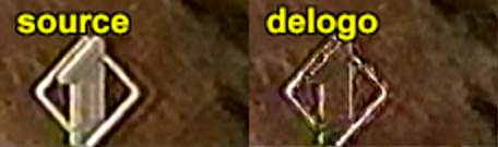

  9. Video Damager VoodooFX's Avatar
    Oct 2021
    At Doom9
    I don't think that you can remove such ghosting, but I think that InpaintDelogo can remove such ghosting around the logo.
    How long is your recording with this logo?

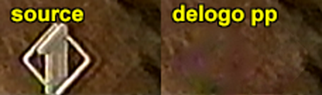

  12. Video Damager VoodooFX's Avatar
    Oct 2021
    At Doom9
    Actually is a 2 hours movie not available in any other form (except in private recordings from TV), I just sampled a commercial in between.
    Rough examples, looks like ghost is gone:
  13. Captures & Restoration lollo's Avatar
    Jul 2018
    Italy
    Originally Posted by Gelinox View Post
    I hope for you that the rendering exceeds the speed of 2.5 fps, otherwise you will not have the final version before Christmas.
    Or it would be a shame if Avisynth crashes before it's finished.
    Can you fix this ghosting problem with your NLE? If so, please send me the details. Thanks in advance
    Thanks. From now, you have one more InpaintDelogo fan. (And a BananaDeinterlacer fan as well )

  16. Originally Posted by VoodooFX View Post
    In theory they can be removed. But here the brights are blown out and the darks are crushed leading to other problems. Here's the same frame as in the first post with the nearest ghost removed with AviSynth:
    [Attachment 65150 - Click to enlarge]

  18. Originally Posted by lollo View Post
    Yes. The capture settings (input levels and procamp) was optimized for tapes recorded from a dvb-s set top box, and not from terrestrial antenna, having larger excursion. But for this excercise I only care about the ghosting removal
    I meant there are additional problems with the ghost removal. When you subtract the ghost of the logo you end up having to subtract more than "normal" because those brights are artificially low (clamped at Y=255 when they should have been higher). But that means you subtract too much from other parts of the image. You can see that the ghost is removed pretty well from the logo, but there is too much reduction of the bright poles at the top of the frame -- creating dark ghosts where previously there were light ghosts.
    Of course, one could special case the over-strong ghost reduction in the logo area and use a more appropriate strength for the rest of the frame. But when other parts of the picture are blown out those areas won't get full ghost reduction.

  29. Originally Posted by lollo View Post
    What setting did you use for the first echo removal? What about the second echo place more pixels on the right
    This is a toned down removal for both ghosts. I used these settings as they are fairly good for the middle tones of the video. You'll need stronger settings for the logo (increase the opacity and the ColorYUV values):
    LWLibavVideoSource("ghosting.avi", cache=false, prefer_hw=2)
    ConvertToYV24() # YV24 so we have pixel accuracy
    src = last
    dh = dehalo_alpha(rx=3.5, ry=1, brightstr=1.2, darkstr=1.2)
    # double the width so we have half pixel accuracy, both the original frame and the deghosting frame
    inv = dh.BilinearResize(dh.width*2, height).Invert()
    last = last.BilinearResize(width*2, height)
    Overlay(last, inv, x=17, mode="blend", opacity=0.06).ColorYUV(gain_y=34, off_y=-17) # reduce stronger near ghost
    Overlay(last, inv, x=69, mode="blend", opacity=0.02).ColorYUV(gain_y=10, off_y=-5) # reduce weaker far ghost
    Spline36Resize(src.width, src.height) # back to the original size
    MergeChroma(src) # put the original chroma back
    There's also a negative ghost about about 12 pixels (at the original frame size) to the right which isn't addressed here. And you need to protect the left edge where there's no image data to unblend.
