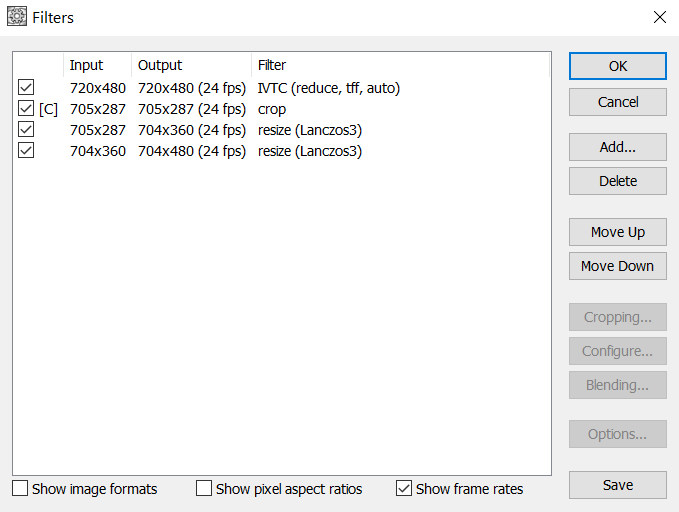

    Great, thank you for the instructions! Here's my filter chain:
    [Attachment 65203 - Click to enlarge]
    A few questions:
    1. I cropped to 705x287 because when I chose 704x288 a tiny bit of the picture information was cut. Will that mess up the aspect ratio?
    2. Was I right to use Lanczos3 to re-size or should I use a different setting?
    3. When cropping should I use YCbCr "Precise" or "Fast"?
    4. For the re-size to 704x480, I can only get it to that size if I set "Aspect Ratio" to "Disabled" - is that the correct method or is there something else I should be doing?
    5. I'd like to add some filters for cleaning up the video (Dot crawl filter and frequency suppressor of the noise). Where should I place them in the filter chain?
    6. If I wanted to produce the video without any letterbox bars and make it 16:9, how would I go about doing that and maintaining the correct AR?

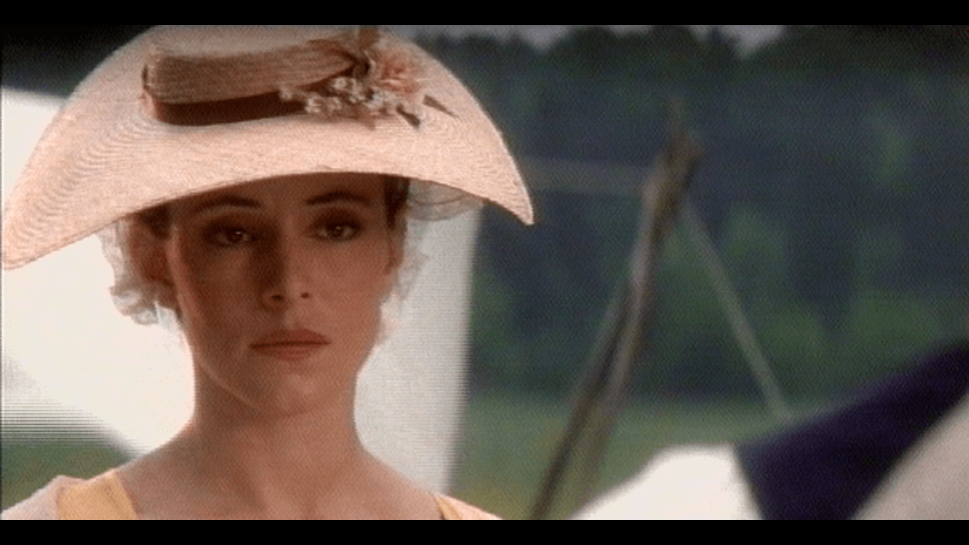

    Here's a screenshot with the settings you suggested:
    [Attachment 65204 - Click to enlarge]

  14. Originally Posted by dave_van_damme View Post
    I just did a quick crop when I came up with 704x288. Whether your 287 lines is closer to correct or not will not make much of a difference in the final aspect ratio, less than 1/2 a percent, not worth worrying about. Another possible issue is the chroma subsampling. Generally, YUV 4:2:2 video (what you have) should be cropped by even values at the left edge. YUV 4:2:0 should be cropped by even values at the left top edges. Otherwise you will get a little blurring of the colors. That's not probably not an issue here since the video isn't very sharp to begin with.
    Your source isn't very sharp so Lanczos3 is probably fine. It's the sharpest of the resizers in VirtualDub and will produce oversharpening halos at very sharp edges -- especially at the boundary between the active picture and black borders. And it will increase noise the most.
    You can prevent the edge halos by cropping away all of the black borders, resizing, then upscaling and adding borders. So crop to ~704x286, then upscale to ~704x382 and add borders to 704x480. The last two can be done in one Resize filter in VirtualDub. This will also purify the black borders which are a bit noisy in your source (noise eats up bitrate, pure unchanging black doesn't).
    How did I come up with the 704x382 upscale? You can do the math, or you can do it experimentally:
    crop to 704x360 # standard 4:3 to 16:9 conversion
    resize to 704x480 # standard 4:3 to 16:9 conversion
    use the crop filter to find size of the active picture (~704x382)
    You now know that when you upscale the fully cropped video the picture needs to be 704x382 before adding black borders. This means the top and bottom black borders will be 49 lines high. When you make a DVD you will get slightly off colors at the boundary between the picture and borders (from the YV12 subsampling). So in practice you may want to upscale to 704x380 (50 lines of black top and bottom) or 704x384 (48 lines of black top and bottom) to prevent that.
    Given everything else you're doing the difference in speed will be minimal. So there's no reason not to use precise.
    That is the correct procedure. We are intentionally changing the aspect ratio to convert from 4:3 to 16:9.
    I haven't used either of those in VirtualDub so I don't know for sure. But usually dot crawl filters work best on the original interlaced video. So you probably want that at the start (before IVTC). Noise reducers usually work better with progressive frames and before scaling. So I would use:
    dot crawl reduction
    IVTC
    crop to 704x286
    general color correction
    general noise reduction filters
    resize to 704x382 and add borders to 704x480
    DVD only supports 4:3 and 16:9 aspect ratios. So it's not possible to fit an entire 2.35:1 frame without any black bars. Unless you crop the width or distort the picture. Cropping would give a picture something like:
    [Attachment 65215 - Click to enlarge]
    The dark part of the image is what would be cropped if you crop equal amount from both sides. Ie, the full image is the 2.35:1 frame, the bright part is a 16:9 portion of that frame.

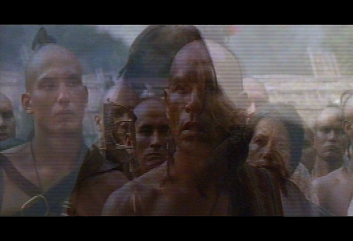

    This produced a 23.976fps video (attached), however, there are some interlace artifacts. I assumed with the IVTC that this wouldn't happen?
    [Attachment 65245 - Click to enlarge]

  22. Originally Posted by dave_van_damme View Post
    I made the attached demo using the settings you suggested:
    IVTC (reduce frame rate, TFF)
    crop to 704x286
    resize to 704x382
    The IVTC is failing in many places. It looks like the subtitles are confusing it (the subs were overlaid after the film was telecined and have a different cadence). I confirmed this with the earlier video sample.
    If you have a perfect capture (no drop or inserted frames) you can use the IVTC filters's manual setting rather than the adaptive setting. With your sample clip an offset of 3 works perfectly (occasionally the subs will be combed). If there are breaks in the telecine pattern you will have to work in segments. That's OK if there's only a few breaks in the movie but it will be a lot of work if there are dozens or hundreds.
    Another possible trick is to first apply the Deinterlace filter with Yadif + Keep Top Field... then add the IVTC filter. This basically uses Yadif to remove the combing then IVTC to decimate. I tried this with the earlier sample and it got rid of the combing but the video was a little jerky (imperfect decimation). I should point out that this is not the preferred method of performing an IVTC but in a case like this you may need it.
