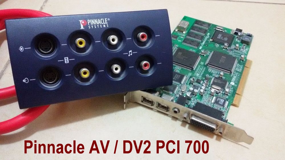

    I have this one Image
    [Attachment 64538 - Click to enlarge]
    But i need someone to tell me a capture card, that makes 1080 x 720 and 60 frames per second, a good one, that has super video, RCA and firewire / DV inputs.

    You can't capture S-Video (the S stands for "separate" not "super") or composite ("RCA") to greater than their inherent discrete vertical and temporal resolution without "upscaling" (molesting) the original signal.
    Your Brazilian PAL-M sources are 525-line @ ~30 fps (29.97) with approximately 480 active lines. Standard capture resolution is 720x480. Professional capture solutions allow 720x486 which grabs a few more vertical lines, including those outside the "active" area (containing data such as North American "line 21" closed captions).
    There may be good reasons to use a different capture card than your Pinnacle 700, but resolution is not one of them.

  7. I guess the point that has to be made explicitly: a more "powerful" connection like component vs composite, or a more "powerful" box that converts composite to HDMI will not turn VHS video into HD. Capture what you have at the best quality you can, then you can convert it to whatever format you need. In case of capturing VHS off your D-VHS VCR, SVideo seems to be the best option.
    I personally think that it is pointless to convert VHS to HD, but YouTube does not enable 60 fps for videos that have fewer than 720 lines, also HD videos are allotted higher bitrate, so upscaling SD to HD is the necessary evil when uploading to YouTube. But you don't have to do it for your own home use and preservation. Instead you may opt to high-quality lossless or visually lossless SD capture, and spend bitrate not onto extra pixels that contain no extra information, but on achieving fewer artefacts.

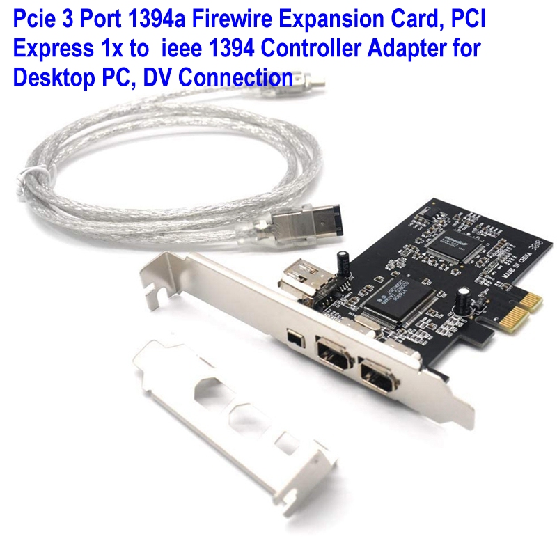

    Yes, there are still relatively inexpensive Firewire-only cards available for desktop PCs.
    In the past, I have recommended the SYBA SY-PEX30016 3 Port IEEE 1394 Firewire PCIe x1 card, which has 2x 1394B ports and 1x 1394A and a TI XIO2213B Chipset. It is supposed to be able to accept input from many legacy data sources that use Firewire for output.

    [Attachment 64771 - Click to enlarge]
    I'm going to buy this card, it's a little expensive to get to the Amazon in Brazil, but I have to test another card to see if my D-vhs is still alive outputting the i-link

    It will be difficult to get Windows 7 or 10 driver for your Pinnacle AV / DV2 PCI 700 assuming that the capture card is still functional. Only analog video playback with composite/RCA output need a capture card. This analog capture is hard to find now. Analog video tapes are going to be obsolete once there is no working device to playback. All mini DV handycams have analog input and it's a hussle free capture card.
