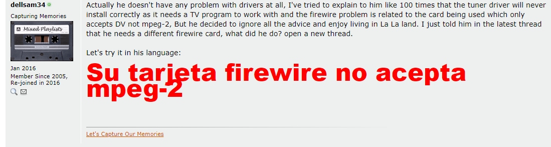

    I don't know what's your IQ level as this does not seem to be a language barrier but rather stubbornness/dumbness, Let me repeat this 10 more times since this is turning into comedy:
    The drivers are working for DV, The card is a DV card only, No mpeg-2, no data. The error is for TV tuner part, not for the streaming part.

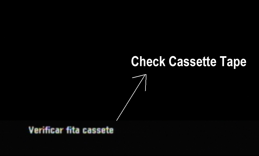

    Anyway. I think I made some progress, I tested something else, the LG DVD recorder, maybe it was the first victim of the killer DV to DV cable.
    Before the computer, I forgot to mention, the LG DVD recorder was when i first plugged in the D-vhs and there was this message on the DV screen: ''No camera connected, check cables.''
    Well today I asked an electronics technician to change the DV input plug of this LG Recorder. I plugged the D-VHS back into it and voila!! This appeared on the screen. ''Check Cassette Tape''.

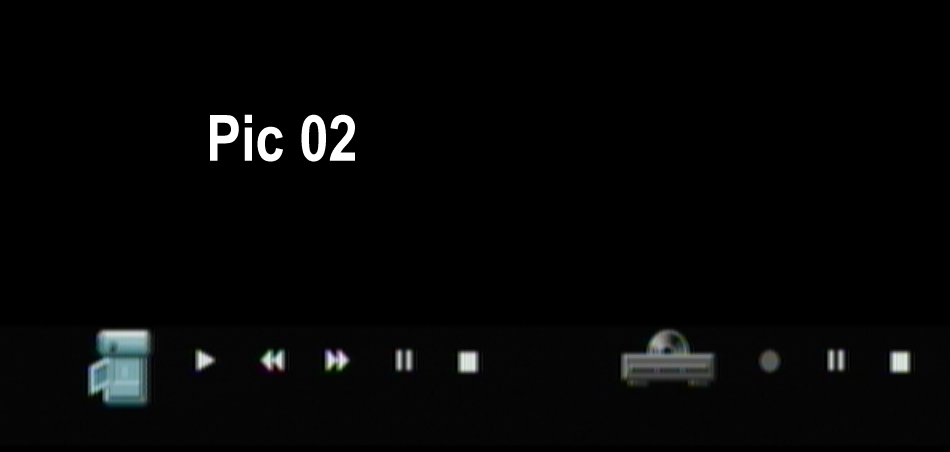

    And with the tape running, this appears (Pic 02) (But no video and no sound).
    Another thing, when I take the DV plug out of the D-vhs output, it is very hot. This is not normal right?

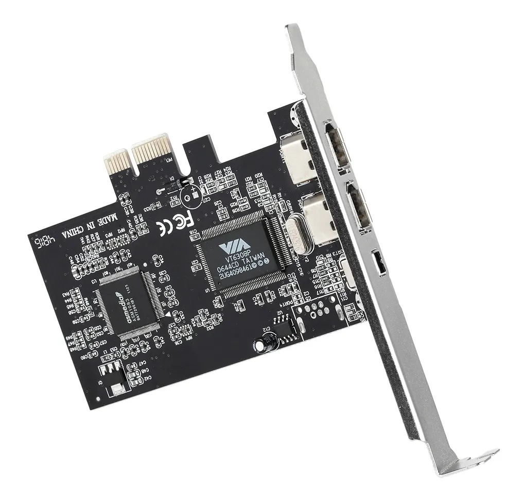

    Is that a good one? Image
    [Attachment 64743 - Click to enlarge]
    It says (I translated from portuguese)
    The 1394b expansion board is designed based on the IEEE 1394b standard and in line with the IEEE 1394-1995 and IEEE 1394a-2000 standards.
    The transmission speed can be up to 800Mbps, but also compatible with 400/200/100Mbps devices.
    Works with many types of 1394b and 1394a devices, including DV camcorders, digital camera and other audio and video devices.
    Supports bidirectional transmission, fully interoperable with FireWire, iLink and SB1394, implementation of the IEEE 1394 standard.
    Plug and play, hot swap. Support Windows 8/7 / Vista / XP / 2000 / ME / 98SE / Server 2003-2008 32/64 bit, for Mac.

  18. Member Cornucopia's Avatar
    Remember: one of the prime methods of good AV troubleshooting is to swap out the questionable links in the chain with known-good equivalents. Always do this one-at-a-time, so you can isolate the part's influence and response. Otherwise, you might not truly know which change was instrumental.

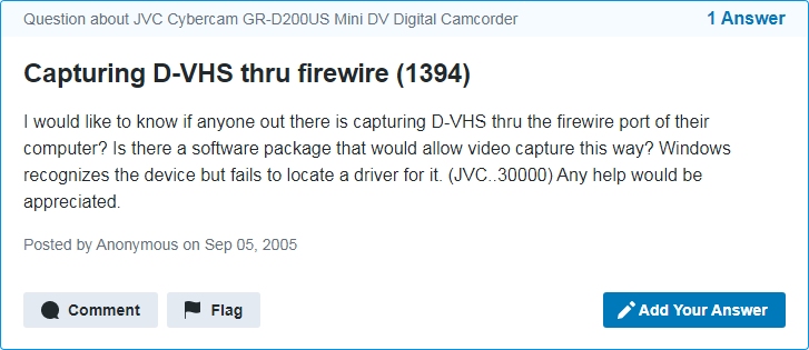

    According to this guy, who asked this in 2005, I don't think I'll be successful in buying this 1394 Firewire Card.
    Looks like he had the same problem I have.
    [Attachment 65135 - Click to enlarge]
    https://www.fixya.com/support/t97389-capturing_d_vhs_thru_firewire_1394
