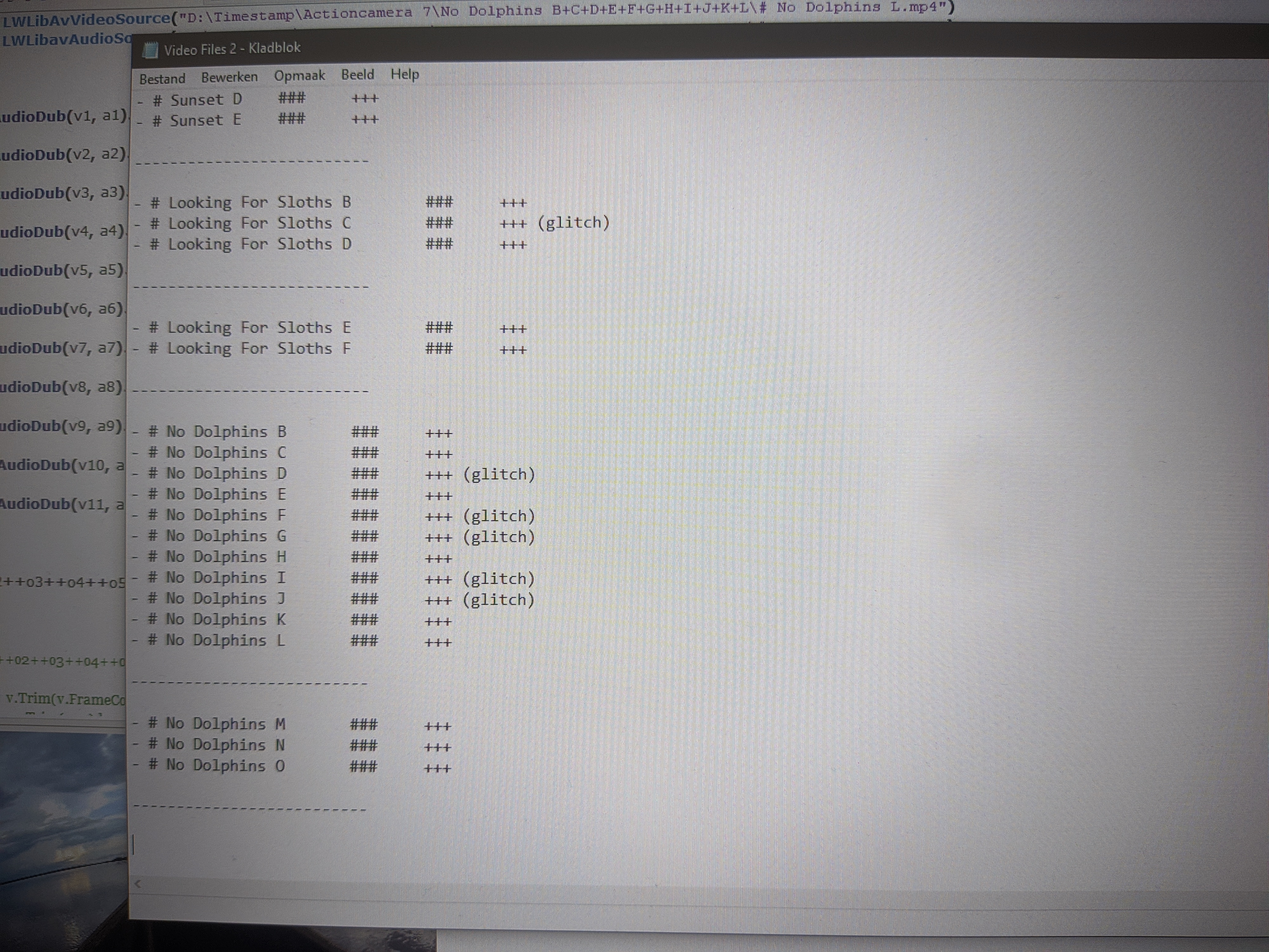

    - I've opened the script in the first tab. And opened the corresponding video's in the right order in extra tabs, calling them v1, v2, v3 etc.
    - I've looked for places where to take the transitions and put that info in the script in the first tab in the corresponding output. So v1 to o1, v2 to o2 etc.

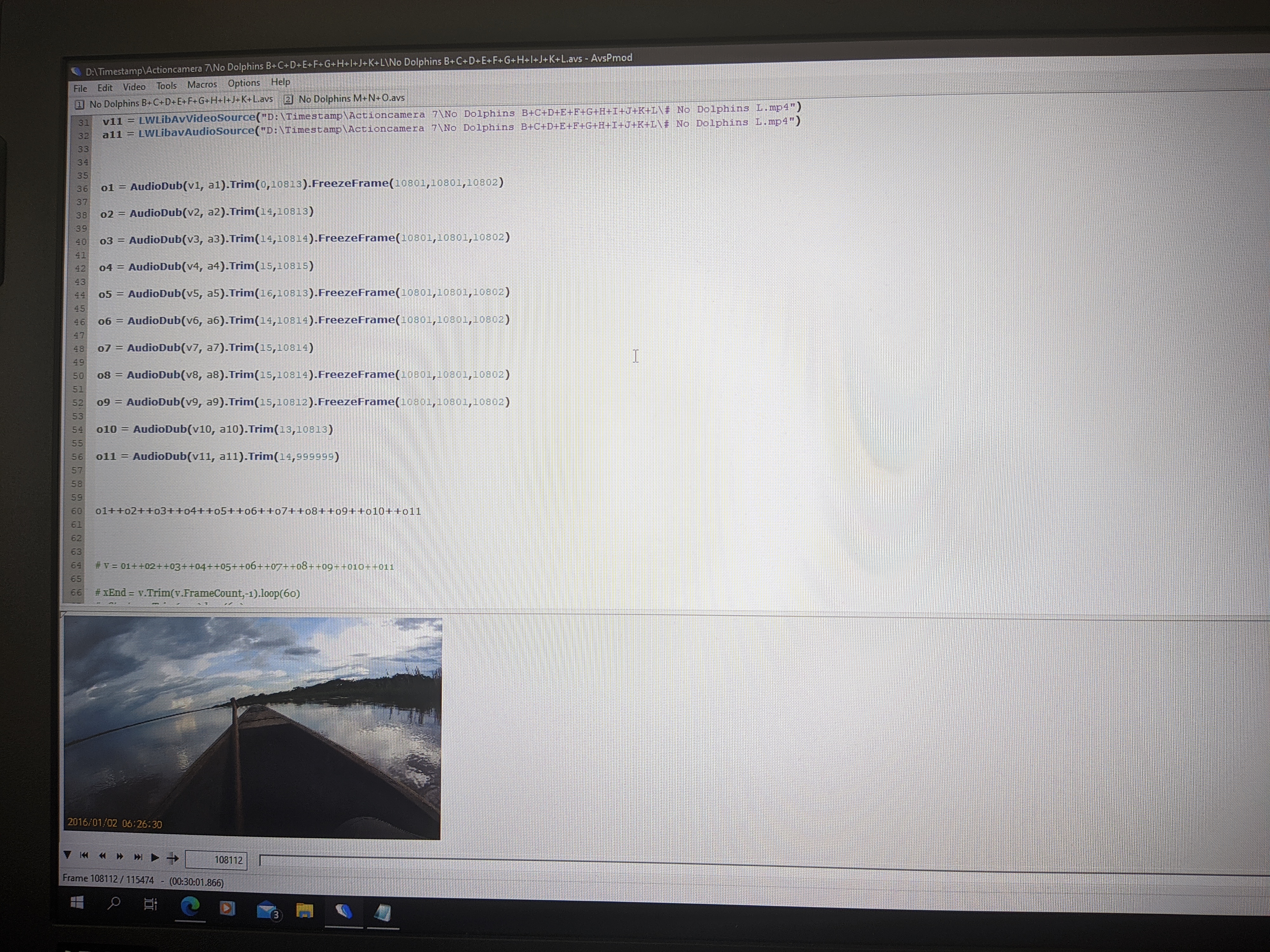

    - And looked if and where there were glitches of the loop recording cuts. If they were, they always occured at frame 10801 (easy!). So I believe I've replaced glitching frame 10801 with frame 10802 all the time.
    (I'm on my way to work now, so I quickly made some foto's)
    [Attachment 65350 - Click to enlarge]
    [Attachment 65353 - Click to enlarge]

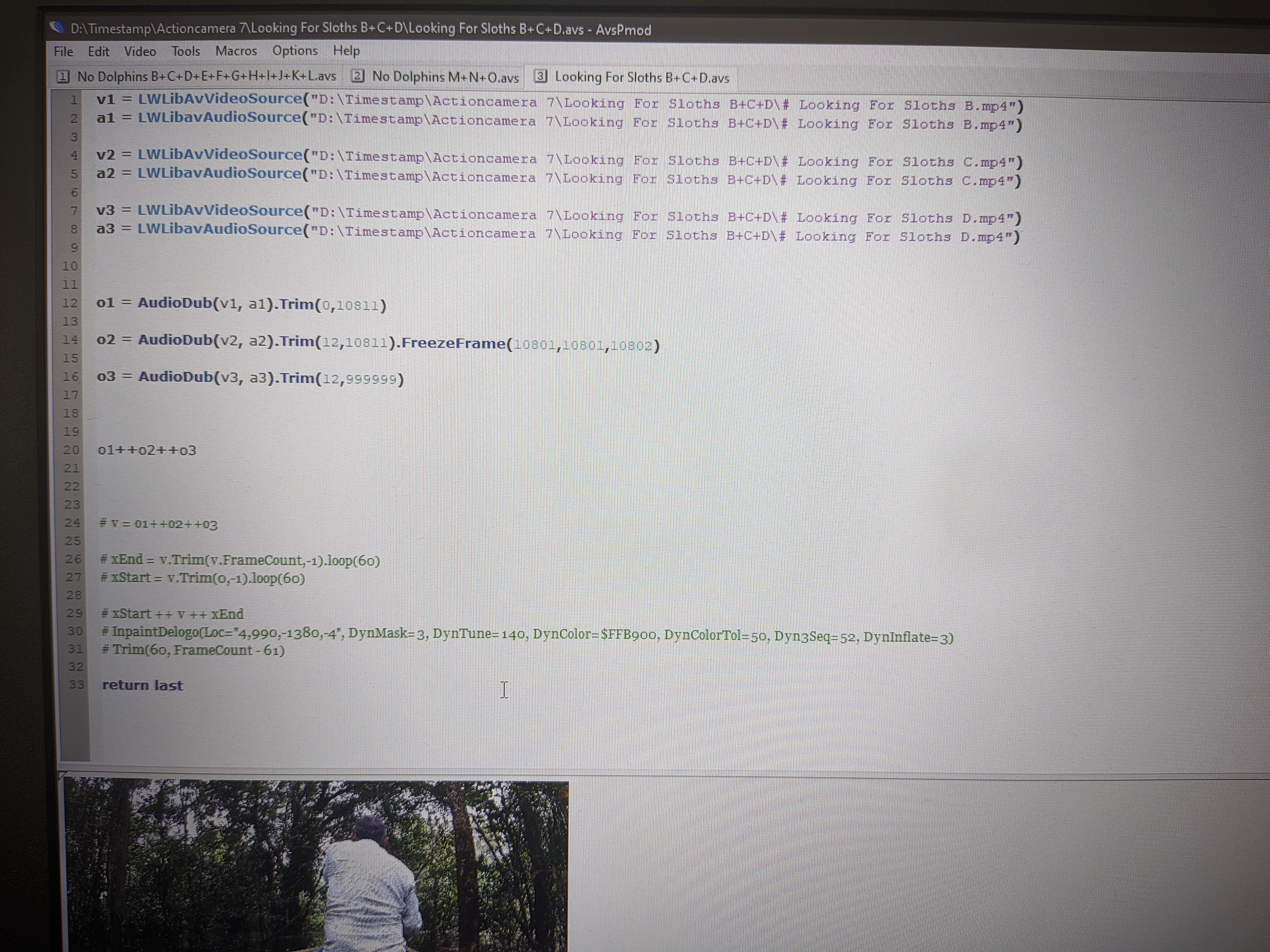

    But now on my final check (on the playback screen in the script tab) before "exporting" it seems that the transitions look fine and exactly how and where I've put them. But the replaced frames where the glitches were seem to be still there and visible in playback in the script screen.
    Only the first clip where a replacement frame is set, seems to be correct and duplicated. Then I see 1 duplicated frame. But in the following positions I still notice glitches.
    [Attachment 65351 - Click to enlarge]
  2. seems to me like
    ".Trim(10856,999999).FreezeFrame(10801, 10801, 10802)" (and similar)
    is wrong, it should be
    ".FreezeFrame(10801, 10801, 10802).Trim(10856,999999)"
    like VoodooFX wrote a few times,....

  5. Video Damager VoodooFX's Avatar
    Oct 2021
    At Doom9
    Originally Posted by Rockel83 View Post
    Oh, excuse me. Thought it didn't made anny difference as long it's on the same line.
    It doesn't make difference as long as you understand what you are doing.
    Trim() changes timeline, if you take frame numbers from original timeline then they may not fit a changed timeline.
    Let's say if you cut off first 100 frames [Trim(100, 0)], so 150th frame from original timeline is 50th after your trim is done, you've to take that into account when using filters after Trim.

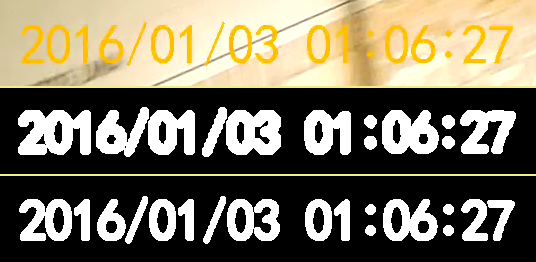

    Here is InpaintDelogo with perfected mask for your videos to achieve higher quality de-timestamp:
    InpaintDelogo(Loc="4,990,-1380,-4", DynMask=3, DynTune="140 - 200", DynColor=$FFB900, DynColorTol=65, DynInflate=2, Dyn3Seq=52)
    It needs latest InpaintDelogo v2.17, where I added option for a ranged luma mask.

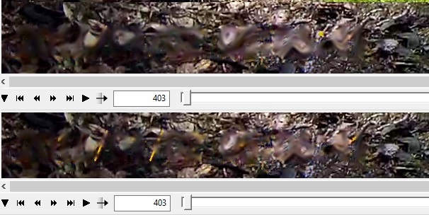

    Previous mask vs New mask [at bottom] comparison:

    btw, I think the old mask gives me a slightly better coverup in some video's. Especially when there's a lot of detail in the background like, leaves in the jungle.
    There the new mask seems to have some problems with the dashes there, while the old mask covers everything op besides a single small point of a ":".
    Could be, I tested only on your videos you've shared, bump DynInflate to 3 then, mask will be a lil bigger to cover everything but still should be better than old one:
    InpaintDelogo(Loc="4,990,-1380,-4", DynMask=3, DynTune="140 - 200", DynColor=$FFB900, DynColorTol=65, DynInflate=3, Dyn3Seq=52
    Could be, I tested only on your videos you've shared, bump DynInflate to 3 then, mask will be a lil bigger to cover everything but still better than old one:
    Cool, going to try that!
    The new old one is more obvious yes.
    Edit:

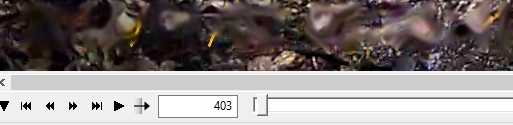

    Can't remove it, even not with DynInflate to the max. of 4
    [Attachment 65371 - Click to enlarge]

  23. The worst part of using such close masking is that you can still read the timestamp (or logo or subtitle or whatever it is you're trying to hide).

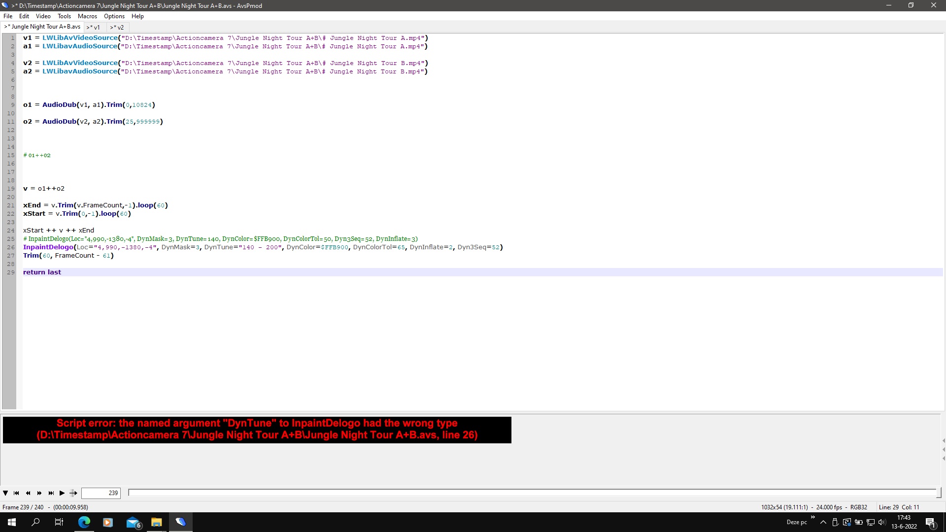

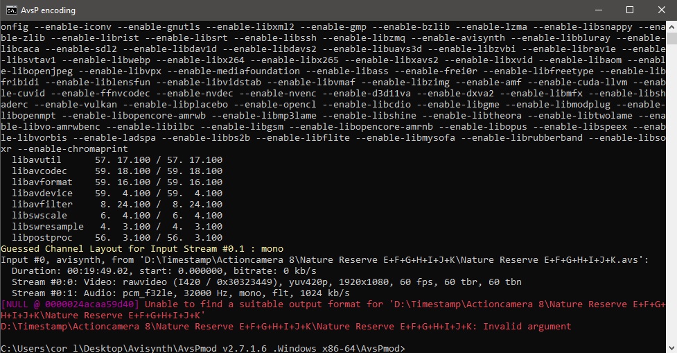

    I'm getting this error when I try to export it:
    [Attachment 65373 - Click to enlarge]
  25. You need to provide an extension for the output filename.
  26. Member Rockel83's Avatar
    Apr 2022
    Holland
    Oops...

    The worst part of using such close masking is that you can still read the timestamp.
    You can't, closer the mask less things to "read" there.
