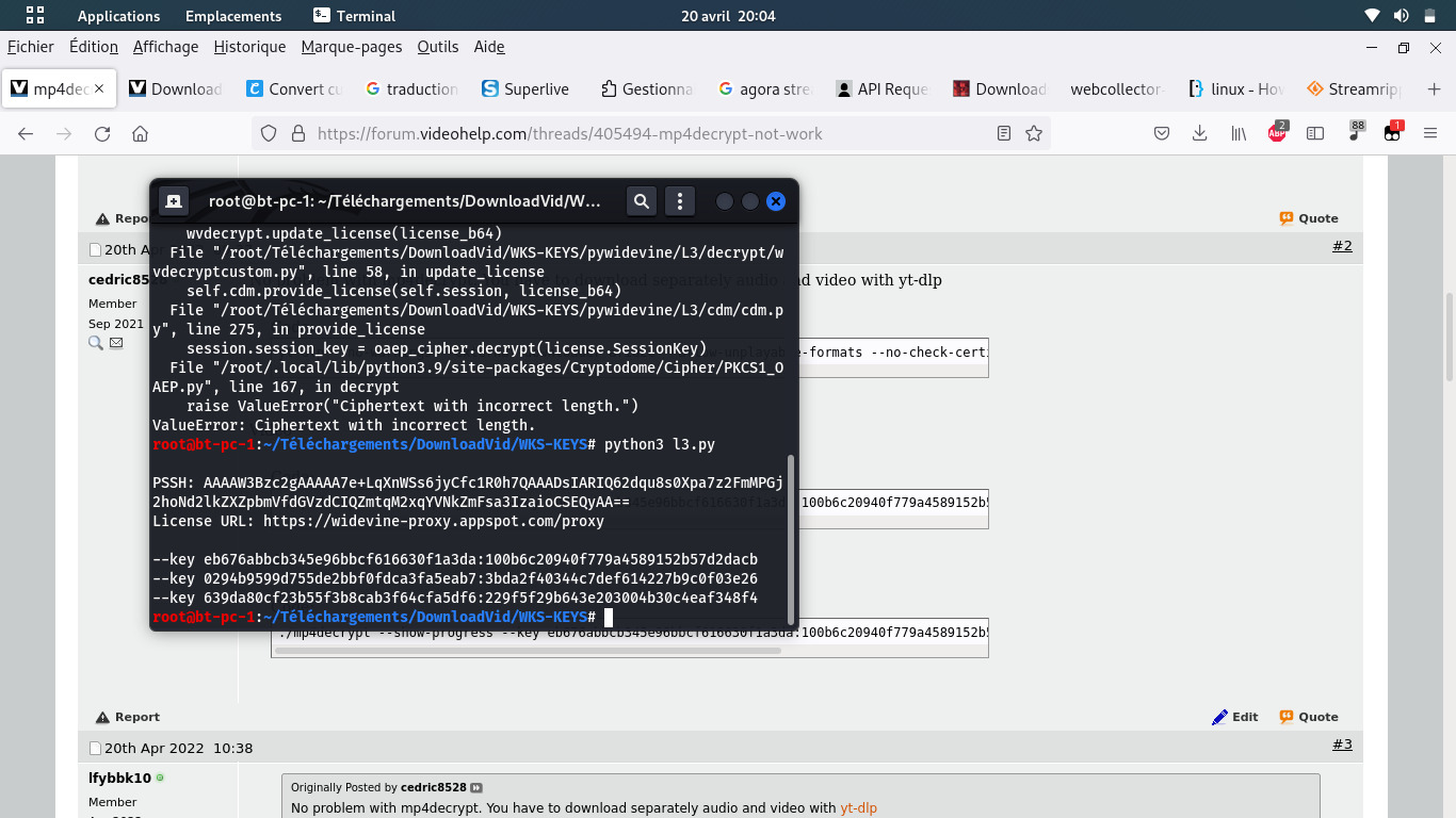

  8. Image
    [Attachment 64437 - Click to enlarge]
    try the other keys
    --key eb676abbcb345e96bbcf616630f1a3da:100b6c20940f779a4589152b57d2dacb
    --key 0294b9599d755de2bbf0fdca3fa5eab7:3bda2f40344c7def614227b9c0f03e26
    --key 639da80cf23b55f3b8cab3f64cfa5df6:229f5f29b643e203004b30c4eaf348f4
  9. Originally Posted by cedric8528 View Post
    try the other keys
    Doesn't work again. Everything is successfully decrypted for you, did I understand correctly?

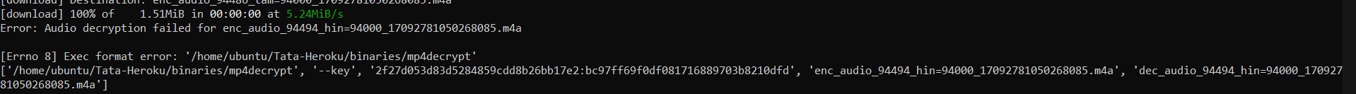

  25. So I have a vps and i uploaded mp4decrypt file on github and cloned it from there , my vps image is ubuntu , and i am trying to use mp4decypt but it keeps giving error herre is my command
    /home/ubuntu/Tata-Heroku/binaries/mp4decrypt --key 2f27d053d83d5284859cdd8b26bb17e2:bc97ff69f0df08171 6889703b8210dfd enc_audio_94494_hin=94000_17091486763231273.m4a dec_audio_94494_hin=94000_17091486763231273.m4a
    and error i am getting is
    -bash: /home/ubuntu/Tata-Heroku/binaries/mp4decrypt: cannot execute binary file: Exec format error

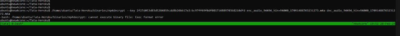

  26. Originally Posted by ShadowYt77 View Post
    Try this one
    click click2
    If I/my posts ever helped you, and you want to give back, send me a private message!
  27. Image
    [Attachment 77365 - Click to enlarge]
    Same error , i dont know why its happening but when i run same program in github codespace it runs , but its not running on my vps
    also when i run command manually on my vps i get this
    ubuntu@new4core:~/Tata-Heroku$ /home/ubuntu/Tata-Heroku/binaries/mp4decrypt --key 2f27d053d83d5284859cdd8b26bb17e2:bc97ff69f0df08171 6889703b8210dfd enc_audio_94494_hin=94000_17092784567446609.m4a dec_audio_94494_hin=94000_17092784567446609.m4a

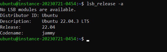

  28. So please state which architecture you VPS is running on; can you show us the output of
    lsb_release -a
  29. Check I Have Uploaded Image
  30. Any Solutions???
