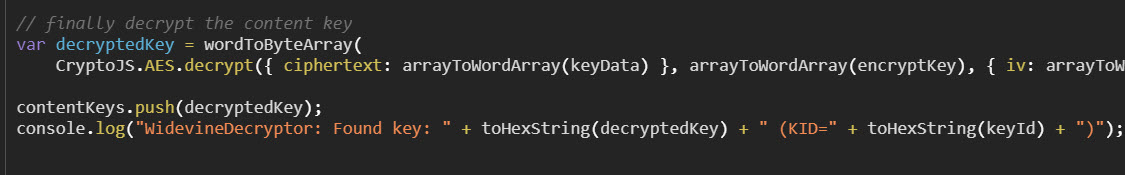

  13. I've managed to see DRM protected video keys with well known chrome extension. But don't know what to do next? How to download the protected video after finding keys (at least I think so)
    It shows like this:
    [Attachment 57207 - Click to enlarge]
    I think it's done through ffmpeg but I don't have any experience or knowledge about this issue except I a few days ago learned about youtube-dl and I used it in non protected videos.
    Please could you explain what to do next after finding these keys one by one.

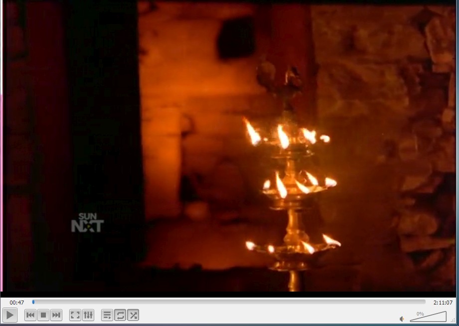

    I can decrypt alright but, what alternatives are there for a mpd that doesn't even playback properly in stream tests?
    Eg: This one plays the first few seconds alright after which the visual goes bonkers!
    https://m-storagellnw-j2apps.s.llnwi.net/content/fb0b6da51b614f407ea255a6f3bb6b2a/dash...4_baseline.mpd
    Source: https://www.mxplayer.in/movie/watch-nagamandala-movie-online-c05763d1d66e94398dfc96b6c1c3ef11?
    Things tried that didn't help are:
    yt-dlp - (using the switch --allow-unplayable-formats grabs the encrypted av streams, but decrypting them gives the same result as in stream tests),
    drm-Dash-stream-downloader - (ModuleNotFoundError: No module named 'requests'),
    streamlink - (streamlink no plugin can handle url),
    wvdumper - (MediaDrmBridge creation failed).

    Still the same result, after 5 seconds. I'm now convinced that something is wrong at my end rather the mpd itself.
    I used the kid = a5482a952e7b5a21882b3050ca6e5845 and your key = eb6300f86e0d493bad2314487e120b0d
