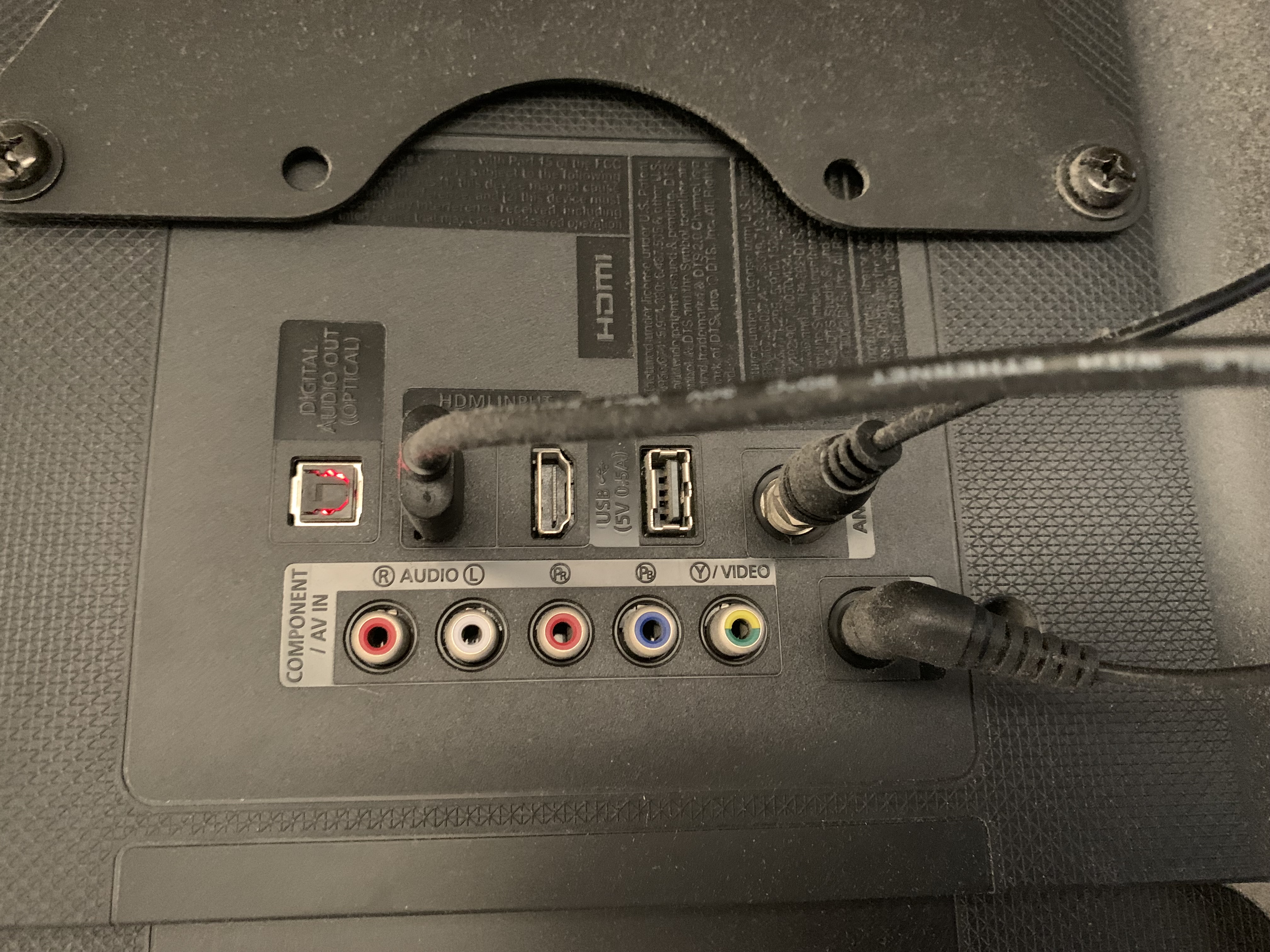

    Hey guys, I wish to record only the audio playing in a TV show. What would I need for both hardware and software to record the audio clips in the tv show please? This is only a one time thing so I would not want expensive hardware and software options, thx.

    You need search terms to look for. Your TV outputs digital optical audio via a connector known as TOSLINK. You may want to convert it to digital coaxial for your receiver, to USB audio for your computer or active speaker, or to good old analog audio to use pretty much anywhere. I am surprised I could not immediately find TOSLINK to HDMI audio converter.

    I wonder where you are going to connect it to.

    I am thinking dual RCA from the TV's Audio OUT to the pc's Mic IN?

    I don't see dual RCA out on your TV.
    Dec 2005
    Shucks, you're correct, the AUDIO connectors are IN's not OUT so this tv not having an audio OUT is the problem? Or rather I see what you mean now that only OUT is a Digital OUT.
  9. Member Cornucopia's Avatar
    nope, that is audio in to tv, not out. (whoops, beat me during my typing)
    only option is spdif/toslink. which isn't the cheapest, and may be copy-protected.

  14. Member Cornucopia's Avatar
    Most Samsungs, and I would venture to say most modern TVs, do not have headphone out, but do have optical spdif/toslink out and HDMI ARC as the audio out options.
    The adapter cable Axel mentions could work in his and similar scenarios, but it is not optimal - line in levels are much lower than headphone out levels so there is the possibility of overloading the input stage sensitivity on capture unless you can adjust the out level low enough.
