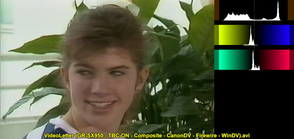

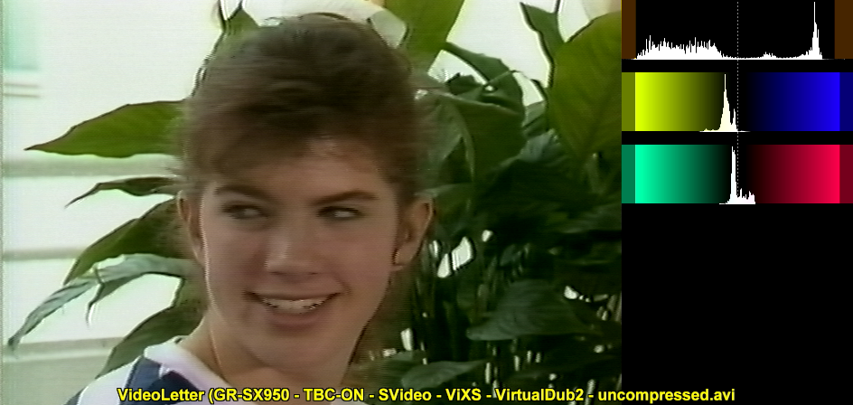

  11. I updated "JVC GR-SZ7 + KWorld" screenshot, it was not correct, I apologize.
    My own observations:
    Between ViXS, DVC100 and KWorld I like ViXS the most, KWorld the least. DVC100 produces image with sort of shimmering, kind of faint noise. KWorld has more color noise but but does not have the shimmering. ViXS is the cleanest.
    On the screenshot with an envelope DVC100 ranges [5, 255], ViXS [0,244] with sharp drop-off (there are some values close to 255, I think they are from the head switching area), KWorld [0, 246] with soft fall-off.
    The SZ7 does not have TBC, so it was interesting how different ADCs handle it. The ViXS is the best, KWorld is the worst. Maybe - just maybe - a high[er]-quality ADC can alleviate the need for line TBC? Oops, I should not have said that.
    Now, the Canon DV conversion. Frankly, I like it. Yes, it is softer, but for skin it works better. Look at the woman's face: red face with green shade. Her hand just below the sleeve - green shade again. Now thinking about it, maybe I could shift Q chroma component up and left? Trying Flaxen VHS right now (I use exclusively VirtalDub2 for this stuff, I have never been adept with Avisynth), not sure it is much better. Now look at Canon DV version, both the face and the hand are smoother in color, the skin tone is more natural, although the countertop tiles look pinkish - adding a bit of blue to high tones will help with this.
    I suppose that Canon DV version also may seem softer because there is less sharpening, the ringing at the edges is less pronounced. Oh, and no macroblocking. Comparing camcorders I worked with I would rank them as Canon, Panasonic, Sony, JVC. I never saw macroblocking with Canon, did see with JVC. It seems that DataVideo external DV converter would be a distant fifth
    Between the two camcorders, the SX950 seems to be a better VTR than the SZ7. I think that the branding on child's sleeve starts with "B" or "D", and there is "i", I can see something that looks like a dot on the "i". I don't see this dot on the SZ7 output. The SZ7 is a much better camera, though. So, shoot with the SZ7 and capture with the SX950? Sadly, the SX950 does not play Hi-Fi stereo.
    Here are DVC100, ViXS and CanonDV together in one screenshot - in this order left to right - in Vegas. Pulled them from the source window of VirtualDub2. I apologize for the sloppy levels and color correction.
    Scopes: DVC100, ViXS, CanonDV
    Scopes: DVC100, ViXS, CanonDV, adjusted, video levels
    Scopes: DVC100, ViXS, CanonDV, adjusted, computer levels

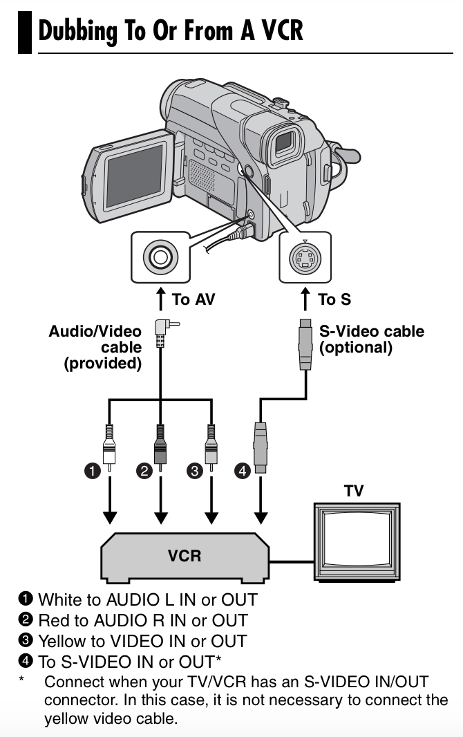

  14. Passthrough mode via JVC GR-D93U (SVideo IN, DV out). Video only. There is a TRRS jack for composite A/V, both can be used simultaneously, and the camcorder will pick SVideo for video if SVideo cable is inserted - nice!
    It took some time for Win7 64-bit to re-jiggle the drivers. Scenalyzer finally was able to find the device, but WinDV could not.

  23. Originally Posted by Brad View Post
    You copy-pasted my words, so yes, I do indeed agree with myself. Lol...
    Just checking. One can never know for sure. There are people using Canopus boxes yet blasting DV capture
    Thanks for the links with comparisons! I agree with johnmeyer, who said, "I think that several people who have been trashing the "DV codec" here in this forum only know the really crummy versions of that codec. Not all DV codecs are created equal".
    Added to this comparison the same VHS sample, digitized through AVerMedia CE310B.
