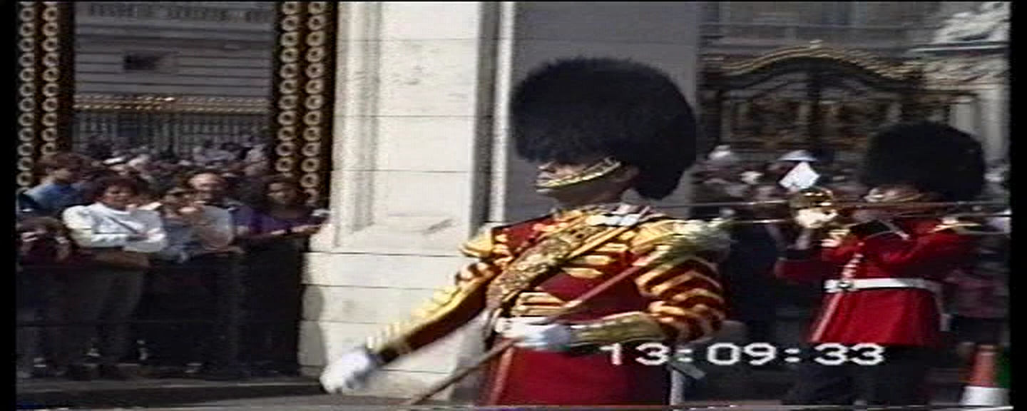

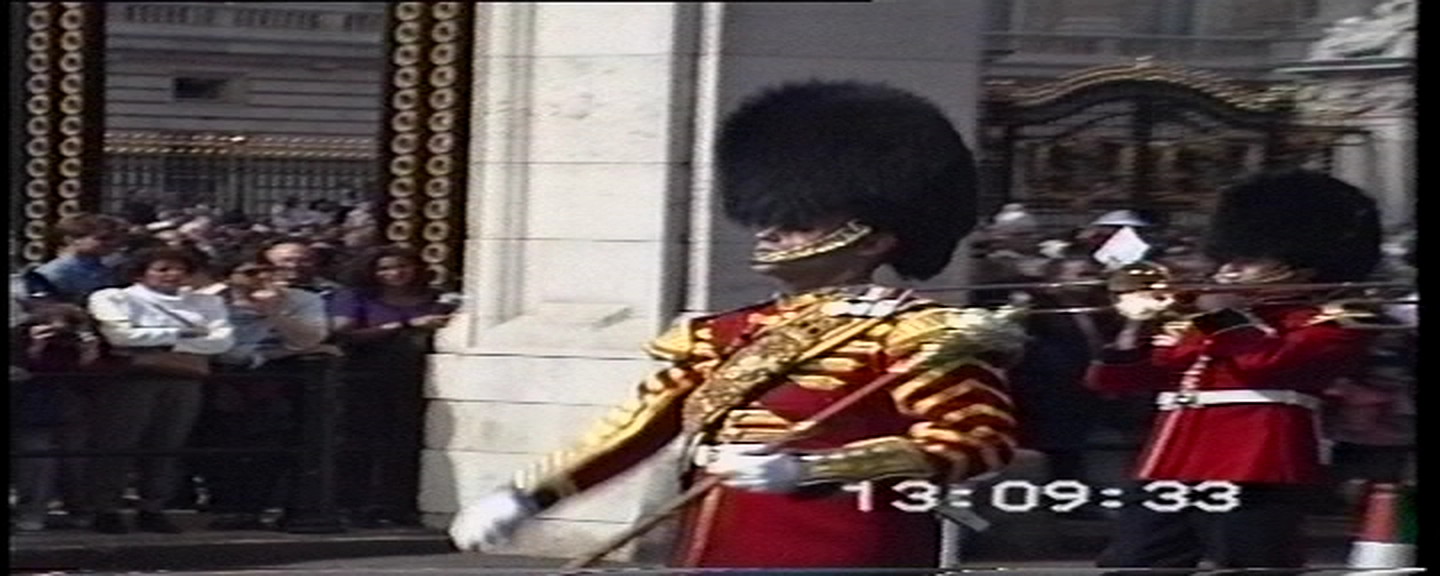

  16. Formerly 'vaporeon800' Brad's Avatar
    Apr 2001
    Vancouver, Canada
    You mentioned 2 software + 1 hardware, but I'm mildly curious to see if there are significant advantages to other DV encoders ? e.g. Maybe Mainconcept or Avid etc....
    I only have one of those, and not on this machine. Perhaps someone else can volunteer to grab the clip and encode it.
    Further inspection reveals that this clip doesn't scream "blocking" in the way I thought. I had been looking at it using point-resizing, which of course makes the hard edges of the blocks plain. With a resizer someone might actually use, the artifacts are a lot more subtle.
    Given that, should I still post each video encode? Here are screenshots with LanczosResize(width*2,height*2). I used SeparateFields rather than deinterlacing, to avoid any interplay there.
    Lossless
Name:	00 Lossless.png
    Sony DCR-TRV238E DV (hardware)
    Lossless -> Canopus DV (software)
    Lossless -> Cedocida DV (software)
Name:	01 Sony DCR-TRV238E DV.png
ID:	32098 Click image for larger version
Name:	02 Lossless - Canopus DV.png
ID:	32099 Click image for larger version
Name:	03 Lossless - Cedocida DV.png
    Lossless -> Cedocida DV -> interlaced x264 (CRF 18)
    Lossless -> interlaced x264 (CRF 18)
Name:	04 Lossless - Cedocida DV - x264 CRF 18.png
ID:	32101 Click image for larger version
Name:	05 Lossless - x264 CRF 18.png
    Encoding this to DVD specs seems to be a lost cause, unless my HCEnc settings are horrible. Or maybe it's as simple as denoising first, I dunno.
Name:	07 Lossless - MPEG-2 7276kbps bad.png

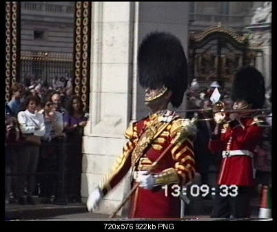

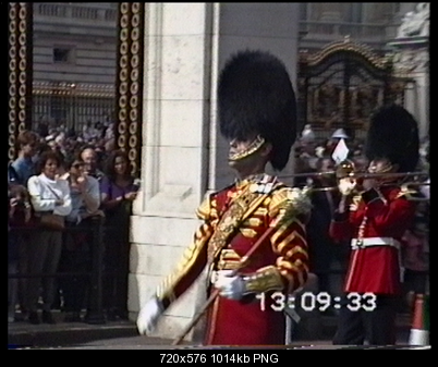

  24. Originally Posted by vaporeon800 View Post
    I had simply used the one that's smallest and most convenient for me, since no preference was specified ... Here's the Lagarith version.
    OK, that works great. Here are two links to the resulting encodes. For the first file, I used the excellent Sony DV codec that is built-into Vegas. For the second, I used the MainConcept DV codec. I kept the field order the same (upper field first). There are definitely a few minor artifacts, but if you can download the still images and zoom way in, I think you'll find that the Sony DV codec is really, really good. This is what I've been saying here for some time. I think that several people who have been trashing the "DV codec" here in this forum only know the really crummy versions of that codec. Not all DV codecs are created equal.
    Here are links to the two versions:
    Sony_Vegas_DV.avi
    MainConcept_DV.avi
    Here are snapshots of the same field (which I bobbed) from the original and then the two encodes:
    Lossless
    Sony DV
    MainConcept DV
